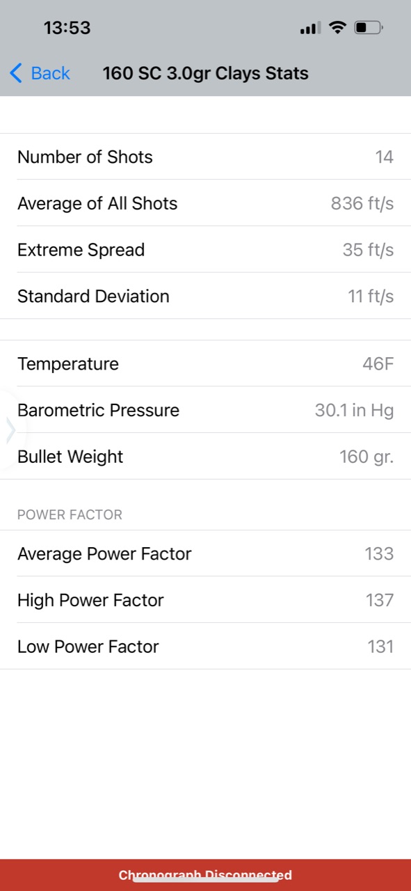

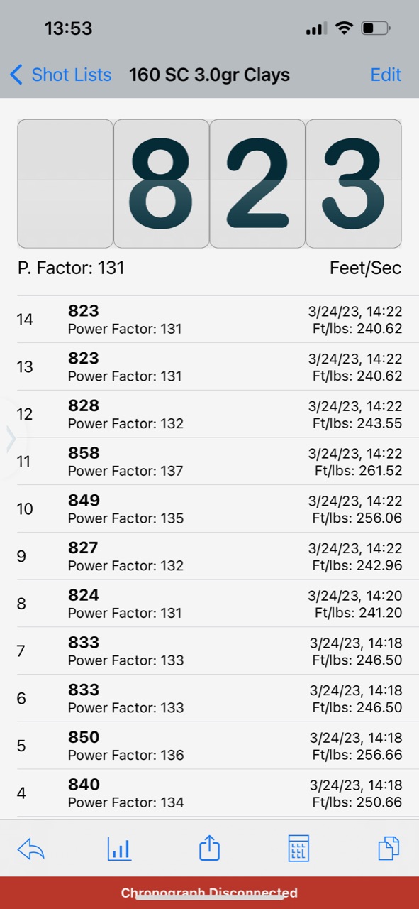

    I have a Magnetospeed V3 and the Pro Chrono Digital with Bluetooth. I use the V3 with my rifles and with handguns that have a picatinny rail. I also have the Wiser Precision Arca attachment and use it, and also use it direct mounted if necessary. It works great, and I have had no issues using with it Fat Bastard and/or Little Bastard gen3 among others. Unfortunately there are some handguns and rifles the V3 won’t work with, and I use the Pro Chrono with them. Here is a screen shot of the Pro Chrono Bluetooth app:
    If it will cover your needs the V3 works like a champ. I have the XFR dongle and download the data to my phone so it’s easy to reference. The Bluetooth on the Pro Chrono is awesome, and after having the older version I can say it is well worth the upgrade. I guess the difference being you don’t have to go down range to set up the V3, and the Pro Chrono works on my revolvers etc.
