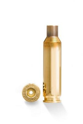

I need advice on brass. Winchester 6.5cm unprimed brass. I’m new to reloading.
ballisticguy
Dec 31, 2021
14
5
Oklahoma
I have the opportunity to purchase 250 pieces of new unprimed Winchester 6.5cm brass for $0.40 each. Would this be worth my time with the large primer pocket? I’m new to reloading and I’m still currently reading up on load data. I need to find a load for my bergara b14 HMR 24in barrel. Everyone has to start somewhere, and this is time to admit I’m new. Should I stay away from this. Would this get me started? Should wait and Find some decent SRP brass? I thought this was decent deal giving the current times, but now I’m second guessing if I should buy these.
I have all my reloading equipment, and I have to start somewhere. I have 2lbs of H4350, and I still need a starting place as to which bullet I should go with. Point me in the right direction guys. I’ll learn quick, and log data. We were all here at some point.
There's nothing wrong with large rifle primer brass. Lots of us have shot thousands upon thousands of rounds of 6.5 Creedmoor with large rifle primers for years before anyone started making SRP brass. Also, if I'm not mistaken, Winchester brass is just Hornady brass with a different stamp, or at least it used to be.
Reactions: ballisticguy
This is helpful as I’m trying to figure out if I need to back out of this sale. Like I said, I’m new to reloading. I have been saving my factory loaded hornady brass. I’ve been following this forum for a few years, and with that being said I had to finally jump in. I have to start somewhere. This is probably the worst time to get started, but it what it is.
That’s why I’m here. I need advice. I do have my factory loaded hornady cases I have been saving. Should I just stick with these until I can find new brass in stock?
If you’re fine learning on the worst then go with it. I’d prefer to learn on something I don’t have to question. Hornady isn’t something I would want either though so… do it or don’t. We can’t tell you if it’s worth your time to you. I’m saying it’s not worth my time even if it’s free.
I worded my post differently. Basically I’m just looking to get started. I typically like to start with the best. Obviously, this doesn’t sound like it’s even decent from what your implying. I would just like to get started but it’s almost impossible to find what I need, as everyone is having issues. I’m just ready to get on the range and start perfecting a load that works for my rifle. Could you please recommend what I should look for if this brass isn’t worth my time. I’ll take all the advice I can get.
Big question is, do you have large rifle primers, if it was me, I would start with the once fired brass from your rifle, get some 140 gr eldm bullets try approximately 41.5 h4350 and practice reloading while looking for Peterson or Lapua brass, it really is worth the wait and money. The brass you have will work for learning how to properly size, trim, seat bullets.
Yes. I have 1000/LRP. I purchased the RCBS RC Supreme kit for loading my 6.5cm rounds along with a case trimmer, a decent digital scale, and RCBS Match dies( a few days out). I have a Lee classic Turret Kit I’ve been loading my 9mm with so have other stuff that I didn’t mention, I just wanted a dedicated press for my 6.5cm. Thank you for the advice. I’ll get the 140’s ordered as I have seen those commonly mentioned on many threads. I’ll back out of the Winchester brass and I’ll look for those you mentioned. Thank you for the recommendations. Like I said, I’ll take all the advice I can get.
I have been loading WIN LRP cases. Using a Savage too. I have the H4350 charge way more than expected with the WIN cases to get the velos desired for 1000 yds. No bolt lift issues but need to crack the one bag of Peterson I have and start loading those.
Need to do a H2o capacity comparison.
I’d skip the Winchester.
What I would do is to take 50 of those once fired hornady cases you already have and work with just those for now.
Size em everything and then load a test series and see what happens. Then size em again and do it all over with the next test.
That way if you make a mistake in sizing you only effect a small number of them which is what I’m sensing is your main concern. It also lets you see the effects of what you are doing “long term” much sooner than when you are processing hundreds of cases in a lot.
Once you find some results that you like with that small lot I would then proceed to the full lot or to some premier lapua, alpha etc brass.
You’ll find it’s much easier to find a good load when you don’t have to question whether it was you or the load in bad brass that caused it to shoot poorly.

Alpha is quality brass. It's what I use for my Desert Tech 6.5 Creedmoor barrel. 39.36 grains of RL16 and a 140 ELDM has been fantastic for me.
