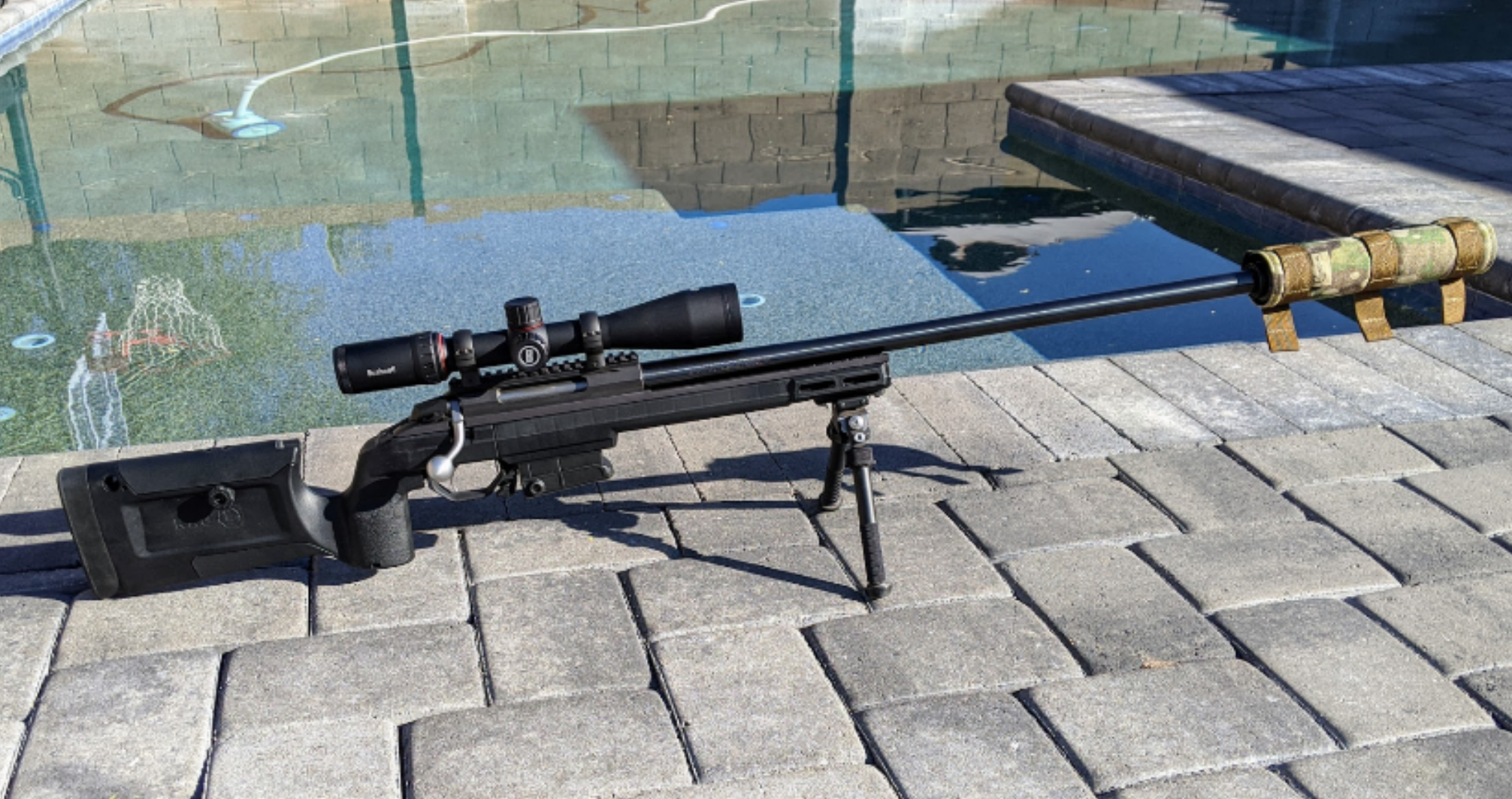

    I have a T3X CTR in 6.5cm in a KRG Bravo using AI mags. I love this gun. The Bravo isn’t the best chassis but it’s good, and this gun shoots better than it should. Last time we were out my group to confirm zero was one clean hole at 100yds, not what I expected.
    Put a YoDave trigger spring in it and enjoy the wonderous factory trigger.
    The factory stock would be good for hunting, otherwise I’d throw a chassis under it.

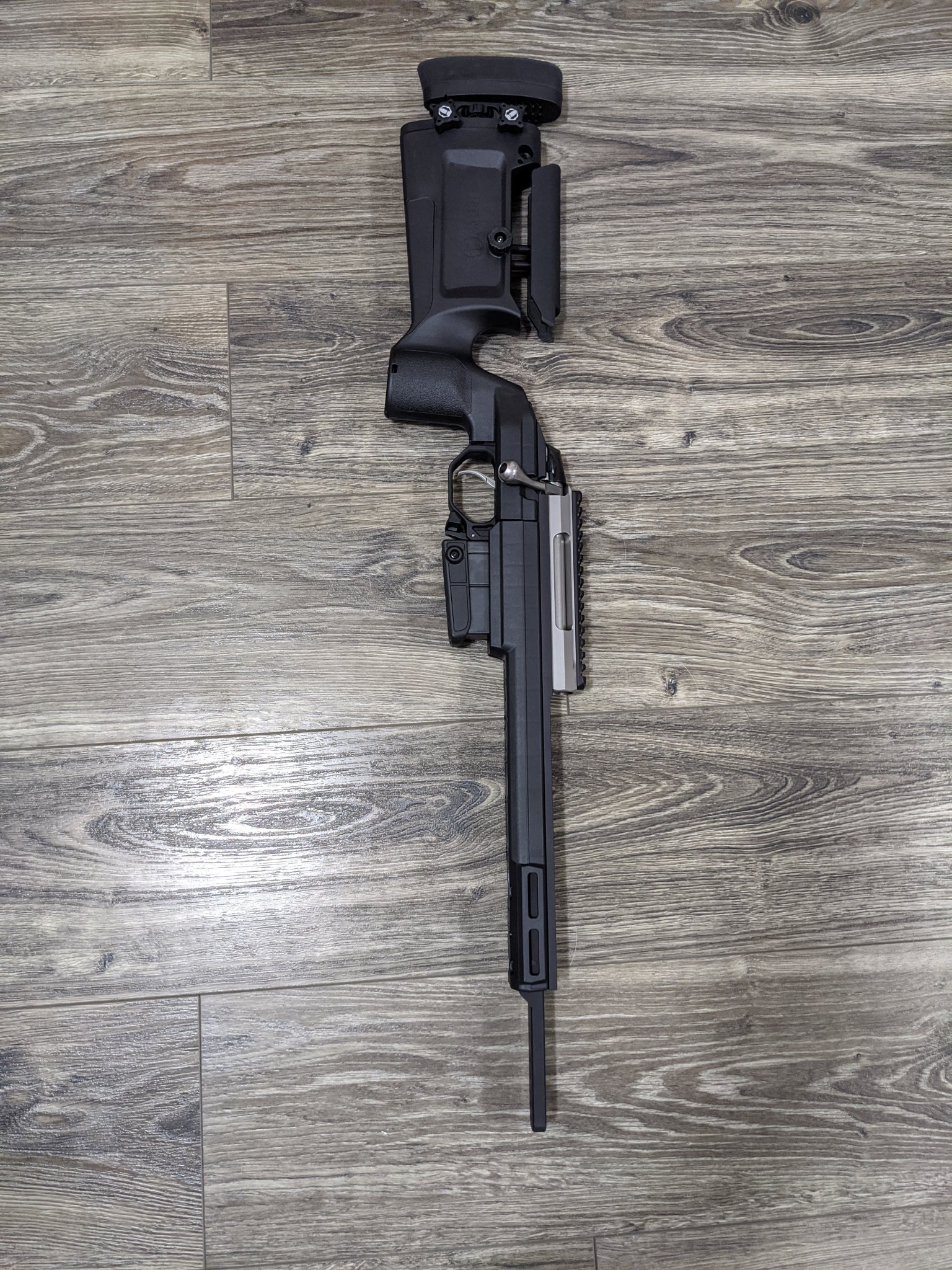

    Removing a barrel from a Tikka wasn't hard for me, I bought a SS T3X Lite before the price jump and sold the barrel/stock off of it. Ended up at $430 for the action and trigger.
    Here's what it looks like as of now.

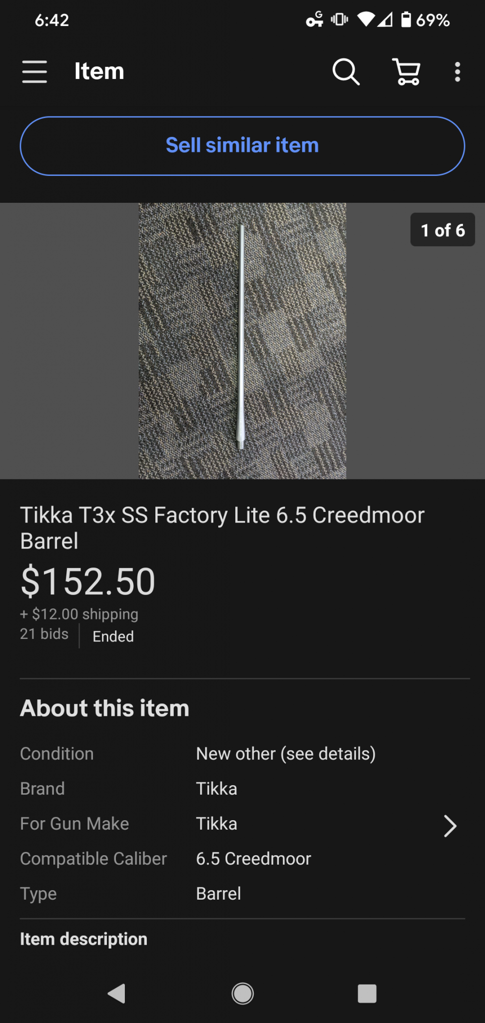

    Sold mine on eBay for $150. I had bought a 6.5 Creedmoor donor rifle specifically for selling based on popularity for the round. Mine too was stainless.
    You got lucky. Good for you. Ctr barrels don’t fetch that much usually $100-120. The lite barrels in a desirable caliber (6.5 or .308) you may get $75. A 300wm or 300wsm you would be lucky to get $50.

    I've heard horror stories about getting these factory barrels off the receiver. Did you have any trouble? Which vise and wrench did you use?
    Brownells barrel vise with aluminum #6 inserts.
    Barrel protected with several layers of drywall joint tape. Torqued the vise down HARD on barrel.
    I used a 31mm open-end wrench, with cut up beer cans as shims/protection for the action. (Got the idea from member "Crang" just be sure to use enough that the fit is tight) Slipped a 2ft cheater over the wrench. Then used a deadblow hammer while applying some pressure in the direction the action would spin.
    Straight forward and worked well.

    2 quick questions:
    Drywall joint tape - the mesh stuff or the paper?
    31mm wrench with shims? How many slices of beer can did it take? If you have to add shims, wouldn't it be better to just use an adjustable wrench? I realize actions wrenches are ~$100, but a shimmed 31mm wrench seems like a big step to save a few dollars. Maybe I'm not clearly picturing what you're describing.
    1) The paper stuff
    2) I used two different slices of can around the action before putting the wrench over it. It is kind of goofy, but I had purchased an internal action wrench (most of them are not designed for the amount of torque required to remove a factory barrel) so I didn't want to purchase an additional $100 external wrench. Plus I had access to a 31mm wrench. So it all worked out for me. You can pm me if you have more questions, and I can go into in more detail if you'd like.

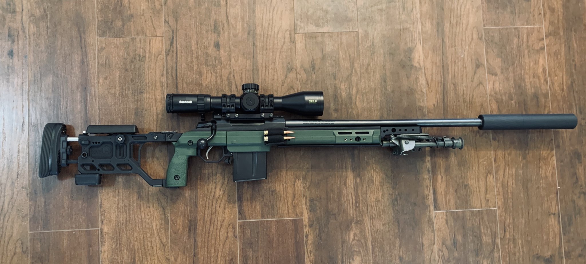

    I would go with CTR and keep or toss the stock... this is CTR with KRG Whiskey 3 chassis. Whether you stick with Tikka mag or AI both are good. From my experience you can find AI or AI style mags cheaper though so that may be consideration. I will say Tikkas shoot a little slower so depending upon application you might want to run 24” vs 20” just food for thought.
