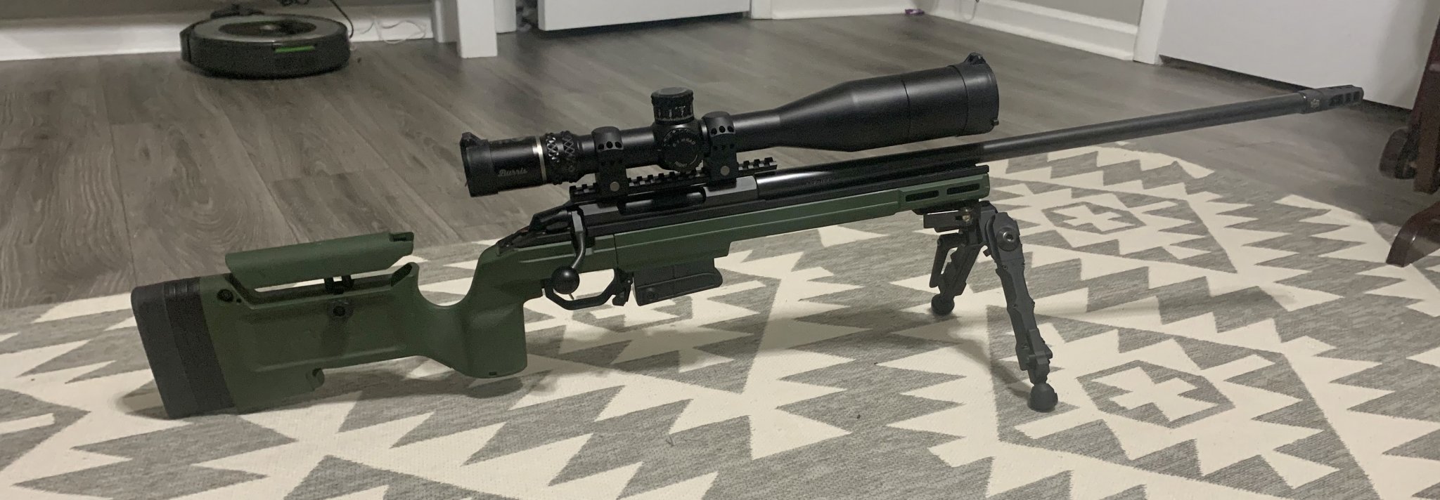

Had a tough battle between the CTR and the TAC. Ended up ordering a 24" CTR today in 6.5, since I already have good dies and loading for that caliber anyways.
Now I am torn on the mags, I ordered a 2nd mag with the rifle but cant decide if I should cancel it and run the 3 AICS mags that I already have, or just stick with the tikka mags.

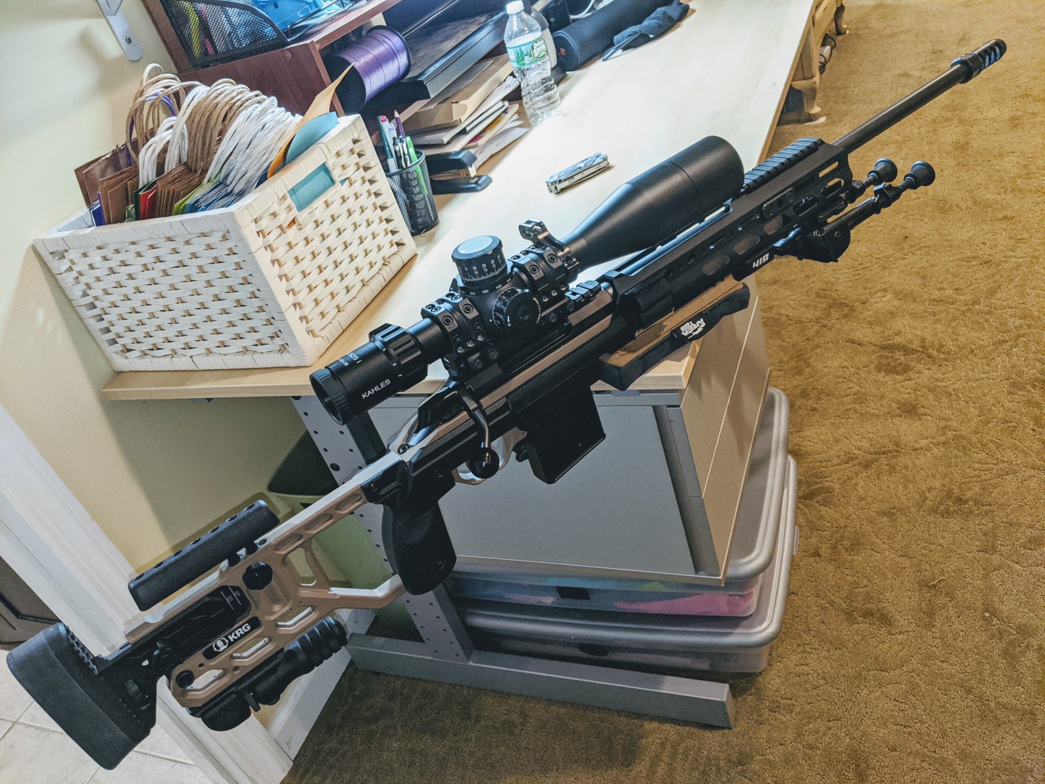

I just put a CTR 20" in a KRG bravo with the CTR mag inlet. It is far and away the nicest rifle I have ever owned.

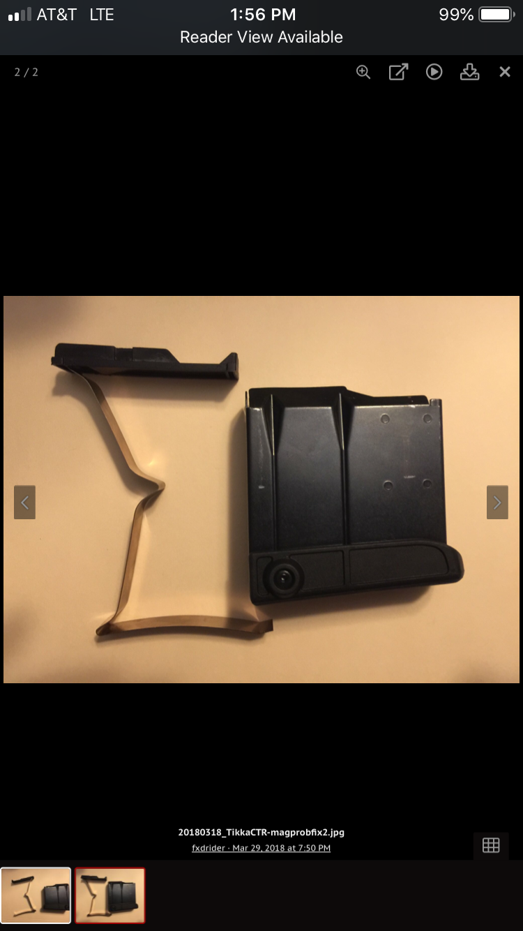

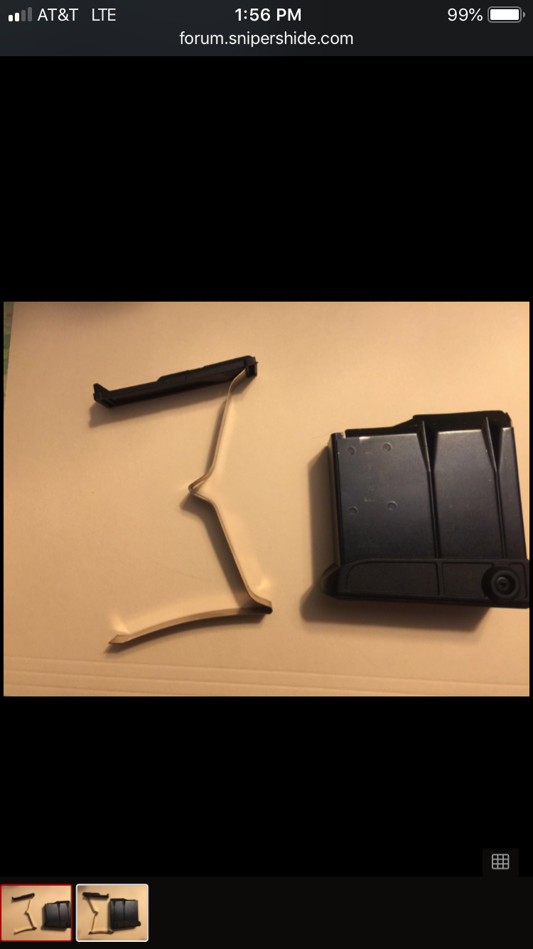

the fix is a simple spring bend. They will be 100% after that. I will post a photo here a little later that a member here posted.
Reactions: Jmccracken1214
Let’s see it
Here they are. Use needle nose pliers and make your spring look like these. Quick and easy.
View attachment 7392069View attachment 7392070
This fix works for sure. I've run a Tac A1 in PRS comps now for 3 years and haven’t had any issues with mags. I've had an issue where the stock CTR magazine wouldn't feed after being dropped in the dirt, but it got a ton of dirt/sand/grass inside. After tapping it upside down, it fed fine.

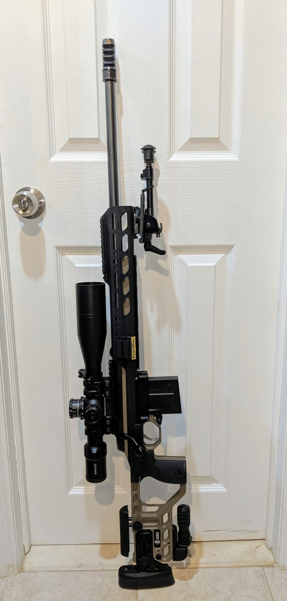

My CTR 6.5 Creed & KRG AICS
Thanks for posting this.
However, the play in the magazine is while it sits in the mag well. If I grab the mag it will wiggle just a bit (did this in the factory stock as well, was worse in that stock than the bravo). I don’t understand how the spring fix will solve the issue I am seeing. I’ll try to find the video I referenced.
Thats not a really a problem. What does it matter if they wiggle when inserted. Its not like they are maracas and rattle when moving around. AI mags wobble and rattle like hell unless they are loaded. You can bend the rim of the hole in the mag out a bit. Do it too much and the mag wont drop free. I like mine loose so they drop free so i dont bother bending my mags.
my only requirement is they feed everytime. The spring bend fixes that. Without it, what you are experiencing will happen. Try one way and if it doesn’t work then do the other.
I’m not worried about the rattle, just that it doesn’t feed 100%. What I am seeing is that the rear of the mag drops by a mm or two when it fails to feed. Wouldn’t the mag not wobbling in the well stop that? I guess I haven’t seen the thread that talks about the problem that the spring bending fixes. I am only interested in fixing it so it feeds 100%, don’t care which one does it.

Without bending the spring, my bolt would ride over the last round or two left in the mag. I found the screwdriver to bend the top of the hole in the mag trick and it didnt do shit except make my mag stick in the magwell. Bending the spring fixed the feeding issue on all my mags that were having issues. In fact I did it to the few that did feed well just to be sure. What it does is put more pressure on the follower especially towards the rear.
You have two options which both are reversible. See what works.

I don't have the thread link. Nothing in it any different than what I told you of my experiences which yours mimicks to a “T”. The follower comes out the top of the mag. You DO NOT take off the floorplate. No way to screw it up.
Sounds good, thanks for the help
No problem. You aren't do anything but opening up existing bends in the spring. You wont be making any new bends. When it looks like the pic above, you are done. If you have needle nose pliers you can have a mag done in a couple minutes.
