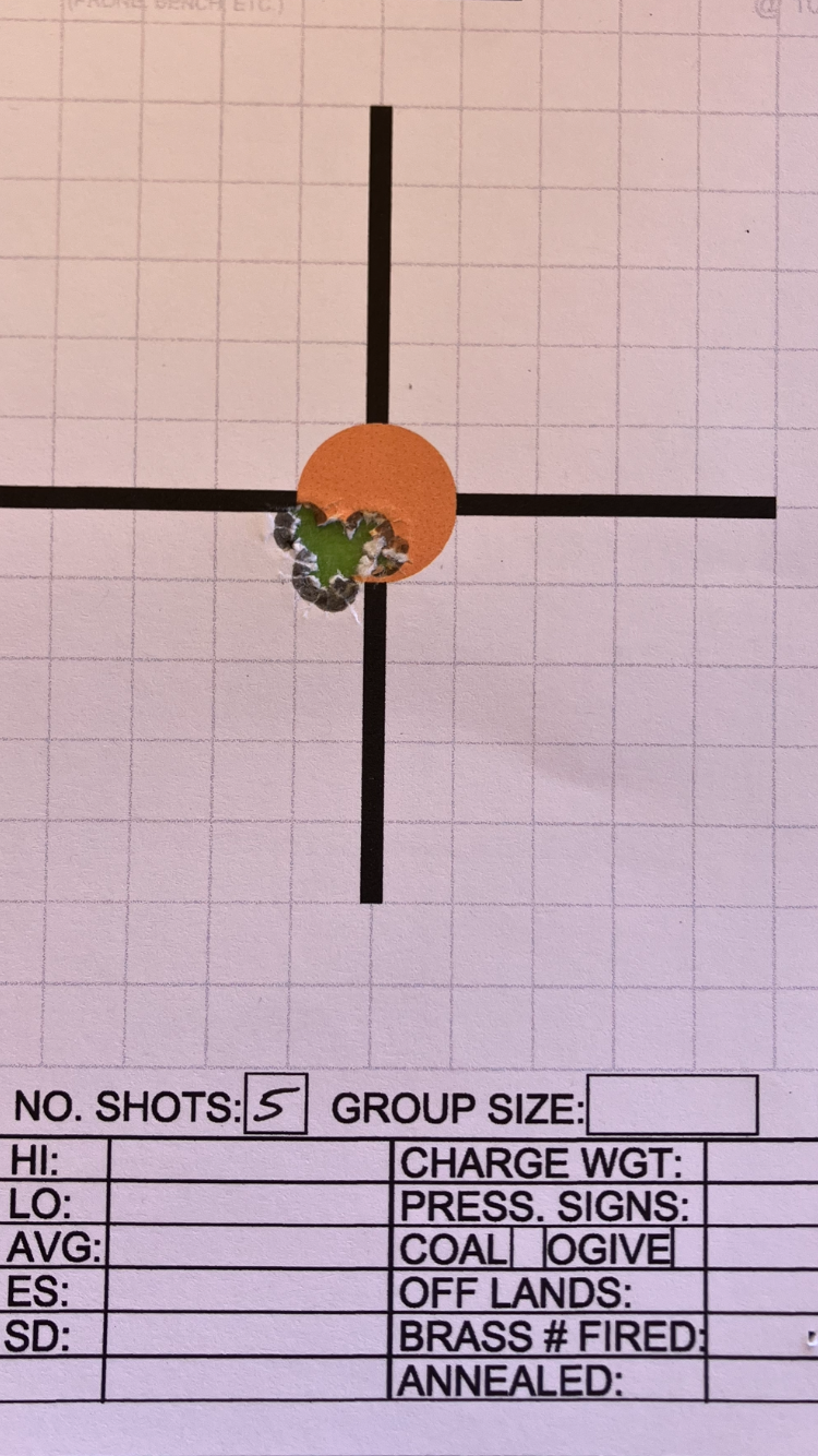

IMHO just pick a simple, solid, single-stage with as few bells and whistles as possible and spend the money you save on good components in bulk so you can work on honing your craft… that’s all it takes.
I load all my precision ammo on a little $100 Lyman Ideal press using normal, nothing-fancy dies and it kicks ass and all my ammo comes out awesome… my buddy uses a fancy Zero press and $500 a piece dies and all his ammo comes out like shit.
Like most things, it’s the Indian, not the arrow.
