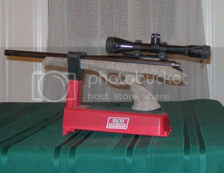

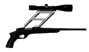

When MDT advertised the World's Tallest Scope Base.
Especially when considering some of the scope bases used in IHMSA standing that were a good six inches off of the handgun (used in the Taco Hold)
But I have to agree this would be the highest
MDT World's Tallest Scope base
Taco Hold Mount pictured
One question... Why?
MDT was testing height of scope vs cant. On that Taco Hold, they would use a very high powered rifle scope on the handgun (with very little eye relief and use their free hand to hold the mount to steady the handgun and keep the handgun from recoiling the scope back into the shooter's face.

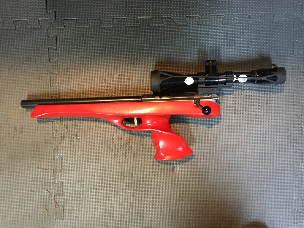

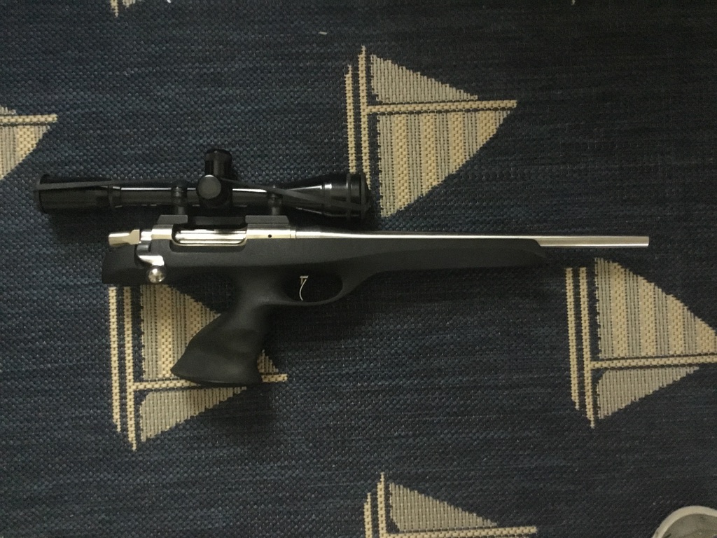

When folks talk gamesmanship (as opposed to real world use) and they talk PRS, PRS can't hold a candle to the IHMSA. They went from S&W Model 29's, to this...
