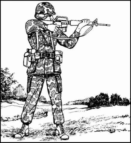

I like positional kneeling, sitting, and prone, but I just can't figure out how to do standing right. Elbow/hip bone contact etc just doesn't work out well for me.
Well, the good thing about positional shooting is that it can be adapted to your personal style, taste, body type, etc... here are some random pictures I snagged off the net showing some different ways to accomplish the standing positional method:
I’ve seen people do well using all styles of standing. Practice until you find one that you are comfortable with and you'll find that you do better at it.
I shot enough of the offhand during XC HP matches to last me a lifetime - I always referred to my own offhand shooting as 'awfulhand'. Even with a heavy Creedmoor coat like the Marine in the above post, I struggled. The main reason it took me four years to leg-out and earn my Distinguished Rifleman Badge was poor offhand shooting. I finally bought a dedicated 22RF AR15 service rifle upper from CLE and shot it offhand until I could sometimes manage a 96~97 score at 200. Part of my problem is that most of us don't like to practice what we don't do well at - I loved shooting sitting rapids, and so had to force myself to shoot at least 20rds of offhand before I would allow myself to move on to sitting rapids (didn't shoot rapids with the CLE 22RF upper, since the lack of recoil would screw-up my cadence when shooting the 223). Offhand with a 15lb AR15 is pretty comfortable, since most of the added weight was in the buttstock, but it's not much fun with my comp 40XB/V-22/RimX, all of which are more muzzle heavy. I've got a CZ457 American with a 23" Shilen that's about 1/2lb heavier than the OEM 24" bbl, and a V-22 sporter with a 22" Krieger #4 sporter in a Manners EH2 stock - both of these rifles are relatively fun to shoot offhand, especially compared to the heavy comp rifles.
My Vudoo is probably 20 lbs and I do fine offhand with or without a sling. The only time I practice offhand is eliminating tree rats so I still see the practical use for having off hand stages.
