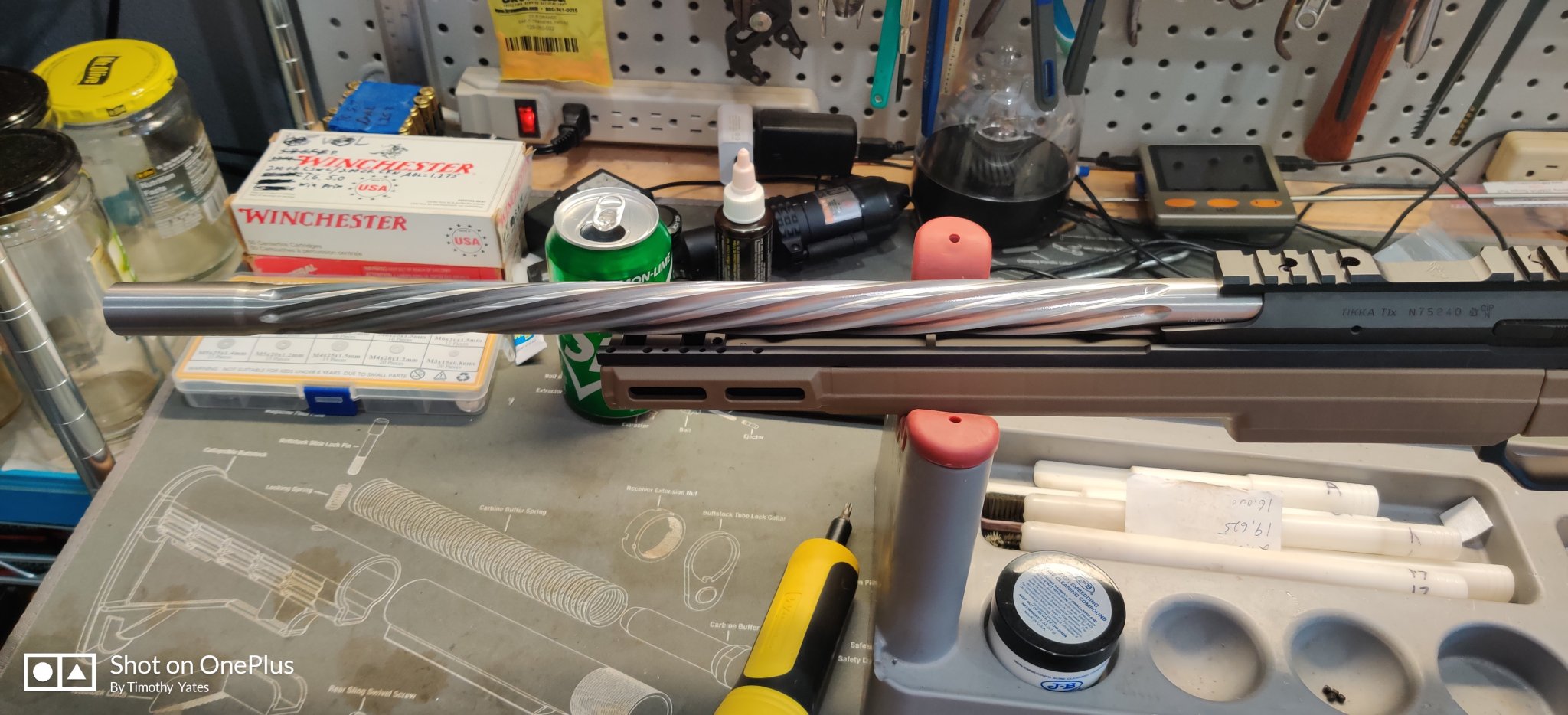

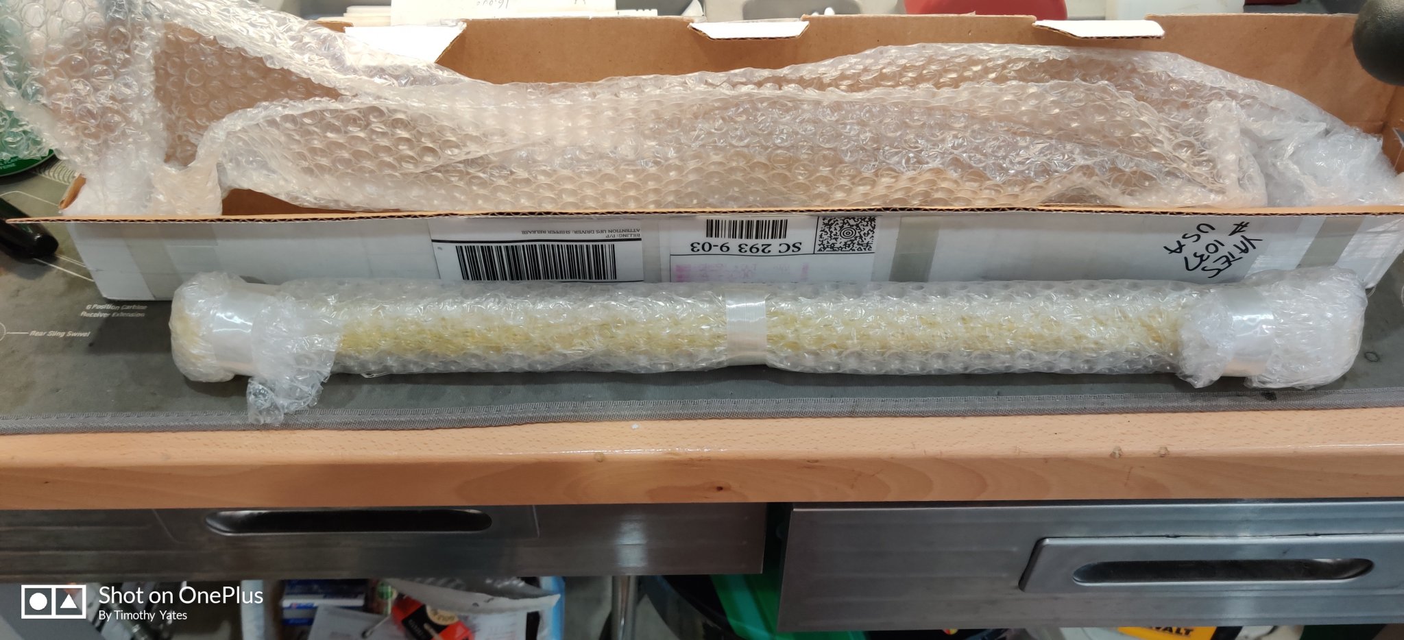

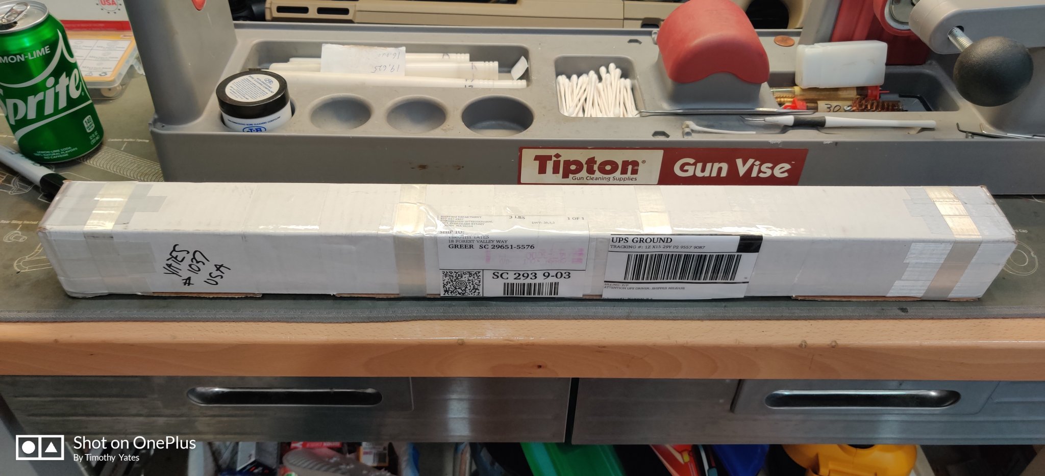

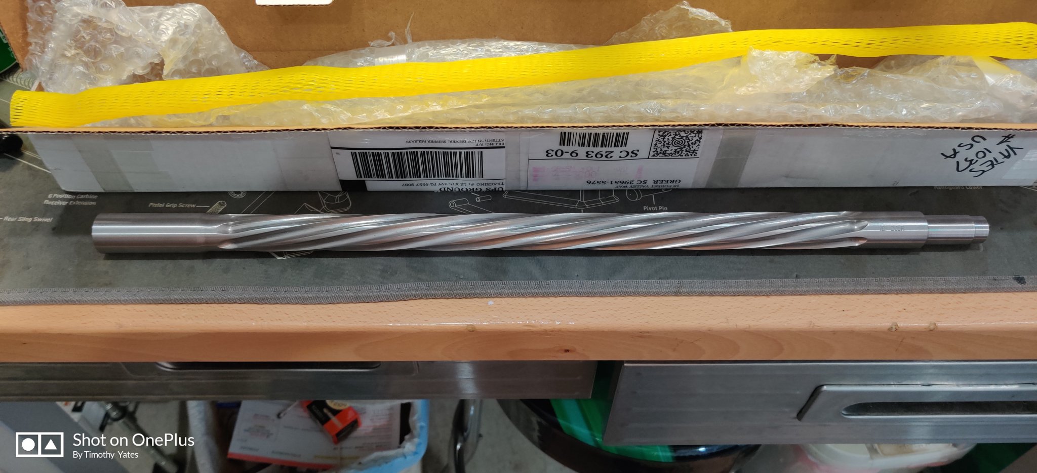

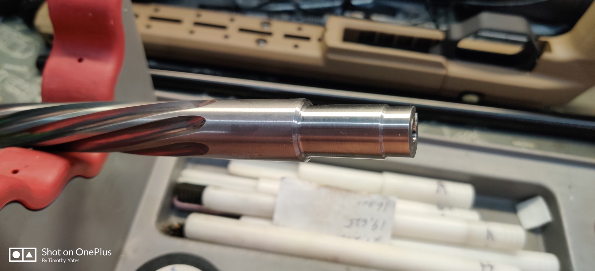

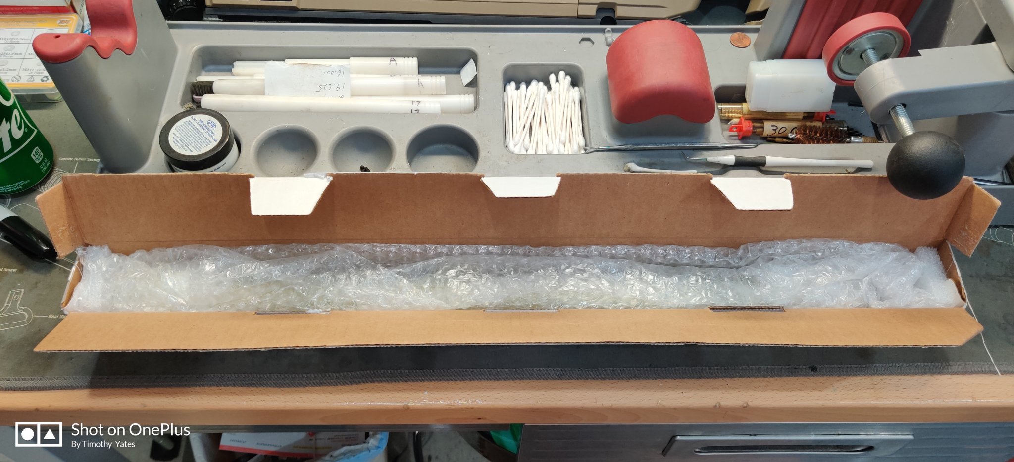

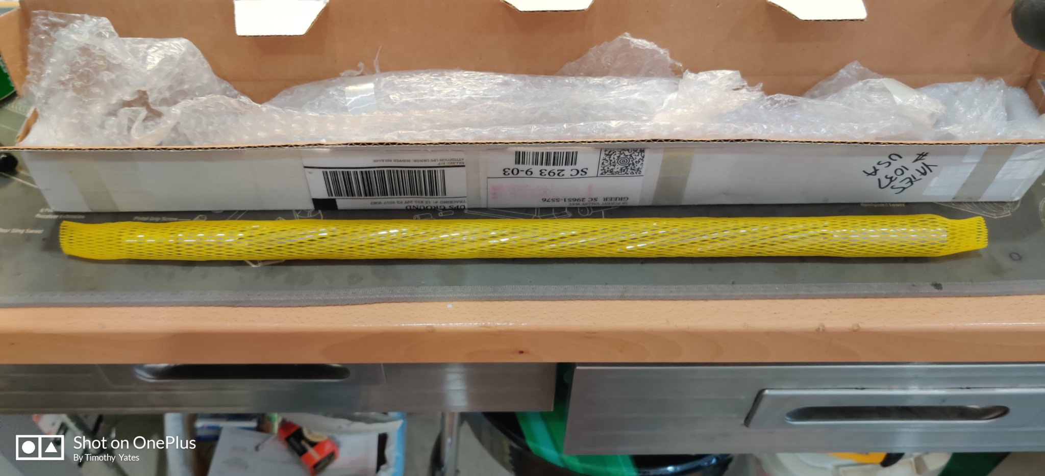

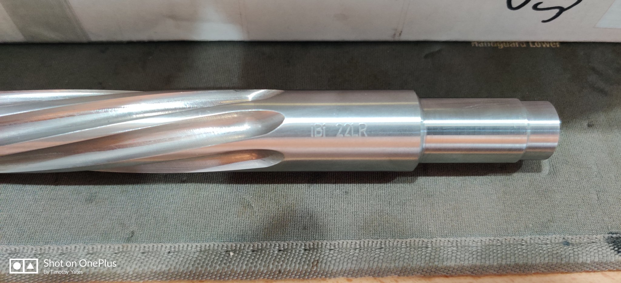

    Well guys and gals it has finally showed up. Door to door delivery time was 14 days. The looks is like I figured...fantastic. I have included photos so I will give dialog with those.
    Barrel as received from UPS.

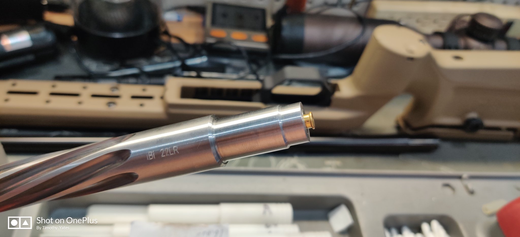

    The shank profile is the same as the factory barrel.
    Crown typical 11° and very nicely done.
    This barrel chamber is cut with the Eley EPS reamer. The round I have in the barrel is Eley Team which has the EPS bullet shape. What you see sticking out is the amount of bullet that will get pushed into the rifling when the bolt is closed.

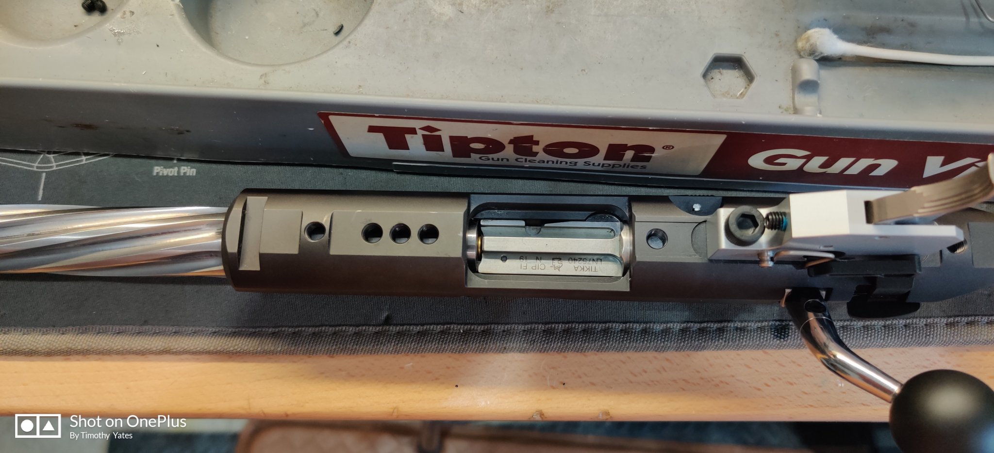

    Setting headspace is done with the ammo you want to shoot. Obviously in my case I used ammo that matched my chamber to begin with. All you do is insert the round in the chamber, stand barrel on the end, have bolt in the receiver, cocked with safety on, slip the receiver down on the barrel shank, align the extractor and cut and push down until the barrel stops. After this you can tighten up the set screws.
    I have a few more photos so another post will be made. Please respond after I get the second post made.

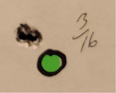

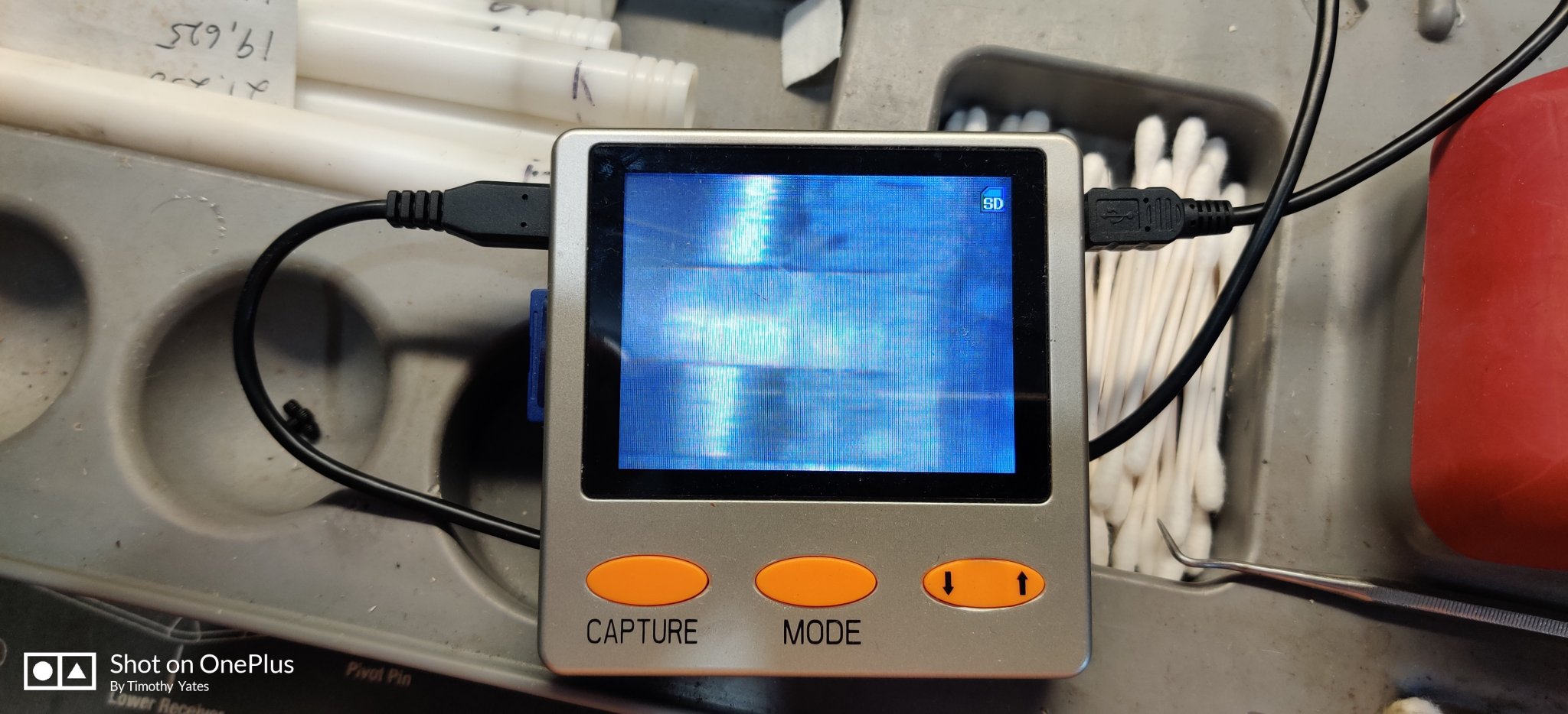

    Below are a couple of photos showing smear marks (cloudy area) made by the Eley Team bullet. Again, this is how much contact is being made between the bullet and rifling before firing. I know, I know you guys probably already know this but I'm writing it as if some damn liberal POS was reading it.
    I used my standard 20 in/lbs torque setting for the receiver bolts.

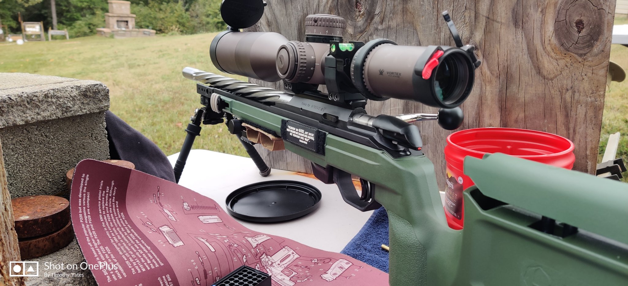

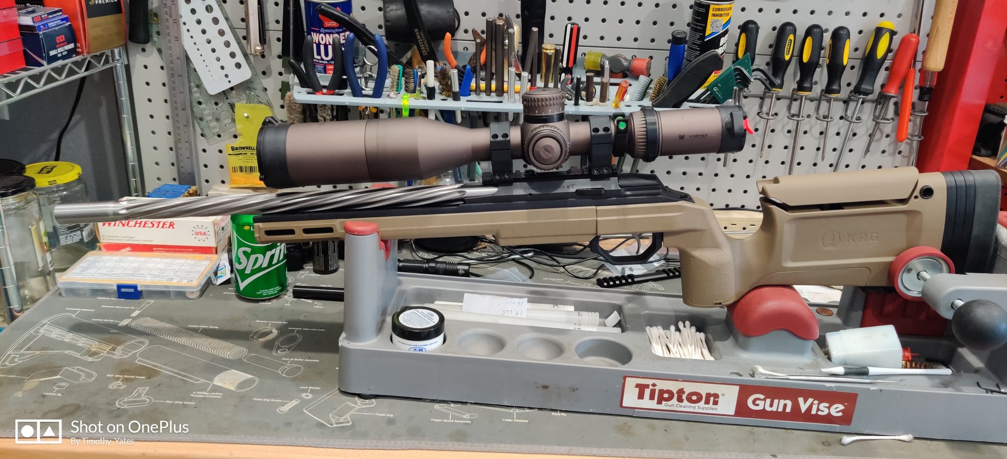

    Ready to rock n roll. Probably won't get to shoot it today as it is getting late and by the time I get set up I won't get much accomplished.
    I went with another KRG Bravo stock because I liked the first one so much. I may swap it out for the Sako Green later just to see how it looks.

    A couple of things I have noticed about the IBI barrel is, the chamber is not as tight as my Sako Finnfire. It has more wiggle. The barrel wobbles pretty bad even when fully inserted into the receiver, it probably could have been a few thousands larger. My only guess is some receivers may have a smaller ID and the shank needs to be that small to ensure fit for all?? Last thing I noticed is the rifling isn't as polished as a lot of other barrels I have such as Anschutz, Sako, Steyr and Lilja just to name a few. No idea what if any effect these will have on accuracy just an observation.

    Yes with the set screws tight the barrel doesn't move. The flutes are for looks and weight savings. I can hold this setup pretty steady for offhand shooting. IMO, for me, this total package (scope, barrel, stock and weight distribution) is balanced near perfect. This is for me, others may feel different. I'm sure a non fluted barrel would be too heavy for me, offhand.

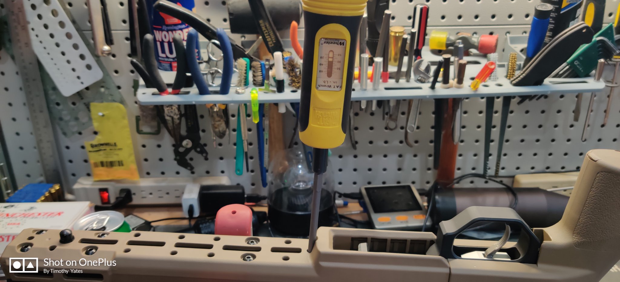

    It took my smith a lot longer to take my barrel off than anticipated. The big issue he had though was he snapped the first driver off in the set screw and couldn’t get the broken piece out. After that he tried everything he could to take the set screws out before drilling them out. He worked on it for a full day off and on trying to take it apart. If I would have known I would have just drilled them out before delivering it to him and saved him the frustration.
    KOD how did you end up getting your set screws out?
    I believe it wasn't a single attack but a combination of attacks from Sgt. Kroil, Capt. Impact Driver, Major BT Wrench, Pvt. Tiny T15 and General KOD applying constant pressure on all to work together as a team.
    The key method I do believe is using the Battery Terminal wrench down low "sitting on the receiver" and being able to apply very slow constant pressure on the screws. I believe this is better than using a long screwdriver. I would point out that I didn't have to use heat.
    Side note, we did have 4 casualties in this operation.

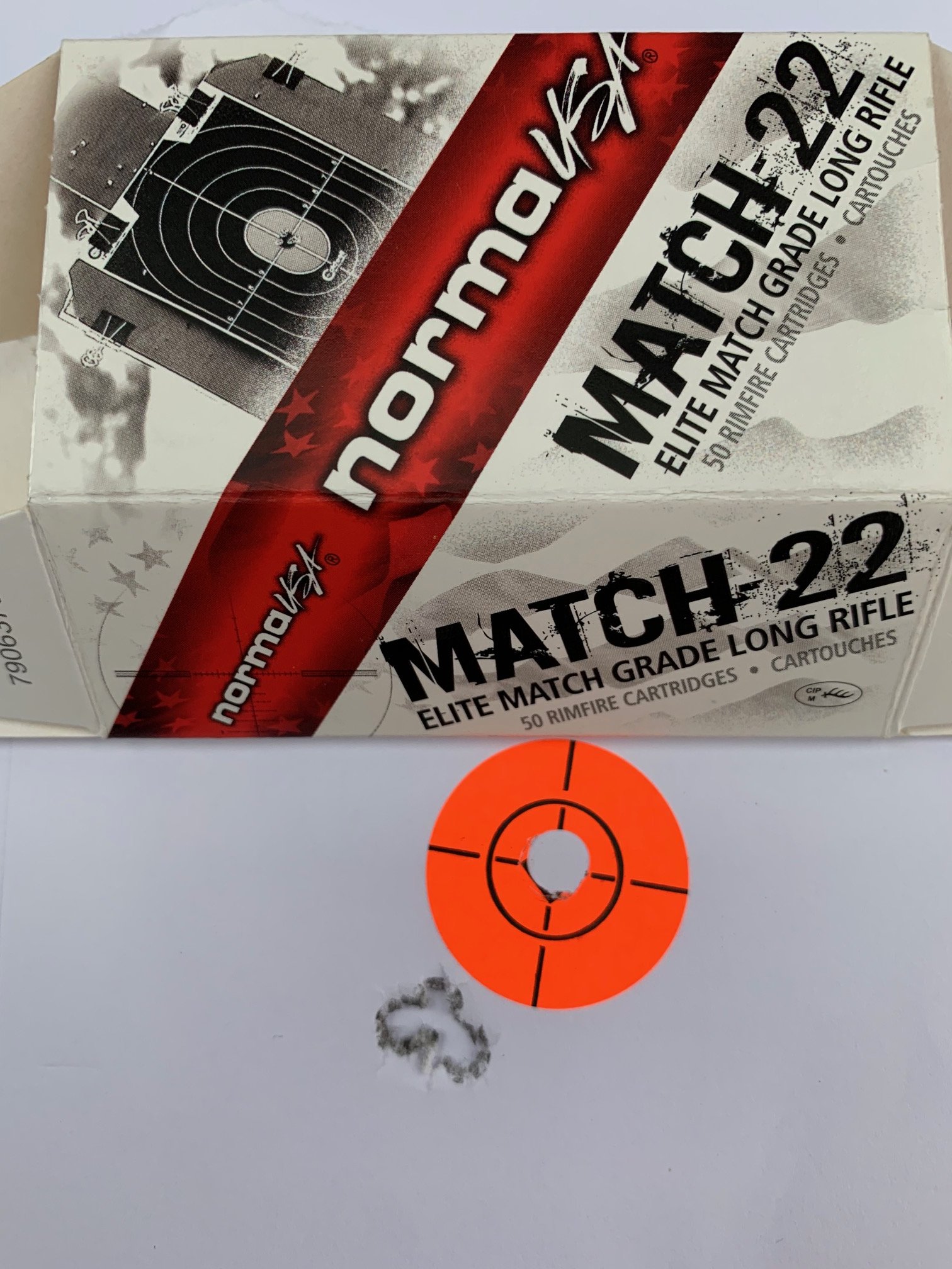

    Well, how many people shoot 600 rounds in approximately 4 hours? Just finished up shooting 12 different types of ammo through the IBI barreled Tikka. Final report on the IBI barrel will follow shortly. There is a lot to say and discuss.
    Spoiler alert, it was worth the money, I'm glad I bought it and would buy another if it was offered in 17 HMR or 17 HM2 or another 22 LR if it was threaded for a suppressor. It's a keeper for sure.

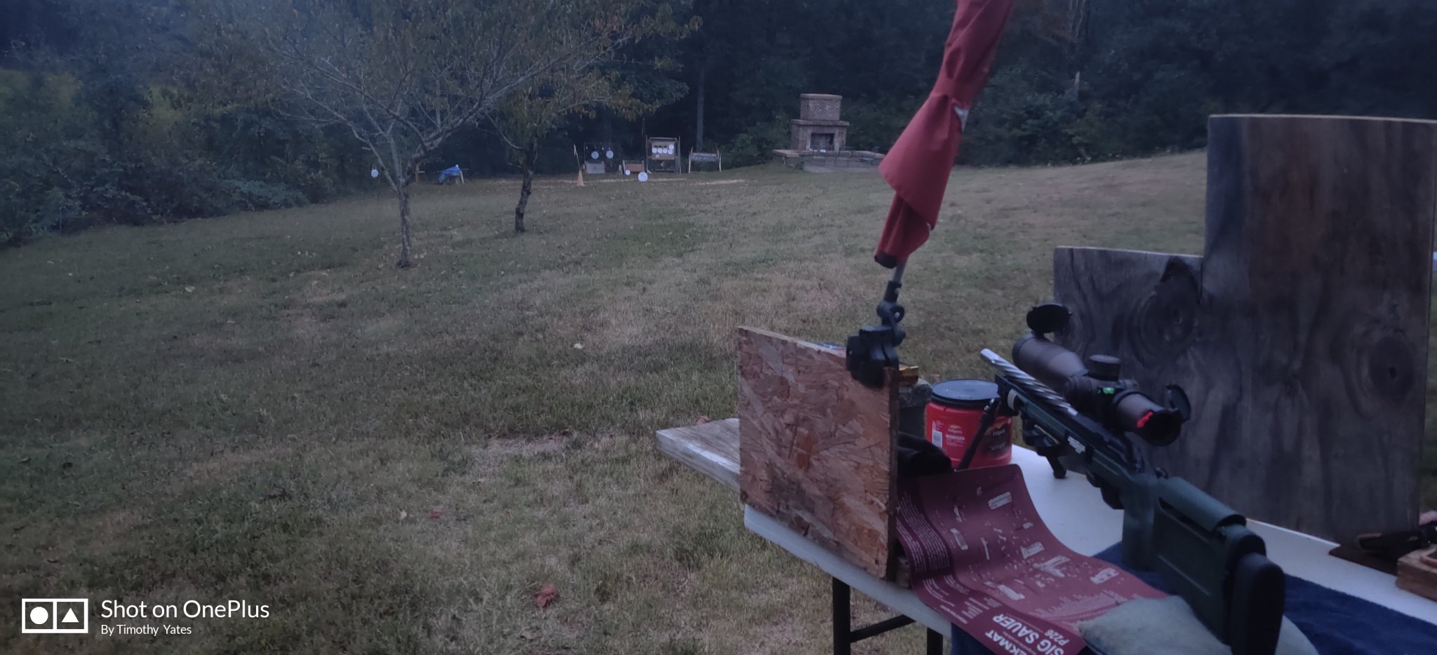

    Here are a couple of photos showing the ammo tested, rifle and range.
    This first one was taken after I was finished, it was getting dark but with the amazing clarity the Vortex Razor HD GEN II made it easy to see the dots.

    I switched stocks. I prefer the Sako green with both guns but one has to sit in the Tan stock.

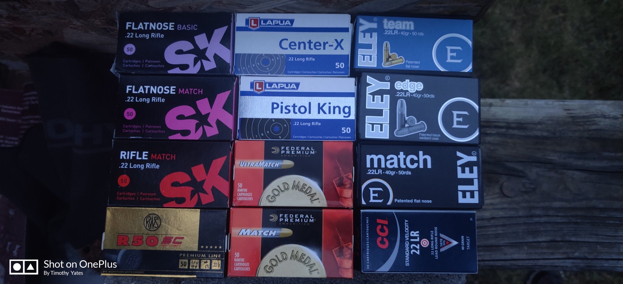

    All ammo tested on 10-15-19. One ammo that you may notice is missing and that is Eley Tenex. I have lost a lot of faith in Tenex and can't make myself buy it for $17 a box anymore.

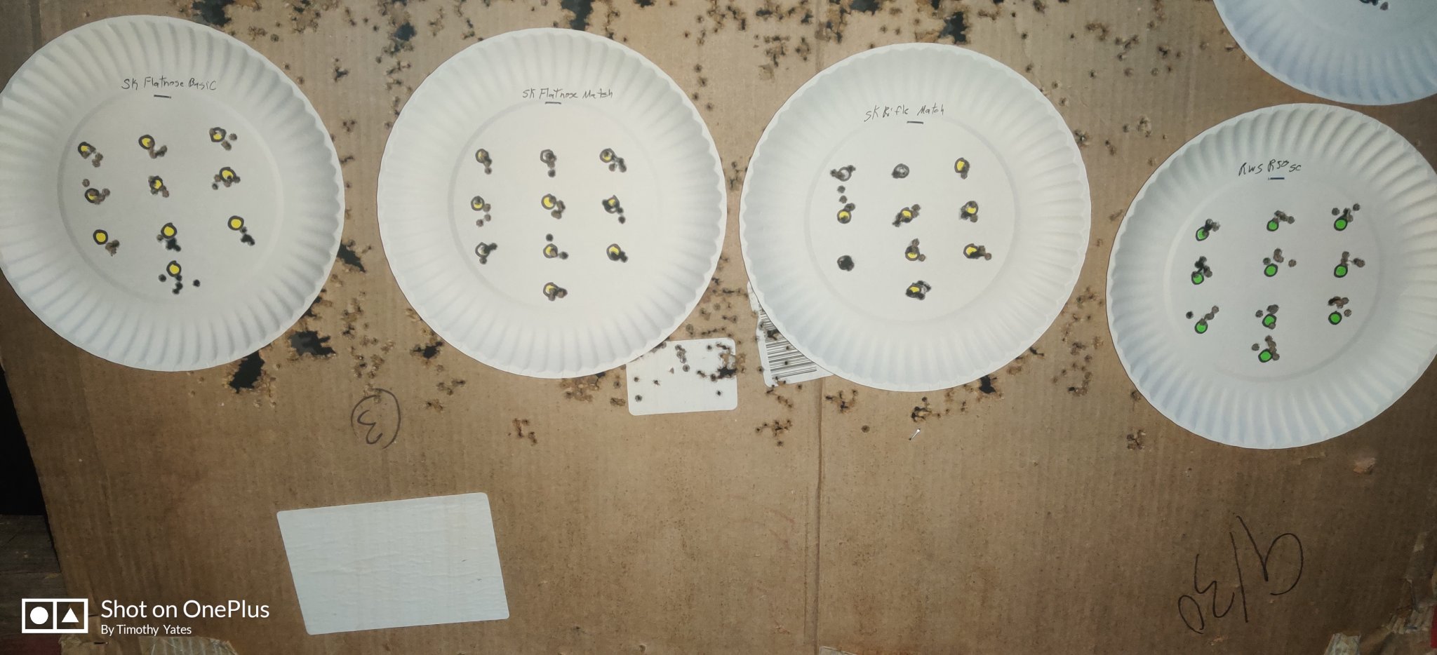

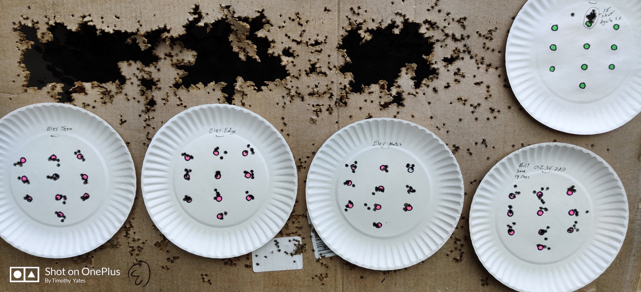

    These next three photos show the ammo as shot in sequence. The barrel has never been cleaned since first getting it when I ran one dry patch down. I don't know the exact round count but I would imagine between 1300 and 1400 rounds have been shot so far. Please spare me the cleaning lecture if you have one. Everyone has their own beliefs, superstitions and so on regarding cleaning a 22 rimfire.
    What I do want to point out is there is no significant 1st round flyer. The exception is with the Lapua Center-x shot on 10-15-19, it does seem to have had one. But, would it have if I had already been shooting Center-X?? Also I want to point out that switching ammo doesn't require a few shots to get "in the groove" or be accurate. Some people believe you need to do that and that's fine with me. Based on my experience I don't have that belief. Maybe on the very first shot such as the Center-X but I do not believe it for every single time you switch ammo. You may have a particular gun that exhibits this behavior but I don't think it's the norm.
    I started with Eley Team, shot left to right and finished with RWS R50.

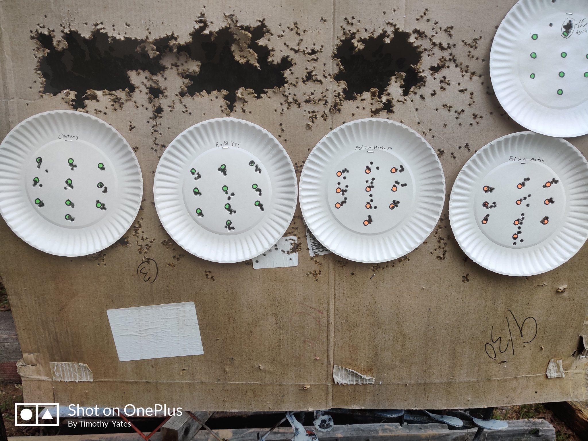

    Now for individual targets and commentary above. I will start with what I think shot the best. Read the targets it has information.

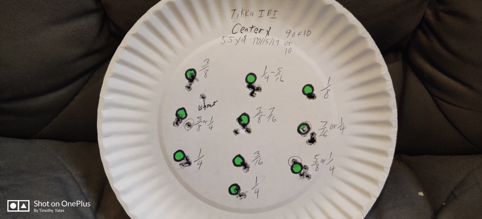

    Lapua Center-X shot the best. There is a lot to be said about these two. targets. 1st, all but one group is UNDER .5" that's 19 out of 20 groups. 15 out of 20 are 3/8" or better. That's including the groups that's 3/8" - 7/16", that's like splitting hairs anyway. On the second target a slight movement of something on my end prevented me from getting 3 additional 1/4" groups. 5 of 10 were at 1/4". All shots on their own target are all in the same area next to the bullseye.
    Now that I've got you thinking about targets or hopefully I am, I won't need to give as much dialog from here on.

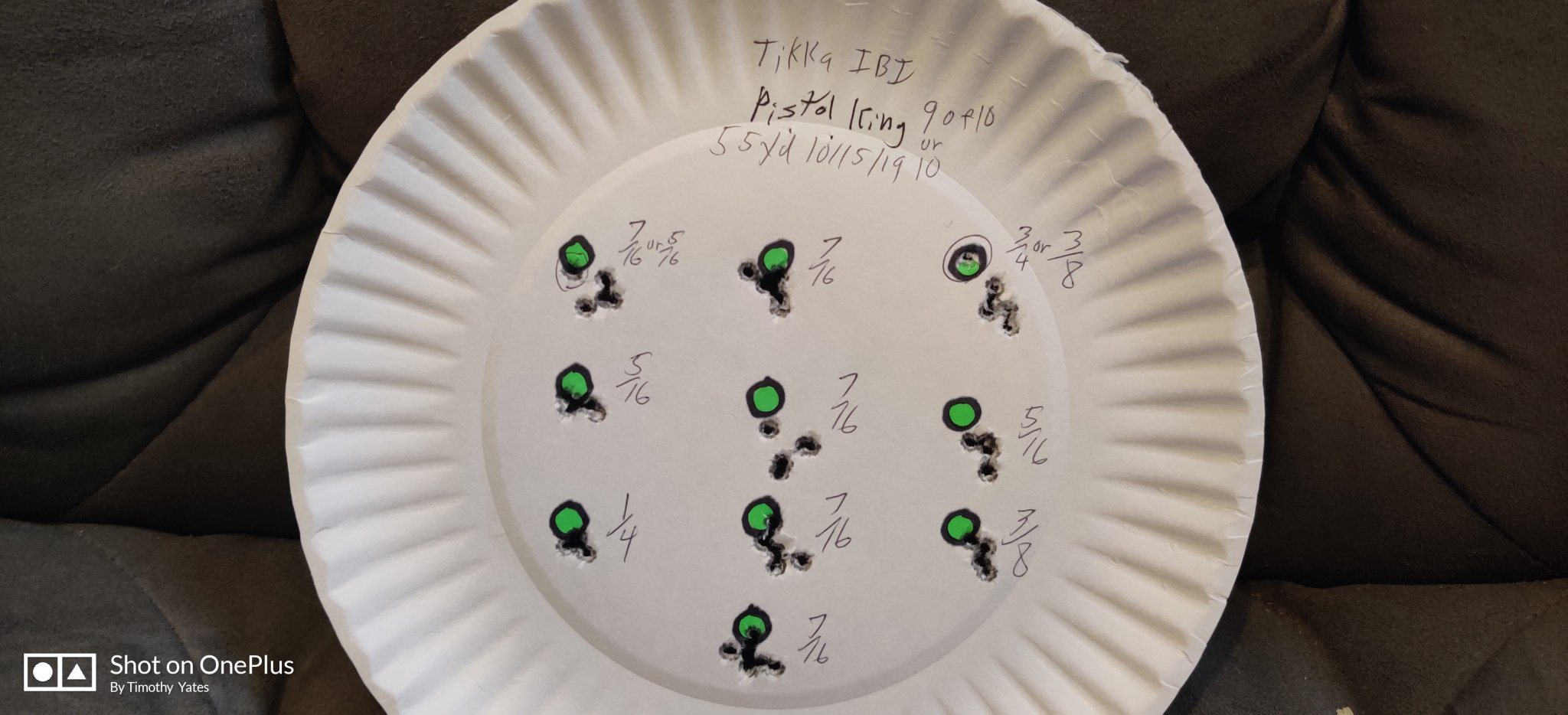

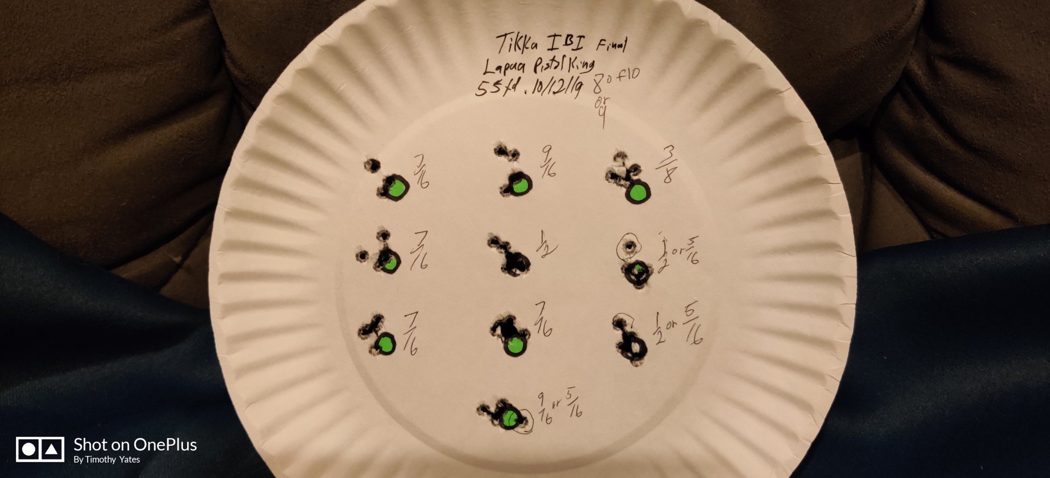

    Next best is another Lapua product called Pistol King. I'm surprised I don't see people shooting this ammo much as I think it's great.
