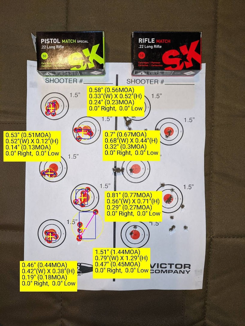

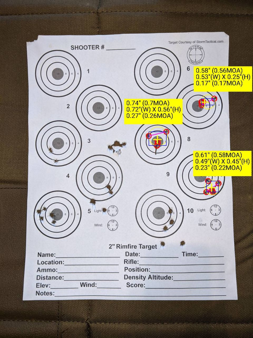

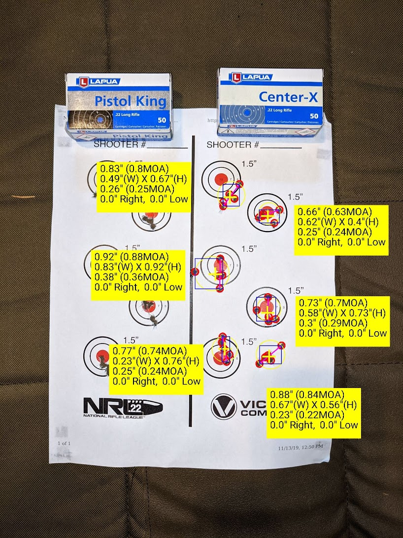

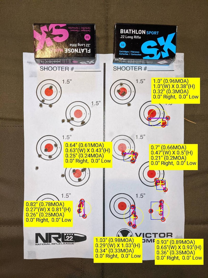

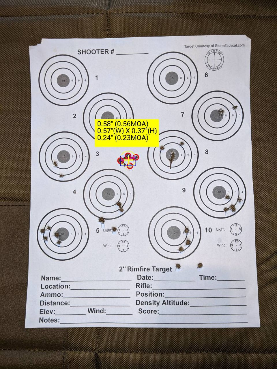

Loading is very smooth. I do not have any lead shaving or scaring. I would also mention that it's this way with the factory barrel and my Tikka #3 is the same. This may have more to do with the ejector than anything else.

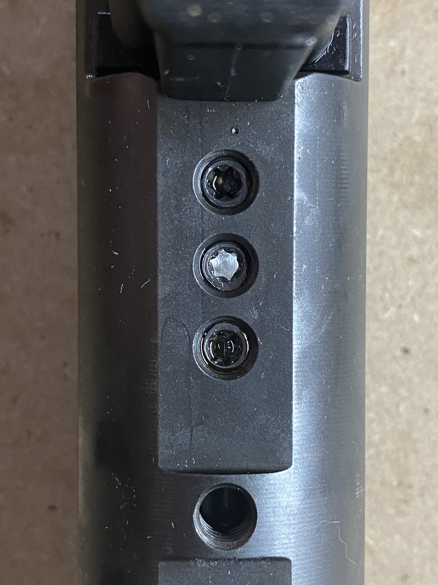

Hmm I noticed a ton of wax build up on the bottom of the barrel, basically where the eley rounds kind of scraped a bit. I haven't touched the spring since I replaced the barrel. My factory tikka did feed really smoothly. I'll have to muck with it more some more. Lots of tinkering.
The same amount of force a dowel rod needs to push the round into the Win52d chamber, is about the same amount of force I need to push my bolt forward, so that's the part that's hard. Might just be the chambering. I saw some new anschutz at matches require a bit more forward nudges before they could cam the bolt down to get it seated forward enough. At work all day, and tomorrow. I might be able to get an hour of sunlight at the range on Friday if I get lucky.
I cleaned my barrel last night. First cleaning since I got it, 400 rounds through it. A few wet patches of C4 Rimfire Blend, let it sit for 15min, then a few dry patches. I got some boxes of SK Rifle Match and Center-X to test today, and I wanted to see how long it'd take to foul and what the cold bore shot was. Went to the range, loaded up my remaining SK Standard + that I shot yesterday (2.1 mil at 100 yards), and started shooting. I thought it was my fouling shots that were causing it to shot low, 7 shots later -
There are 7holes there, then I went back and dialed up .4, and left .2 and that's the #3 target with the 3 remaining bullets in the magazine. I then switched over to Rifle Match, SK LRM, and Center-X.
I loaded up 30 rounds for each ammo type, and shot 5 fouling rounds into this sheet, and the other 25 on the 5x5:
SK Rifle Match.. horizontal was good for the most part, first group, first shot (6shot of rifle match, flew to the left, maybe still needed more fouling, I don't know. Next few groups just had some variances in vertical, but horizontal was fine, maybe just a bad lot / SD variation.
Then switched to SK LRM for 30 rounds (5 shots fouling, 25 shots on paper)
First shot on paper, went really high (6th shot of the ammo) Ignoring the outlier groups, it shot okay.
Lastly I shot center-X. I figured I'd do a 6x5 for it to see how it holds up. I then also shot the remaining box on the paper I was doing my fouling/poi shots on.
Center-X, 100 yards, 6x5. 0.76" average, .52" smallest group.
Shot the remaining box on the other paper.
Looks like time to go center-x lot hunting.

5, 6x5's, all sub moa @ 100 yards. I am impressed by this barrel.
100 yards
35 degrees out, freaking cold.
And foggy.... maybe I shoot better in the fog lol.
SK Biathlon Sport .81 MOA
Pistol Match Special .73 MOA
SK Rifle Match .92 MOA
Lapua Pistol King .66 MOA
Lapua Center-X .76 MOA

But how do I get the broken bit out?
I've only broken two bits like that and I've gotten both of them out with compressed air. I have heard that you can also use a can of the duster spray turned upside down to freeze it a little bit then hit it with the air compressor.
Your order of this repair should be
1, obviously get the broken bit out
2. Take out the other two screws and put antisize on them
3. Put the other two screws back in and make them TIGHT
4 Take out the middle screw and then the other two
I also made sure to buy something high grade when I did this given how much I heard about it being hard -
Reactions: louu
Update: I cannot get that barrel out of the receiver. I have a 1/2 wooden dowel which is the perfect size, I have clamped it in a vice numerous different ways. I tried the PB Blaster overnight. The only thing I can think of is maybe my old lady's hair dryer isn't getting the receiver hot enough to loosen up the adhesive? We've even tried getting 3 dudes with rubber arrow pullers to try and turn it to crack it loose. Any advice?
Have access to some nitro based model airplane fuel? Nitro-methane is the active ingredient in the loc-tite remover they sell, but ~$80 a bottle is a lot for one time use.
Yeh get a heat gun. It's glue that needs to be melted to get that barrel out.
Update: We heated up the receiver with a propane torch quite hot and it still will not budge. I even shattered the wooden dowel. the 1/2" dowel is the exact same size as the barrel so we're making maximum surface area. I'm at a loss now. At this point, I don't care about the factory barrel I just want the moral satisfaction of getting it out of the receiver.
You applied heat right at the area of the screws?
I didn't do much besides the heat and then knocking it out. I don't have any other suggestions except some sort of barrel vise, heat, and then again twisting it off, pulling it off.
Action in vise
socket with an OD close to internal diameter of action
extension
Hammer
I did that with mine when it got stubborn. There was some bluing removed but no damage to the breechface or feed ramp
