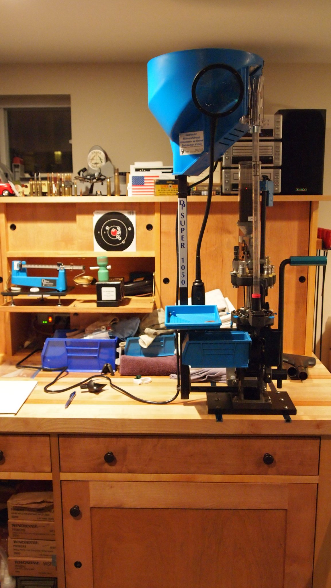

It has a Dillon and a single stage and 2 powder measures, and 2 powder throwers. Akro-bins stack nicely in the back. Probably 20 lbs of powder and 10000 bullets stacked behind the bins (overflow storage) provide counterweight.

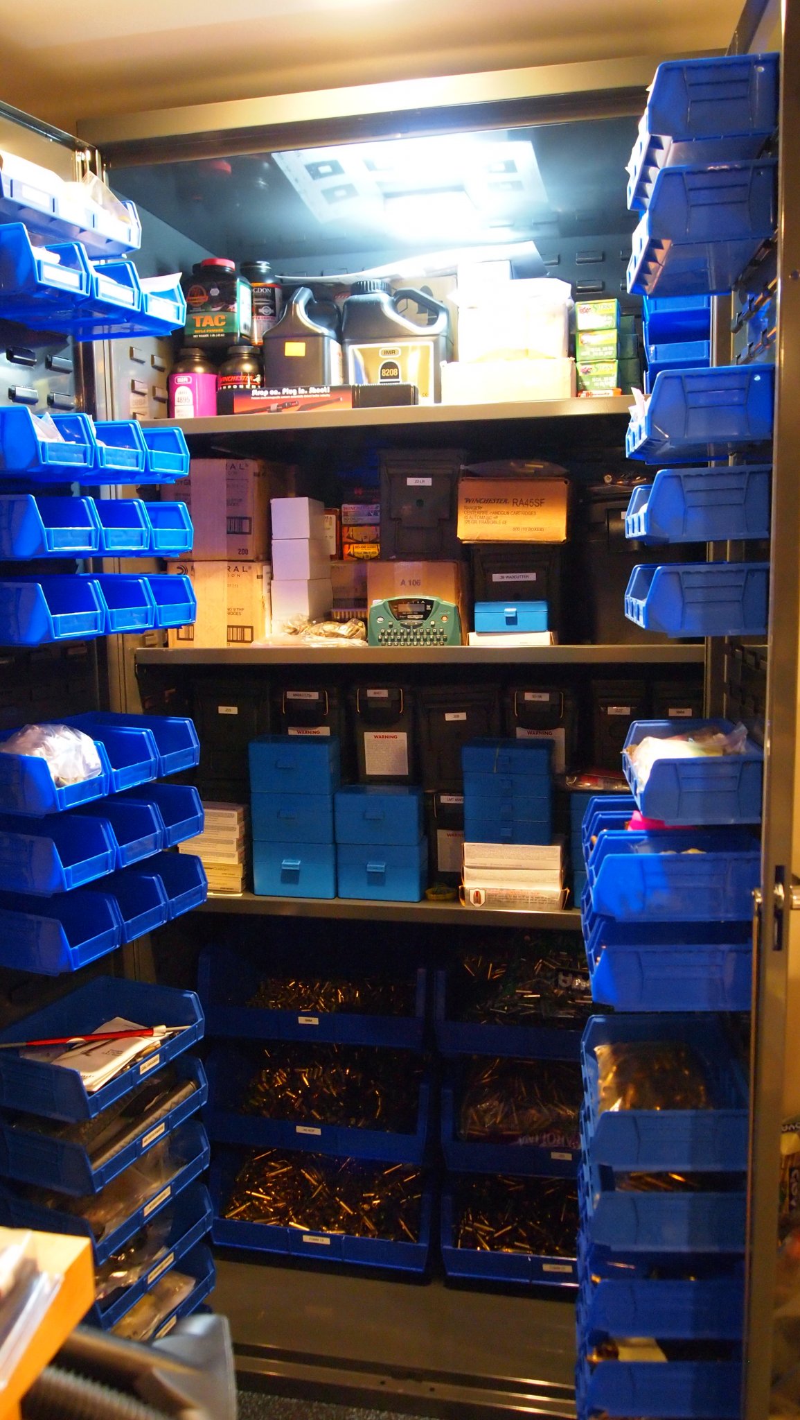

Whatever you do...make sure you have plenty of storage area. Cramming a bunch of crap into a small space and having to sift through it to find what you want every time sucks
My bench is 26” deep. 8” of that depth is taken up by shelving for powder, bullets, brass, another miscellaneous stuff. Currently my bench is 4’ wide but I wish it was wider. I’m 6’3” and have the top of my bench 42” off the ground so I can run the press handle without having to hunch over or anything

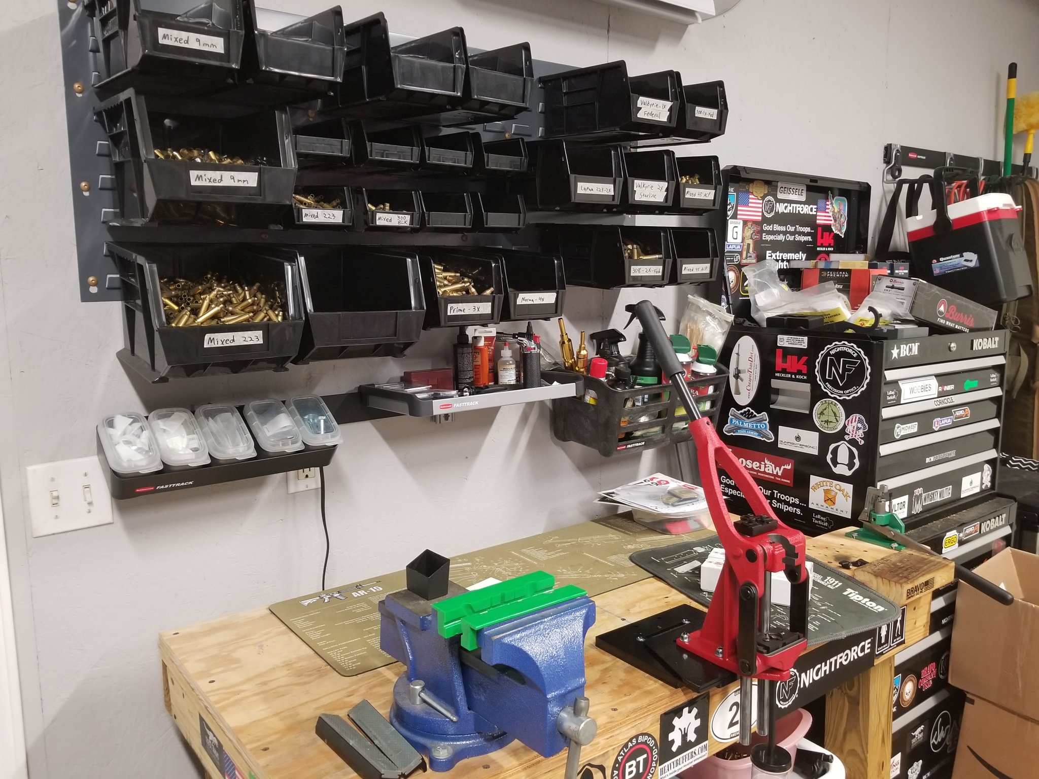

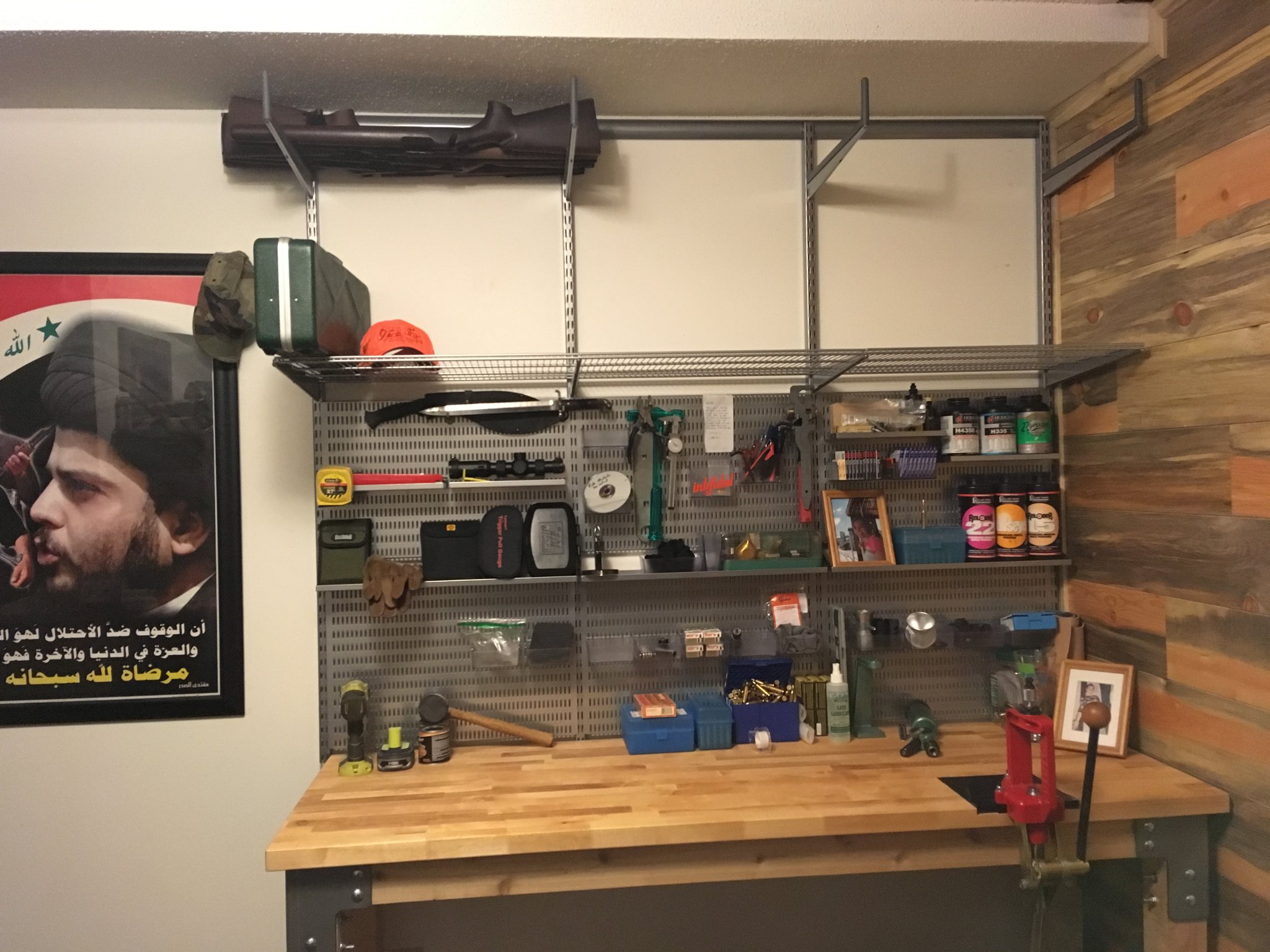

I really like my louvered wall panel for hanging plastic storage bins on. Great for organizing brass, bullets, small tools, etc. I got mine from grainger.

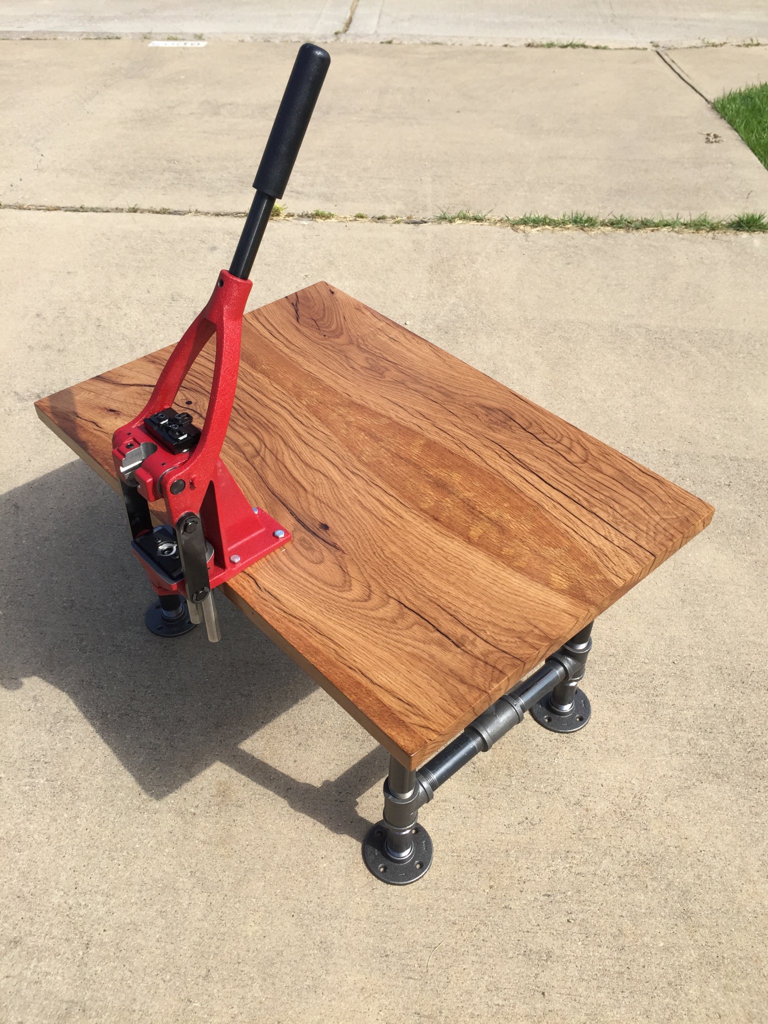

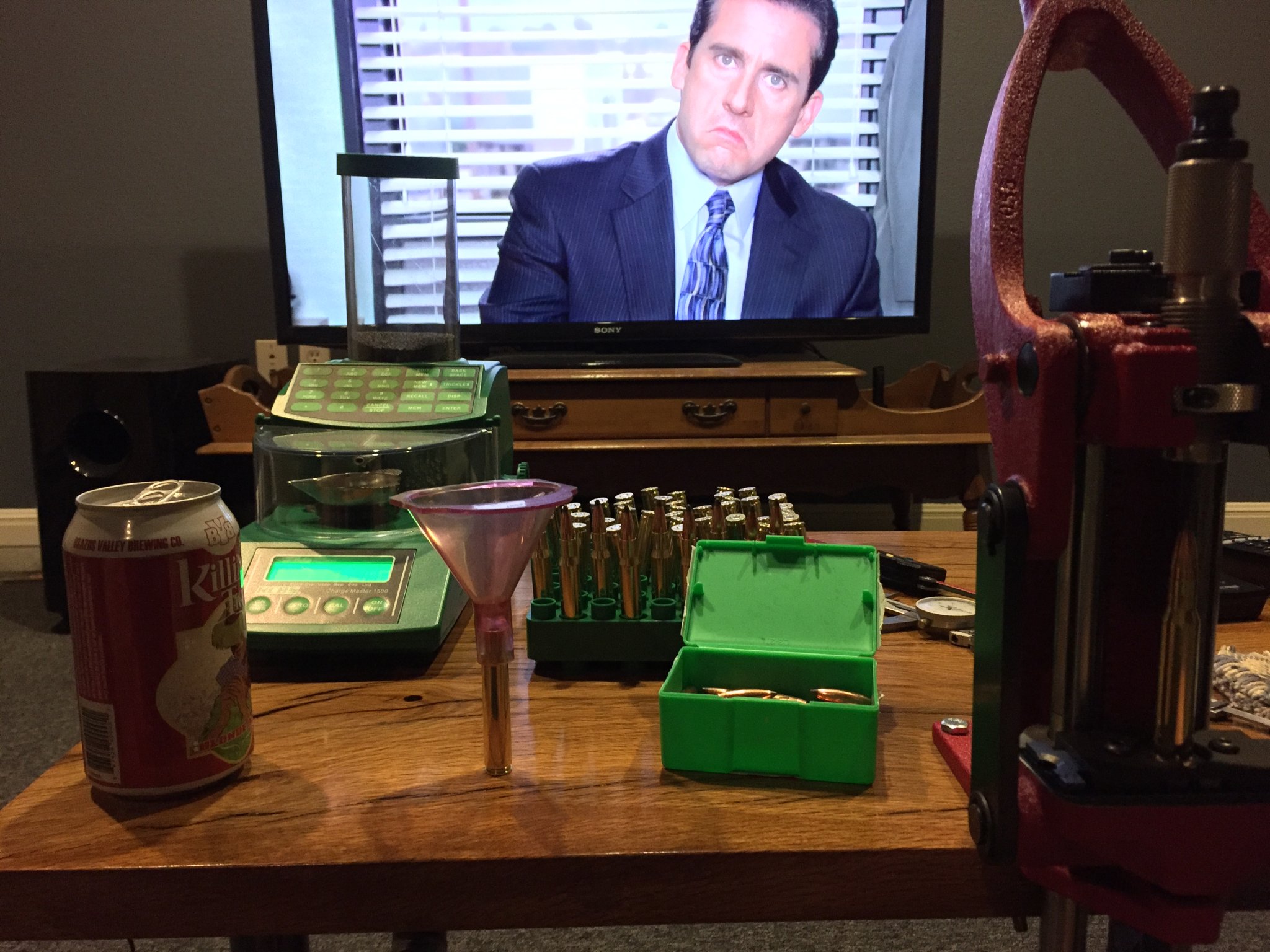

I use a little 2x3 coffee table I made to sit my ass right in front of the tv. Whatever I’m using goes on the table, when it’s not in use I remove it and put it in/on a cabinet.
I’ll go the other way and say you don’t need a huge space for the task at hand. And you can do it sitting down in front of the tv so you’re comfortable instead of standing like a chump staring at a drywall corner.

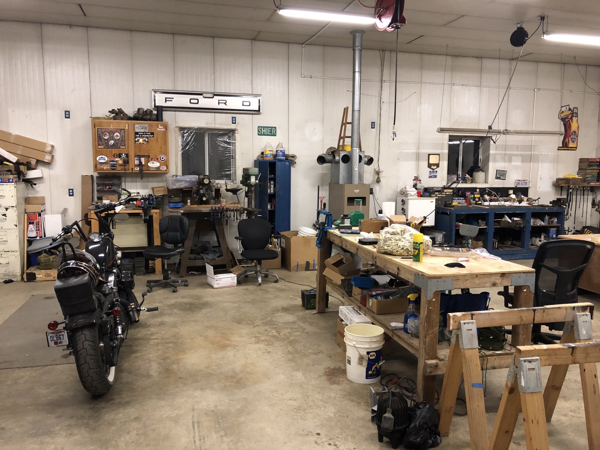

Heres my two bench setup in my shop, although these are older benches. Once i get a few house projects done, I'll be putting the long bench up against the wall, and extended the short bench as a secondary cleaning/misc. bench, and the long bench will be attached to the wall and used as my Fall/Winter bench. My shop is heated and insulated, however it does not like the humidity, so I do have a spare room in my house that is getting a 6ft bench in it soon for spring/summer reloading.
STORAGE is huge. Personally I like the plywood box storage or cabinets, but the bin system works well too, just make it what you want. I would highly suggest taking the advise of every one talking about taller benches. My long bench is not tall enough for me.

The best thing I did for my reloading area was a rolling tool cabinet and chest. They don't have to be the best (mine aren't) although ball bearing drawer sliders are nice. One can roll it to the work area and have everything within easy reach and, at least for me, encourages putting tool away and keeping the bench clutter free. They can be found everywhere and many times on sale.

Across the front of my bench i installed a 1/2" x1/2" piece of aluminium angle between all my presses...with the outer edge flus and pointing upward.
This holds all my akro bins and tools, and keeps stuff from rolling off the bench.
