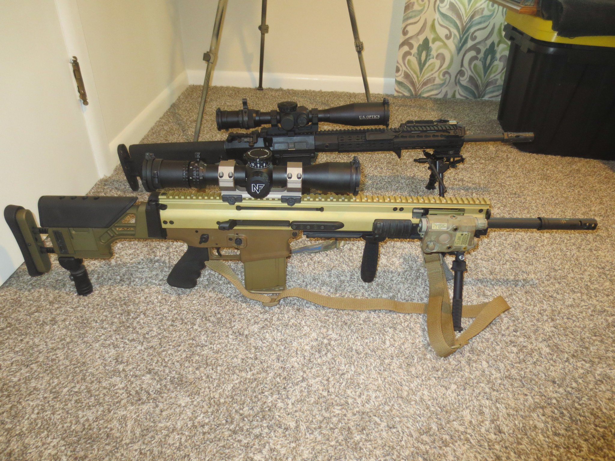

Sorry, I come and go... So yeah, it's an ADM mount on the Mk20, the Delta? --it's the only one that doesn't rake your knuckles, like at all. That's if you don't need/want any MOA. It's a 1.5" or whatever accommodates NV (they're usually somewhere in that neighborhood). It does have an offset mount for a dot too but it's not on it in that picture (they didn't include screws, had to wait on those). It's not a bad mount but I don't feel it's worth what they cost either. What it is though, is a specific mount made for these rifles and you can use 'em with bolts on either side. I wouldn't choose one for that SR25 but it seems to be the goto for the SCAR. I was able to cancel the order for those offset charging handles, don't need 'em with this mount so maybe factor that into cost?
QD mounts aren't all they're cracked up to be. It was something we thought we needed twenty years ago. What we really needed were offset irons or an offset dot if anything. Nobody ever took their scope off. Ever.
With SCAR platform, the charging handle is a big fucking deal. Cantilever only puts more shit in the way (unless it's for maybe a dot and can be positioned such that all the shit is behind the handle) QD levers only stick out more.
I prefer the Badger Condition One but that's another expensive mount. Both are very light. The Condition One is better for hanging shit on if you need to do that though, I got it for an MRAD and it's fine on there. But for the Mk20 or any SCAR, it seems the best is that ADM, that I know of anyway. FWIW, that's the only ADM mount I'll probably ever have, it fills a specific role. The SR25 actually has an older Badger one piece mount. Super solid, Badger is my personal goto.
Yeah, USO got me going good and strong for a few years indeed... Kept me from having to use shit, do without and/or spend a fortune I didn't have.

I don't know if you can tell, but the obj on that USO in the picture above on the SR25 is 44mm, probably 50-something on the od. That's a 1.5" 0MOA Badger mount. FWIW, Badger also has "longer" mount options, ie, they'll accept longer erectors (only ever a problem with USO IME but there could be others?).
