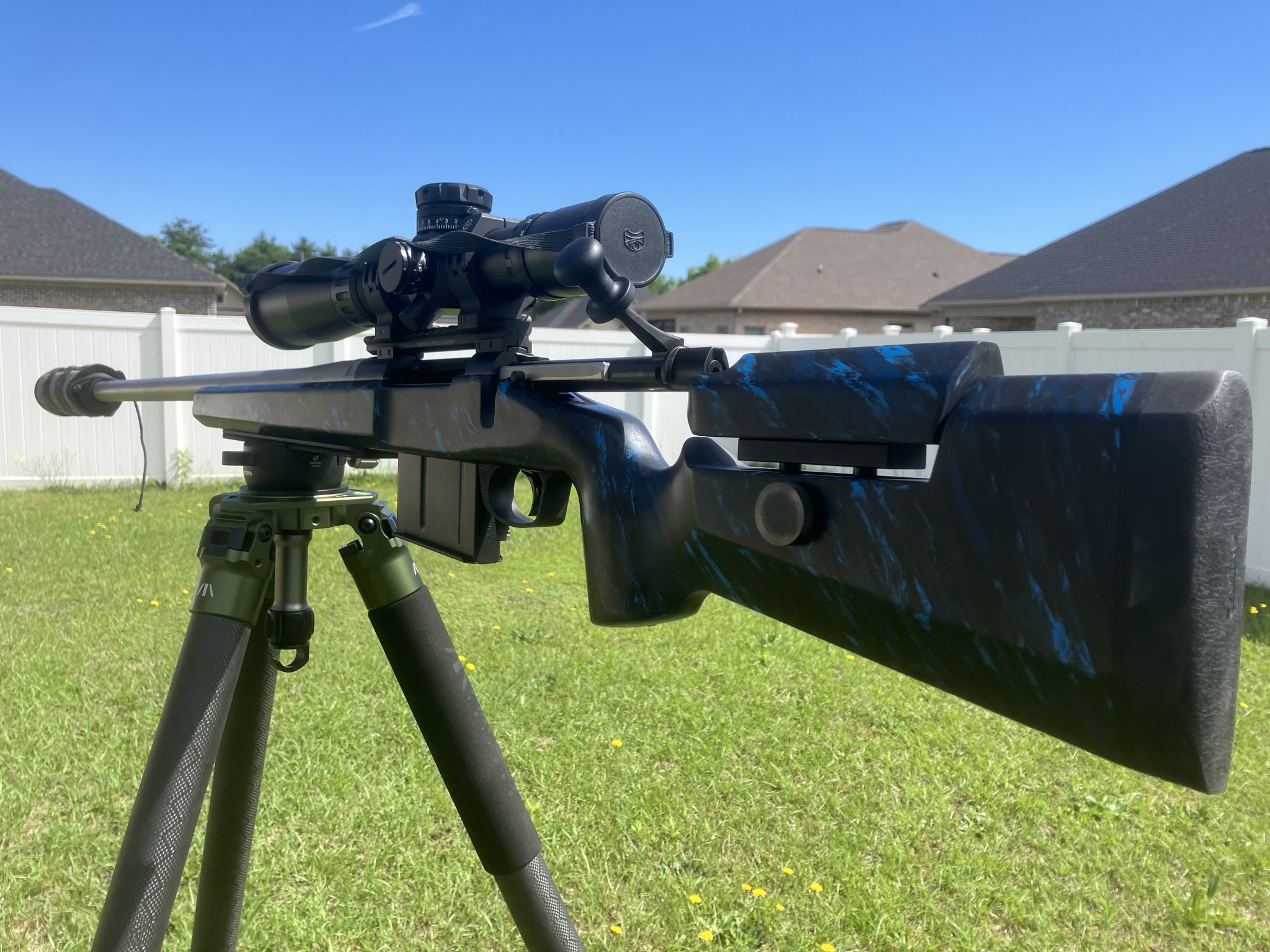

My AIAT with thumbhole stock gets used more than any rifle in my arsenal. Which includes a mixture of mainly AI and Tikkas. With a few savages, rugers and Bergaras mixed in. Also a fclass rifle and a few customs I’ve bought and sold over the years. A mixture of chassis including AI, Cadex, MPA, XLR, MDT, Ashbury, KRG and a couple others
The AT is the only system which since day 1 that I’ve owned it I haven’t had the urge to change anything on. My others I’m constantly tinkering with chassis/stocks/triggers and what not just never completely happy for whatever reason.
I’ve added things like Arca rail and swapped through several optics before settling on ZCO but the overall layout of the rifle remains the same
