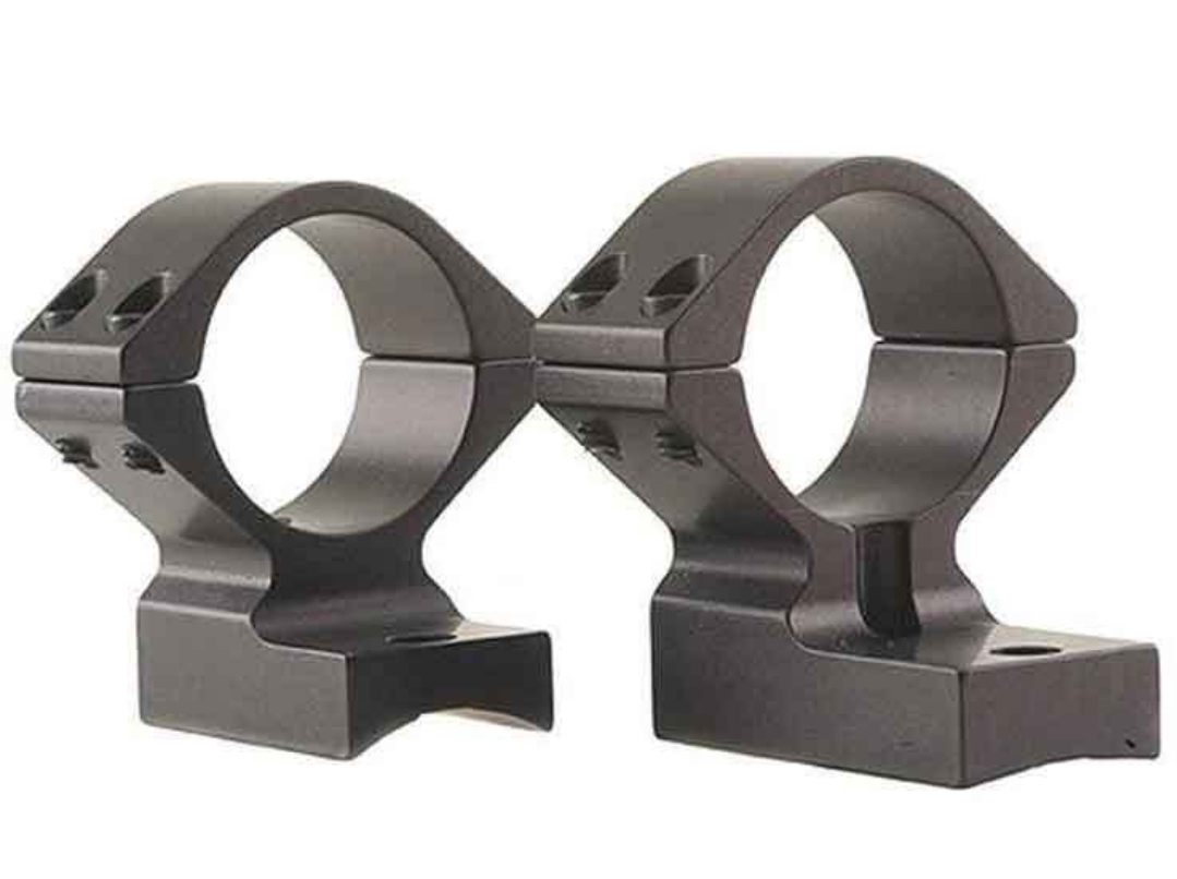

Are you referring to rings like the ones made by Talley?
Like these?
They are really nice if you are looking to minimize weight

I removed the rail from my Savage 308 bolt action and put the Talley rings on to save weight.
