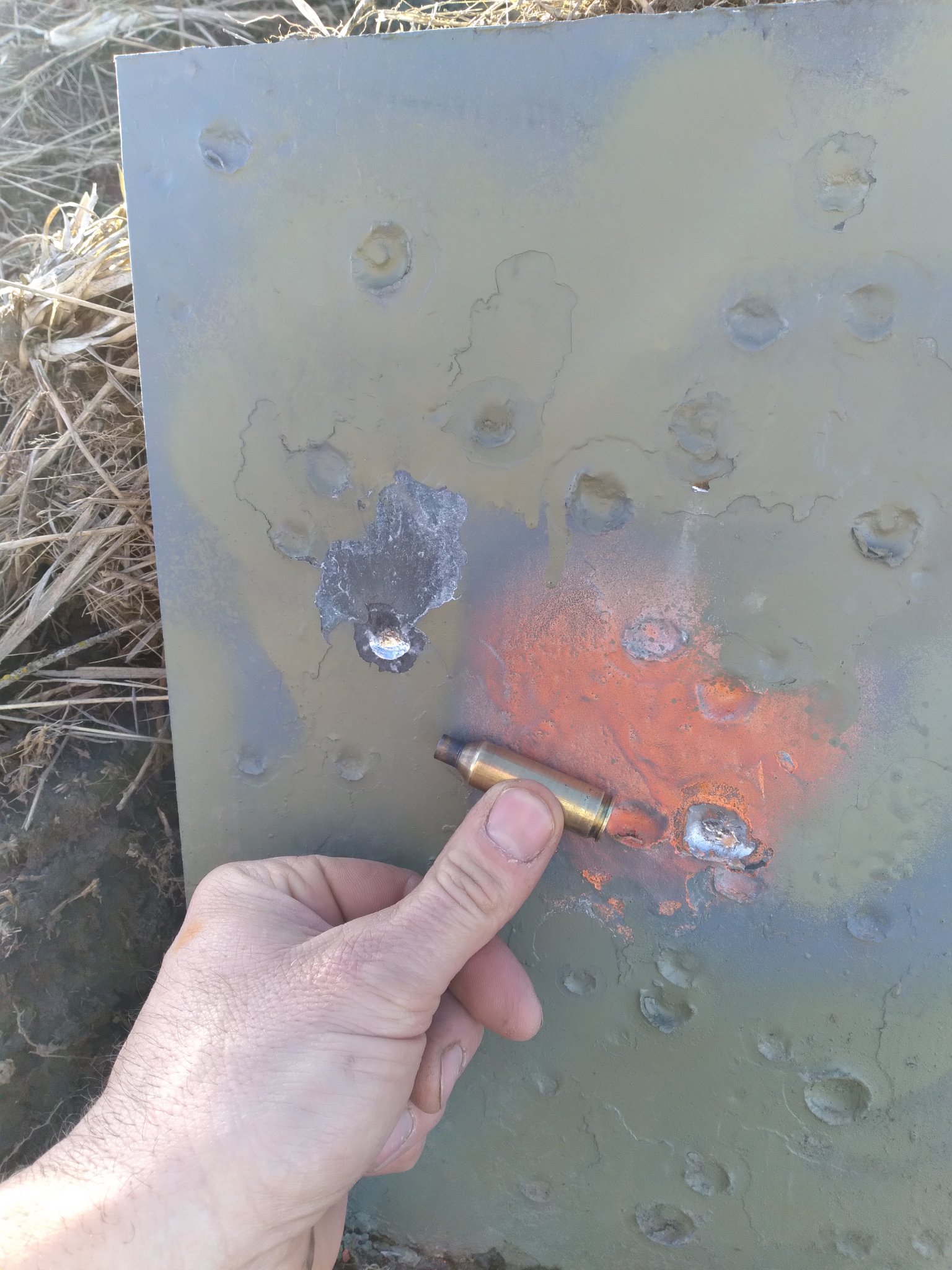

I recently replaced the 25" barrel on my lightweight 6.5 saum hunting rifle with a 16".
I'm sending 156 Bergers at 2840 with RL26, getting 1" groups at 200.
No way it'll ever be longer than 16" again, it has plenty on energy to kill a bull out to 600.

I took the 156's out to 560 tonight, 2 rounds right where they should be I'm loving this setup!
Weighs 8lbs scoped and suppressed
