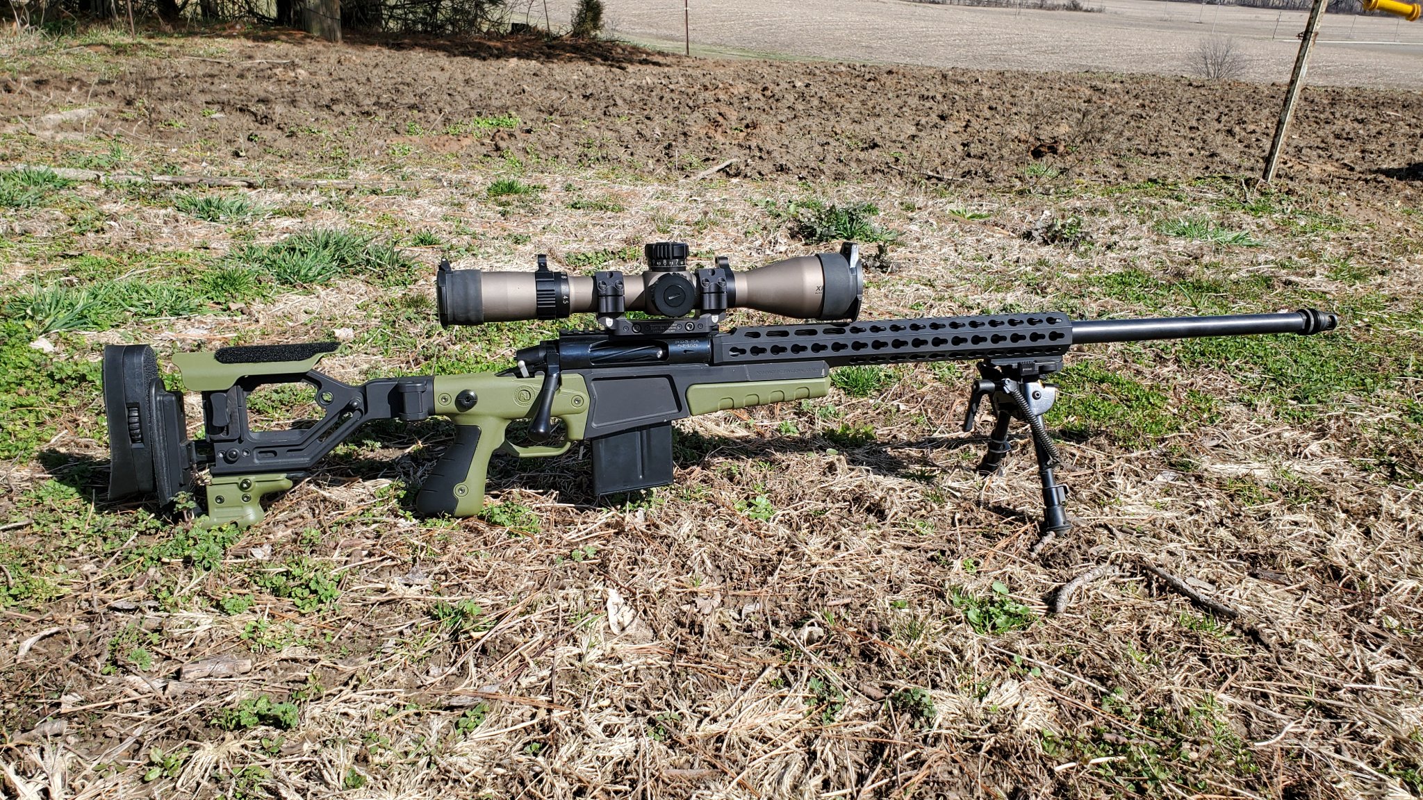

Of the two options that you listed above I would go with the Bighorn. I also like your choice of 223. You'll save a ton on reloading or ammo cost and barrel life is great compared to anything other than 308.
But let me throw in the third option that is very similar. Take a look at the ARC Nucleus and then order a Criterion or Shilen pre-fit barrel from Northland. That will save you the difference between that and the Bighorn right there. You could also peruse the classifieds for a good trigger for a bit less than retail. The X-Ray, which is another great choice, can be had for $450 retail or you can scan the classifieds once again and save some cash there as well. I somehow ended up with 4 X-Rays in the last six months, and I didn't pay more than $350 for any of them.
You're definitely on the right track though.
Reactions: SonicBurlap

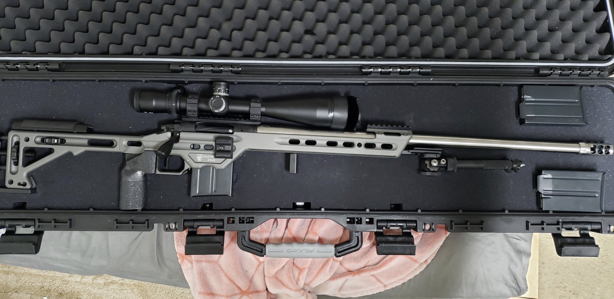

I went Origin with 26 inch MTU From Criterion.

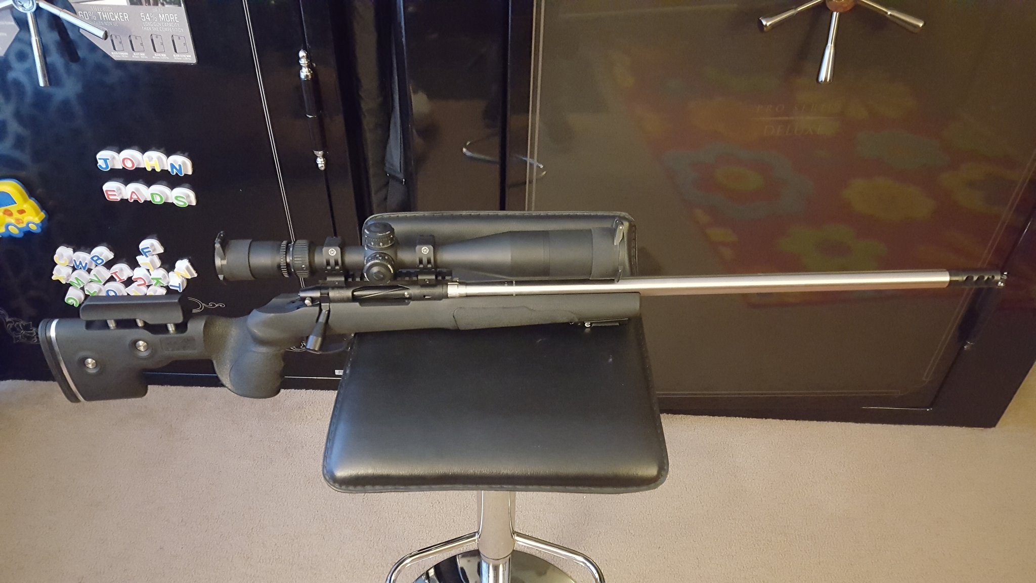

Well. I have both rifles you're talking about.
I have the Tikka Varmint in .223, put in an MPA chassis, Sterk AI bolt handle, threaded barrel and with a Timney two stage.
I also have a Bighorn Origin, in .224 Valkyrie, in a J Allen chassis, with a M-24 24" threaded LHGT barrel. While the Valk is not the same as a .223, it's close enough (in my mind) to offer some advice.
BLUF: Either will serve you well. Arguing the deltas between the two is pointless. It really comes down to feel, and what you prefer.
The Tikka runs slicker than snot. I mean, like on glass rails, slick. It's accurate, well built and well finished. It just flat out works, all the time, every time.
The Origin is a beast (in a good way). It's controlled feed, mechanical ejector action just has a beefier, robust feeling. With it being DLC'ed, rust is a foreign concept, and the bolt runs very smoothly (not as smooth as the Tikka, but still very smooth).
The Origin (being a 700 footprint) tends to have more options for triggers and chassis. The Tikka runs so well, there really isn't much to do to it, other than the Sterk handle (which changes the action dynamic radically, for the good).
The Origin has a lot of versatility for future spit balling with different cases. The Tikka, well, I wouldn't change a thing, even after the barrel wears out it'll just get another .223 barrel.
