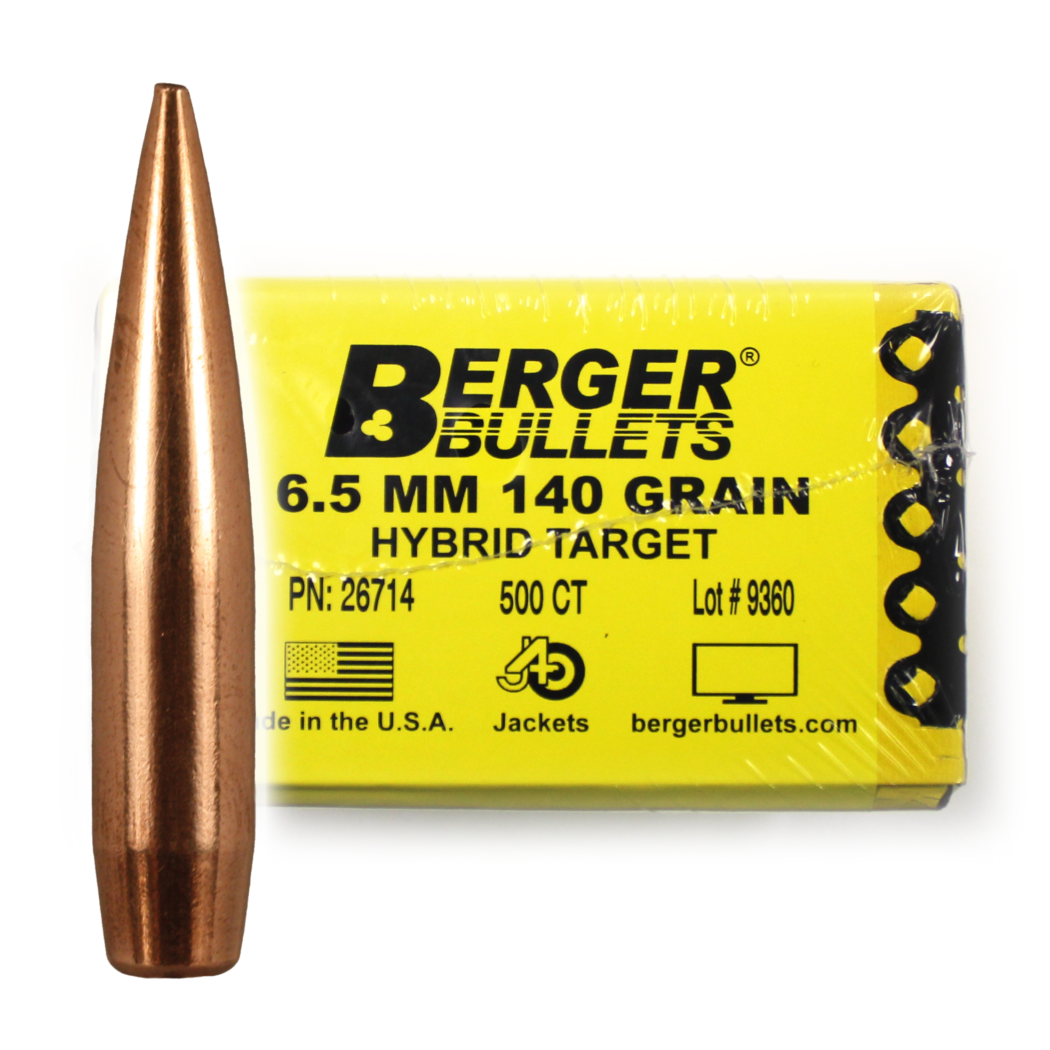

https://bergerbullets.com/product/6-5-mm-140-gr-hybrid-target/
