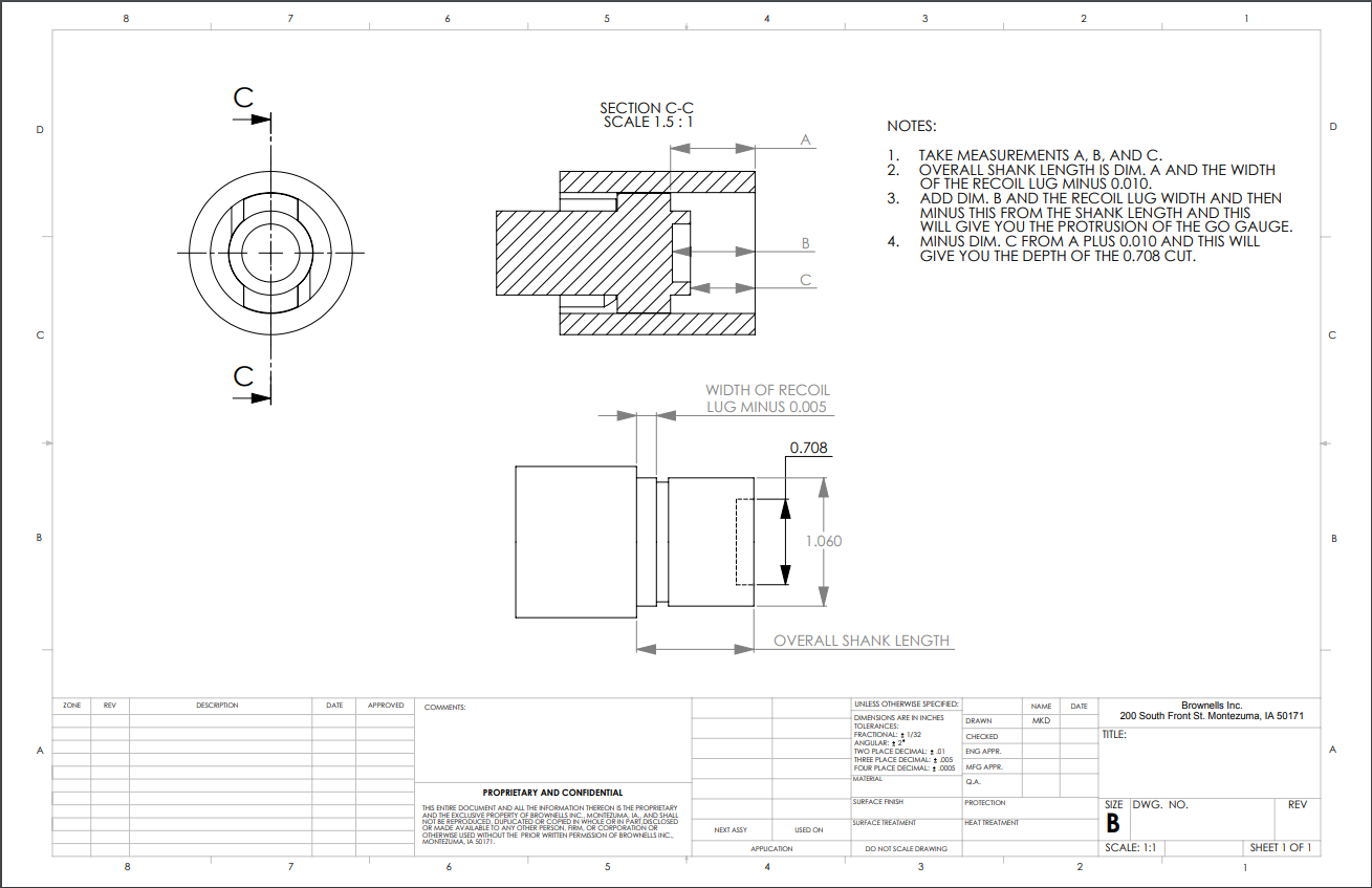

Impact specs
1-1/16-16 3a thread. .705/.150 counterbore. .950 headspace
Remington should be 1-1/16 and thats about where my experience ends. I cant tell you if the remington would properly fit or not, but I can tell you that it will thread in.
So lets try to tie the impact numbers to the rem700 numbers.
Threads should match with 1-1/16-16
Im guessing the impacts .705 is the same spec as the rem prints .708? Which would mean that the rem barrel should fit the impacts bolt nose diameter with .003 of extra wiggle room? Seems like a good fit so far
The impacts .150 counter bore is I assume the depth of the counter bore? That would depend on your particular remington for an exact shoulder location, Im not sure what the remage prefits are cut to for wide accommodation. Could measure the remage barrel to see how it compares.
And I assume the .950 spec is the tenon length? Again, could measure the barrel to see how close it is.
