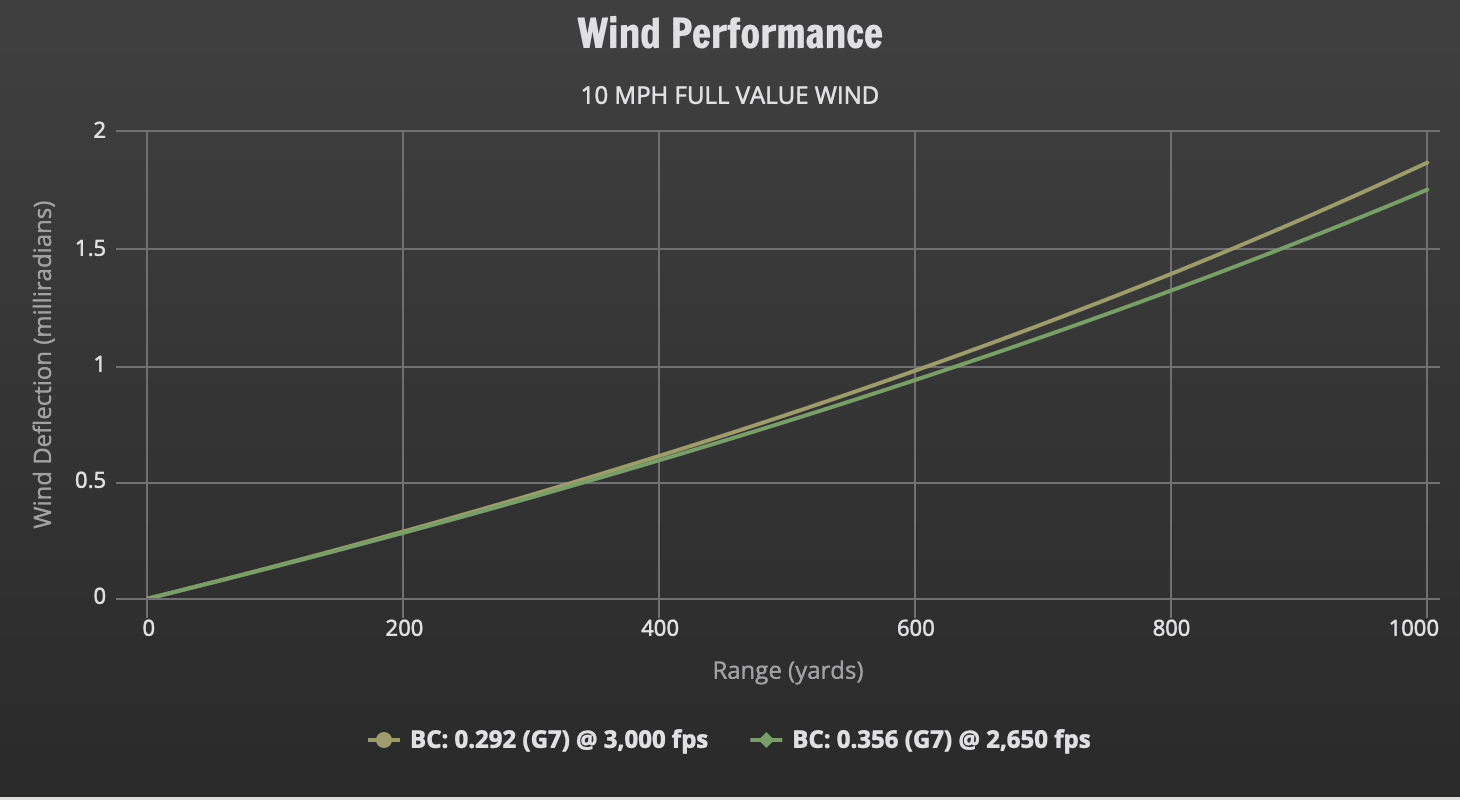

Only reason IMO to shoot 6 creed is if you are slaved to factory ammo. You can download it, but then whats the point? You lose efficiency and have to low a case fill making tuning a load much harder. The problem is there is no real good temp stable powder that will give you a high case fill with 6 creed and still stay around those velocities. H4350, Varget and N140 are going to be most popular.
VS a 6Br/Dasher/GT. Just pick a velocity, jump a berger from .020 to .150 and its going to shoot sub 5sd and 3/8 with no load dev if you know how to reload.
If I had to shoot a 6 creed, thats what I would do. Run the 109 hybrid or 115 DTAC at around 2800-2850. Save barrel life and powder. You will just have to spend more time dicking around trying to find a load that it likes and stays in tune as the throat wears. One of the reasons you dont see many 6 creeds on the line anymore, unless people are shooting factory.

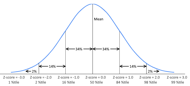

I kept a spreadsheet of my match results for 2 years, beginning with a .260 Remington and switching to 6mms, and calculated z scores to track where I stood in the pack. Assuming regular turn out to the matches with match winners being national level competitors, the same midpack most of the time, and crappy new shooters showing up on the regular, calculating my progress with z scores let me know how well I've been progressing while accounting for crappy conditions, poorly designed stages, etc., vs just looking at my raw match scores.
Understanding that 68% of shooters are within a standard deviation from the mean, a z score of -1.0 means you're the worst of the average, a -2.0 means you suck, and -2.0+ means you're probably the worst. Works the same way in the opposite direction. If your z-score is more than 2.0, you likely won the match, and greater than 1.0, you're likely in the top ten.
Z-Scores from when I was using a .260: (average -1.021)
  • -0.959
  • -1.214
  • -0.999
  • -0.911
Z-Scores after switching to 6MM: (average 0.219)
  • 0.159
  • 0.392
  • 0.106
Z-Scores after getting my rifle balanced properly: (average 0.729)
  • 0.113
  • 1.208
  • 1.311
  • 0.078
  • 0.935
I made a significant improvement when moving to 6mms (1.23 z score values on average) and a further (.51 z score value) improvement when moving to a better balanced chassis. Overall the difference in my shooting improved 1.559 z score points when I made the switch to 6mm.
These scores are for regional matches, and would be lower if looking at national match numbers.
If you're shooting the true average score at matches with a 6.5mm bullet, you'll likely jump to the top ten or top five at regional matches by switching to a well balanced 6mm cartridge. If you're like I was and you're just sucking and well below average at regional matches, switching to a well balanced 6mm is going to land you in the upper mid pack with a few top tens, and a podium here or there.
