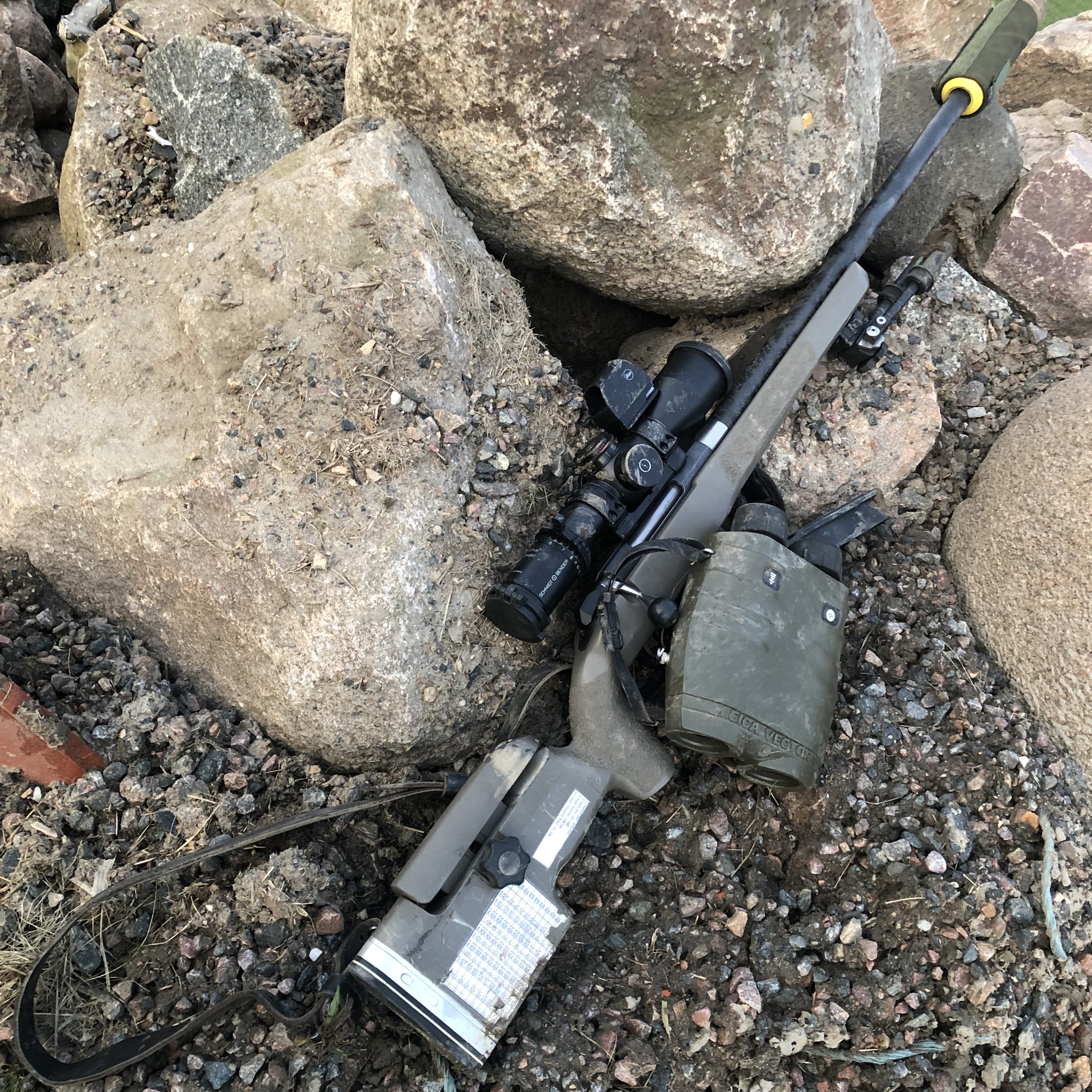

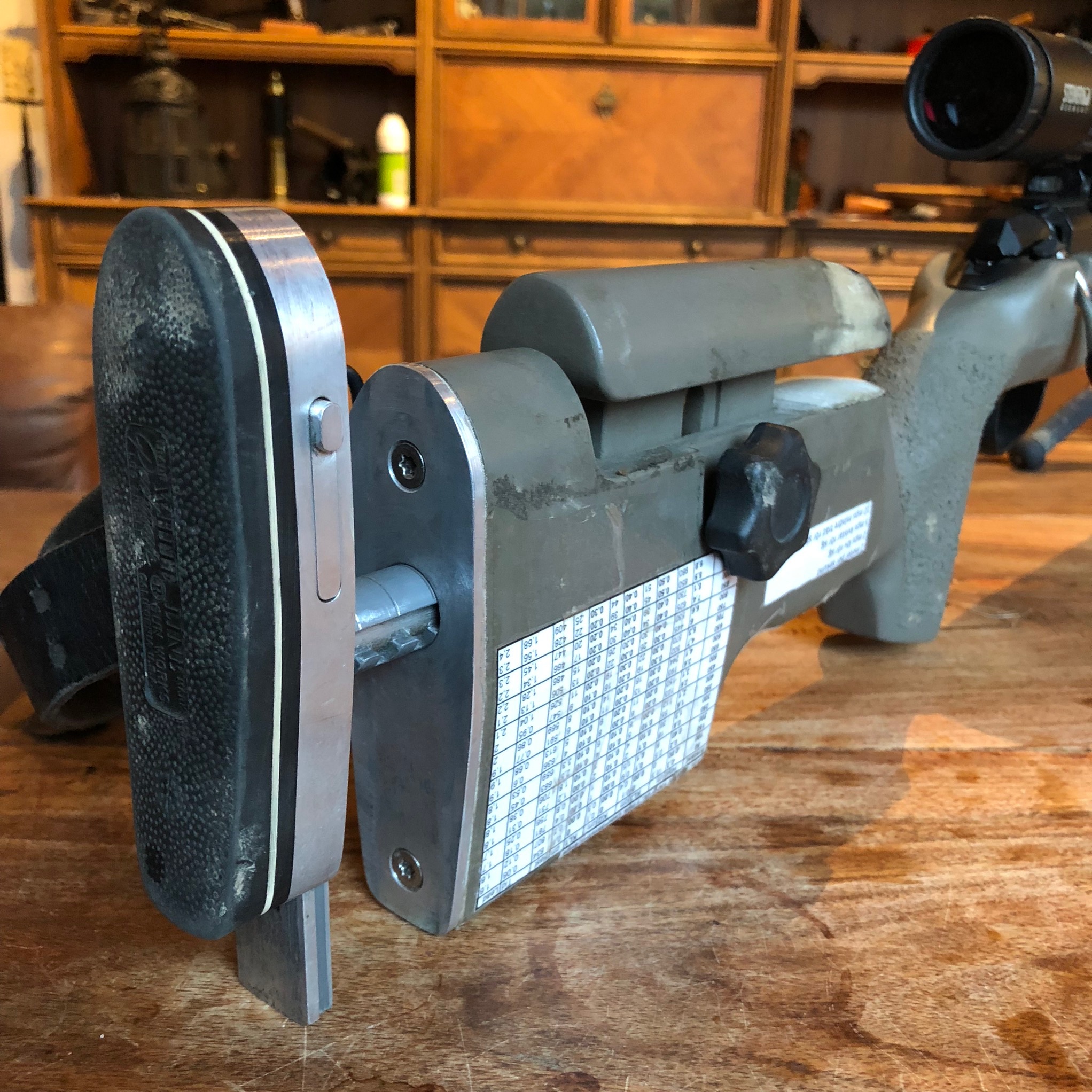

Pictures here is for my main huntingrifle that I made a similar solution some years ago.
This is not a product, its a prototype and it makes my life easyer.

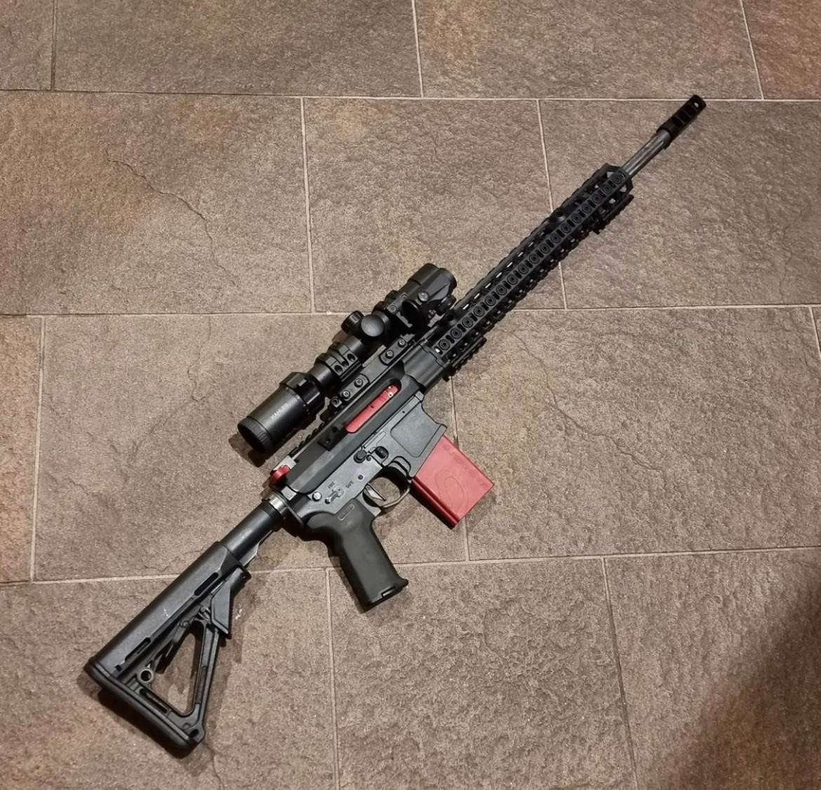

When it comes to the ERS I might and not might continue with it, the basic idea is as good as it was then but there is some issues left that I am less satisfied with.
So I am continue to play with POI issues on AR but temporarily went another route.
Here is one of the prototypes currently in testing
