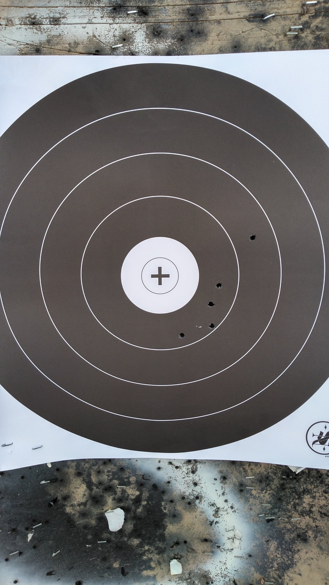

Last winter I experimented with a late 80's mini-14 that I had kicking around to see how much of the notorious accuracy problem was bedding, overgassing, ammo, etc.
This is m193 ball at 100yds after bedding the shit out of everything I could, reducing gas as much as possible for function, and using a burris xtr2 2-10x I had laying around.
This is everything the same but I meticulously reloaded the same brass with varget and 52gr smk bullets. Me and the range officer had a good laugh at it because it's way too good for a mini. Even when I turned the gas off, it still needed very consistent ammo or it would string shots everywhere. Seems pointless to do to a mini, but it's the best example I've seen of why we do the things we do to rifles when chasing accuracy.
