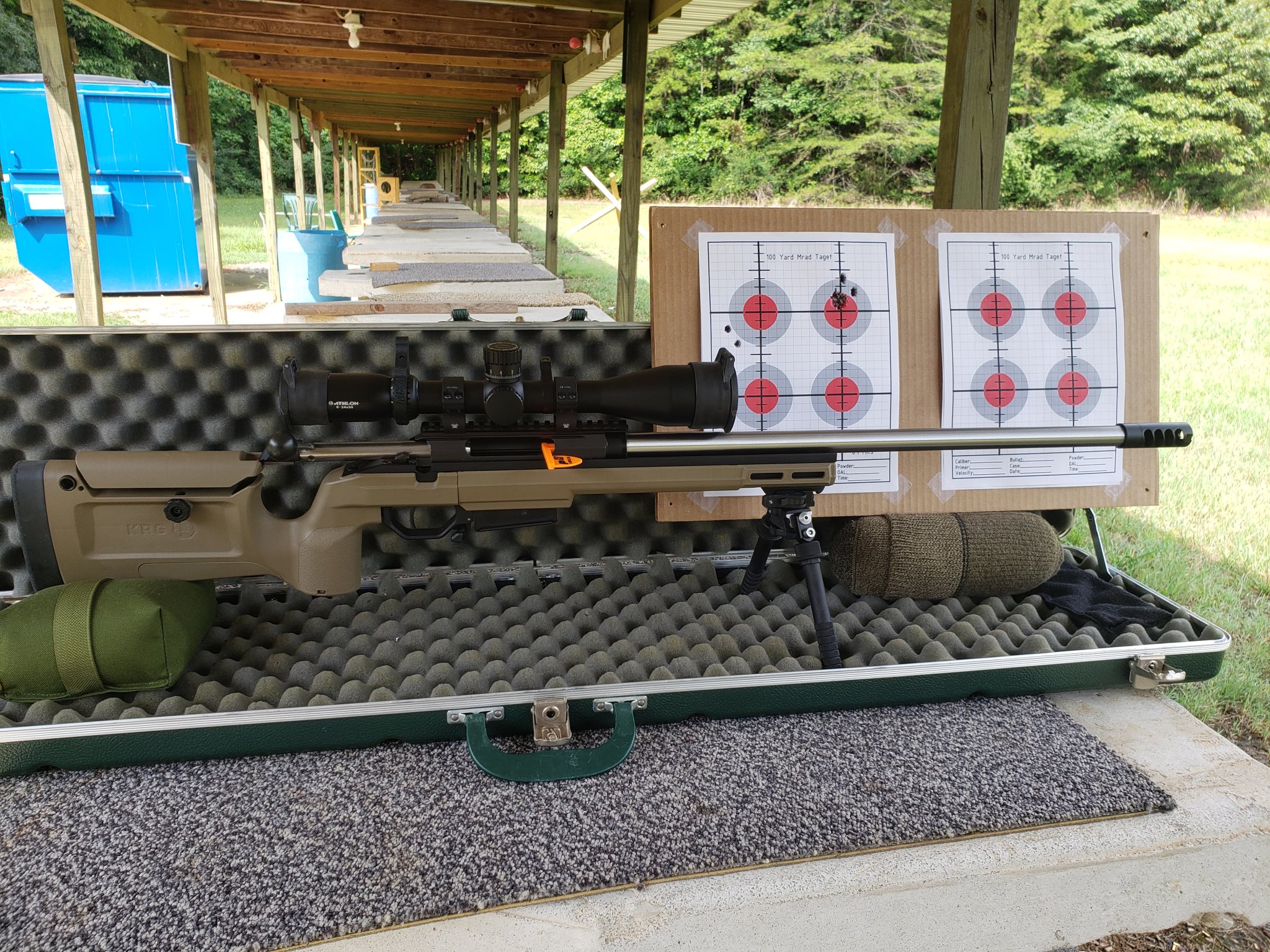

Just working up a load for my .308 rifle using Sierra 2145 165 gr sbt the rifle likes 42 grain grouping at 3/8" at 100 yards.
My question is what would be the best zero distance for hunting and target with the 165gr and possible 175 gr MK HPBT?
