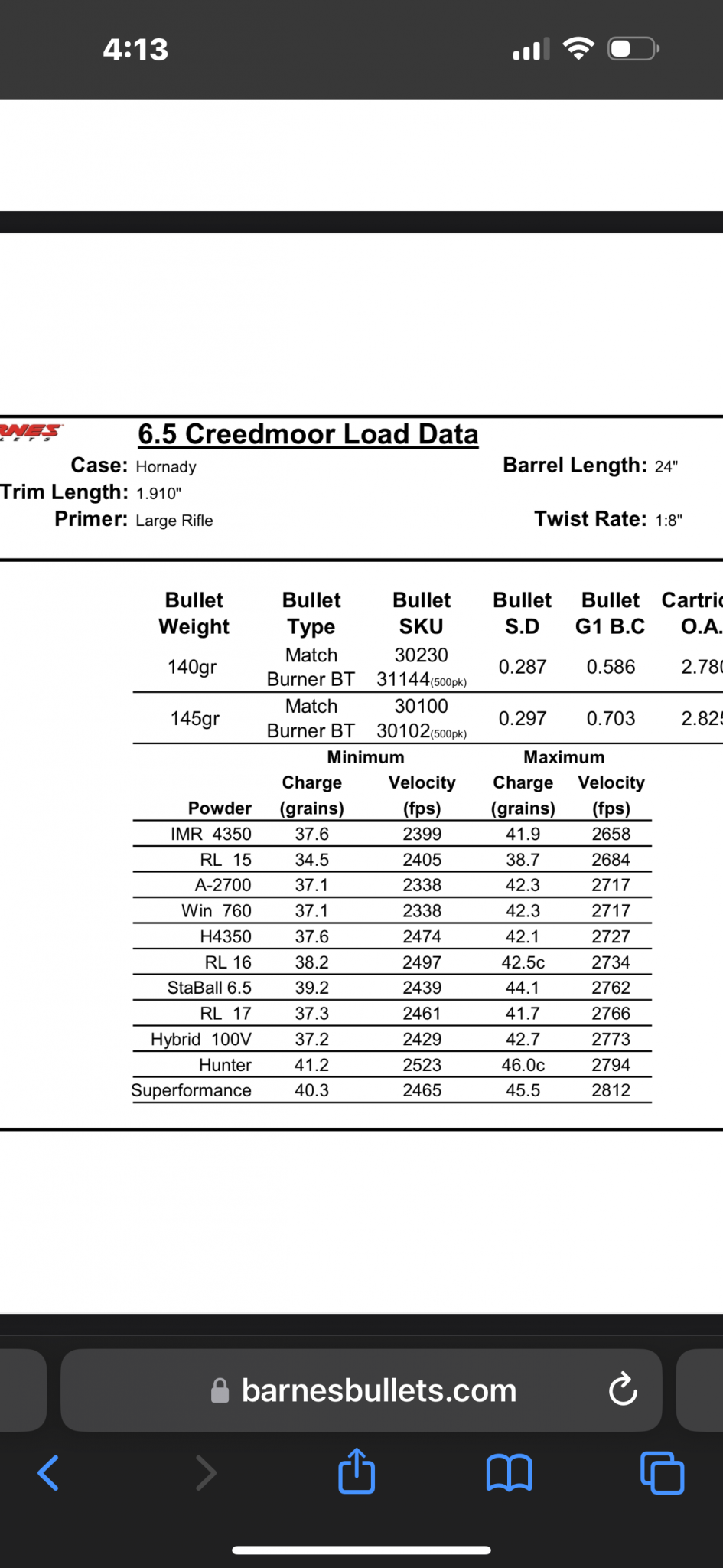

2650 for a Barnes match burner 1:40 max charge of 41.9 24” barrel. Apparently that’s slow… i’ll continue to go up on the charges. I’m at 2650 and see where it goes.

I somewhat Interesting that all the reloading manuals except if you’re using super performance which goes up to like 2800 on the Barnes website the max speed they’re talking when Max charges about 2600 or whereabouts so these 2800 might be over pressured..

It just seems that 2800 is a bit faster than what even the manuals are stating so that’s got to be a quite a bit hotter load than most…?

So why should I have to run my 65 Creedmoor on the ragged edge at 2800 when I can run it at 2700 fps and be happy? I just don’t know how the added pressures will affect the brass primer pockets, etc. if I’m going to be hunting this fall my hunting load definitely will be on the edge as when winter hits the pressure should drop a little bit anyway..
I cant wrap my head around 43gr, im assuming some rifles are tolerant of it but seems high for 140ELD and we're trying to be a PRC then.
That’s what I was thinking holy crap 43 gr is 2 grains overbook max.

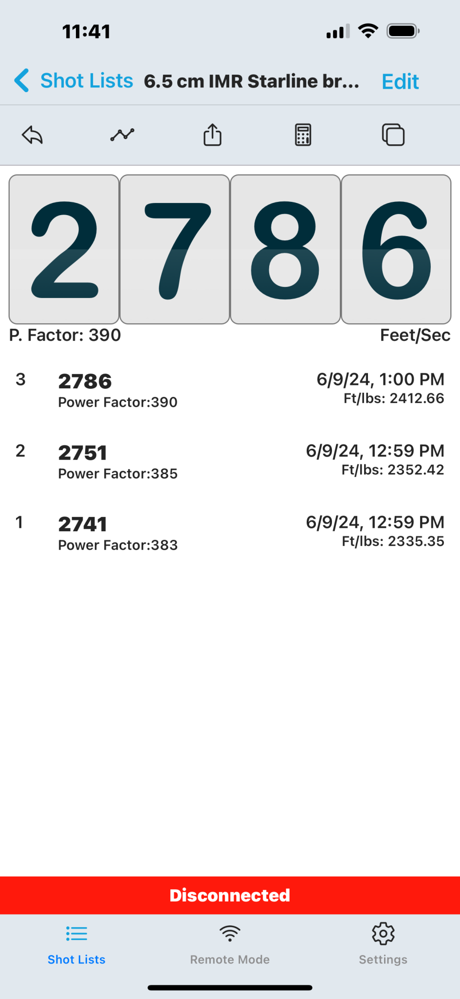

It takes me 42gr of IMR to reach close to 2750fps.
I’ve also noticed that when you get to the 40-42 grains with that IMR 4350, it becomes really stable. as it seems like it takes a full grain to get another 50 FPS out of it?
Or is that unstable at that point when you have higher charges and nothing happens over book??
So that would be about right even with my rifle I would have to use 43 gr to reach a 2800 FPS
