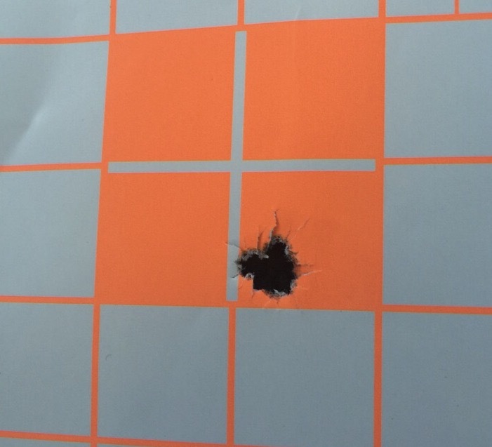

I switched to 4451 a while back for my 260.
no complaints
42.5 of 4451
140 ELD-M
cci#200
243 Winchester brass.
This is from the old barrel.
New barrel is looking promising as well with 4451.
5 shots at 100
