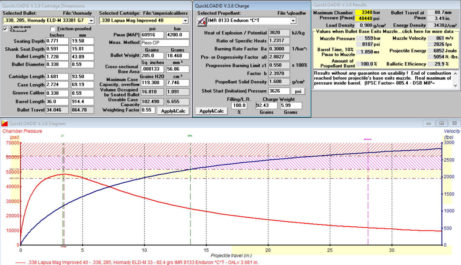

I run a .338LM Improved 40 with slightly larger H20 capacity, so I slightly tweaked my setup in QL to run some numbers for you.

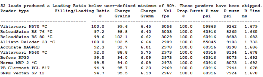

FWIW, N570 & RL33 are probably going to give you the best bang/volume combo, but since you asked specifically about 285 ELDs and IMR 8133:
...and it looks like it's a bit slow for this cartridge, but you're guaranteed to avoid any pressure issues will a full case. The problem is that velocity: notice I'm using a 36" barrel. Faster powders like N570 and RL33 should get you an extra 150fps or so.
So can you load 285s with IMR 8133? Yes, but you're going to get .338LM performance, which kind of negates the point of having an improved case. Maybe just load up a range of powder charges and see if you get better velocity than what's predicted here?
The IMR8133 I have is faster than N570 and RL33. It is only slightly slower than Retumbo.
