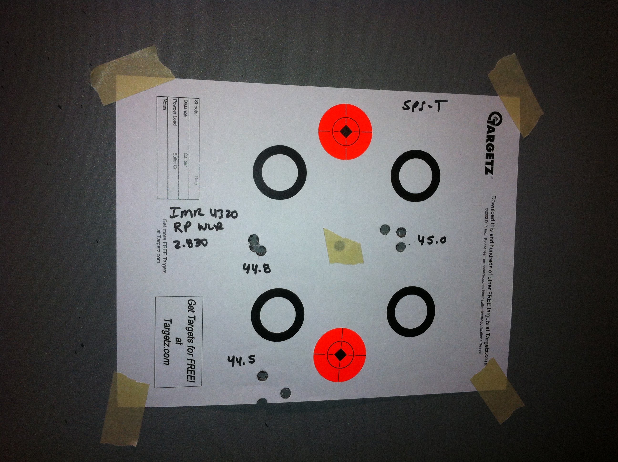

So i ran some numbers in quickload to match velocities of my current RE15 load. Went to the range and shot a very down and dirty OCW.
Was pleasantly surprised, Quickload did match the node pretty well, and the 1/2 grain variance was a little tighter than RE15.
Qualify: In my test all of the groups fell at the same POI, and the end result was the exact same load as my previous Varget load.
Conditions: Indoor range, 100Y, 71 degrees
Load: 44.5, 44.8(best), 45.0 IMR 4320, RP once fired from NOMAD, 168 SMK blems from Grafs, WLR, 2.830
Rifle: SPS-Tac 1:12 20" , Jewell, NF 2.5-10x32, McMilan HTG
Now, I do not have a chronograph, so I can not give actual velocity, I calc everything based on drop. Many folks do not prefer this powder as they state it temp sensitive. I am sure it is, but will take it out on the field and test. This weekend should get down to 32 in the morning, so I will try that. The warm weather will have to wait until summer.
Now as far as my 3 shot groups, its what I shoot for testing.
Summary,
I am pretty content with the results, I made up a pretty reasonable load using blem bullets, once fired brass and a bastard powder(only $23 a lb). Shoots as good/better than FGMM in my rifle. So for those who are low on powder, might want to give it a try.
