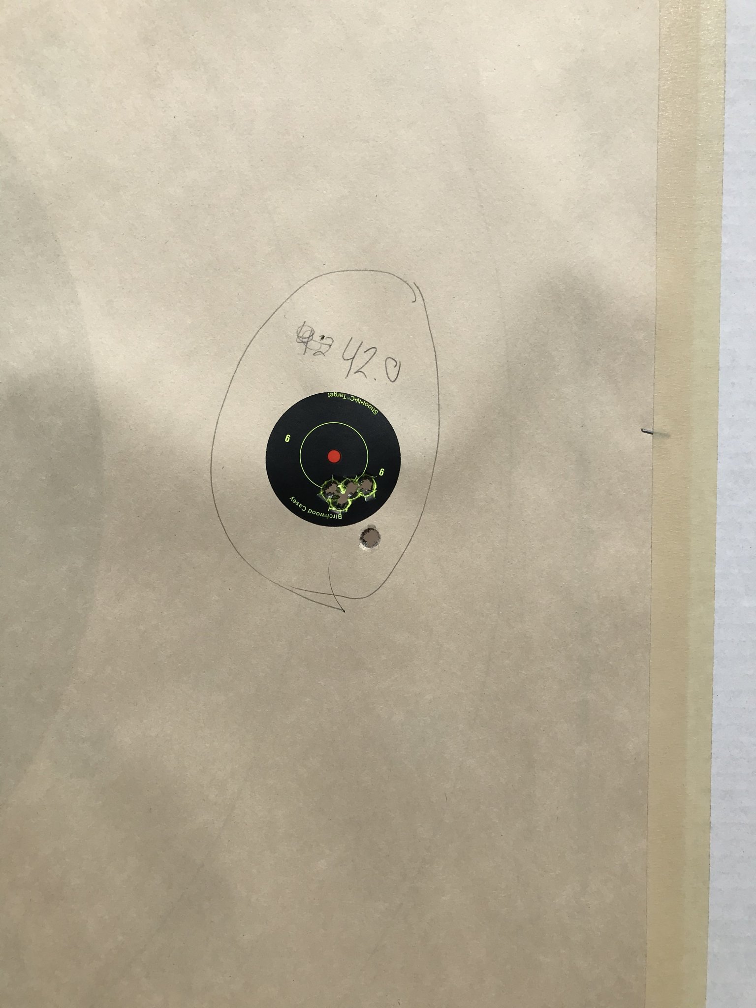

This is my ocw target where I chose 42. I adjusted my seating depth to an over all coal 2.795 and my groups got tighter. Next time I’m out shooting groups I’ll take a pic, I have not shot paper in a while.

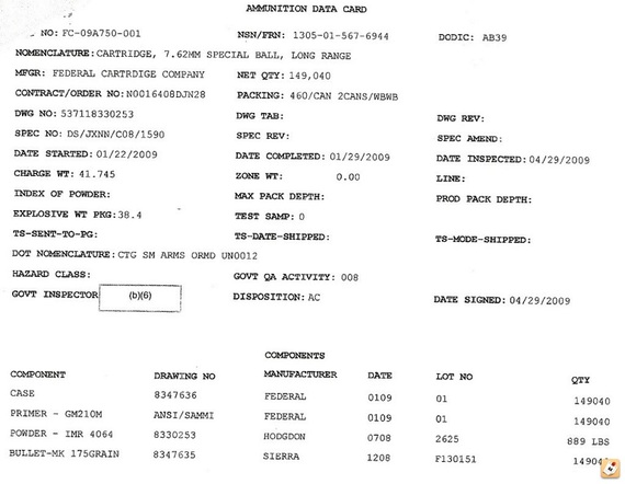

You should have good results with either powder. 4064 loads around 42gr mirror FGMM from a few years ago but Federal is now using a different powder. 4064 has shown itself to be very temperature insensitive, especially in 308 and on the upper end of its range. If your barrel is less than 16” you may need to rethink both powder and bullet, going with a faster powder and lighter bullet.
