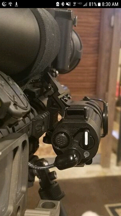

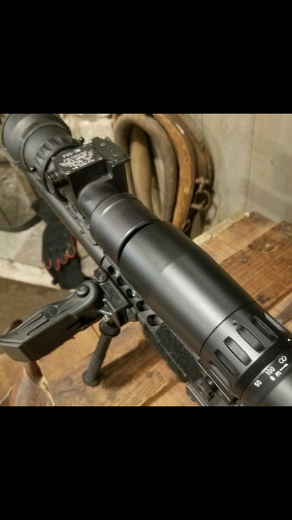

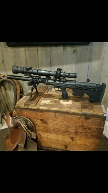

Military trade-in AN PVS-30. Do it! They are $4,700 at Eurooptics right now. Ready made resources might have them as well. Both great sources. Insane unit.

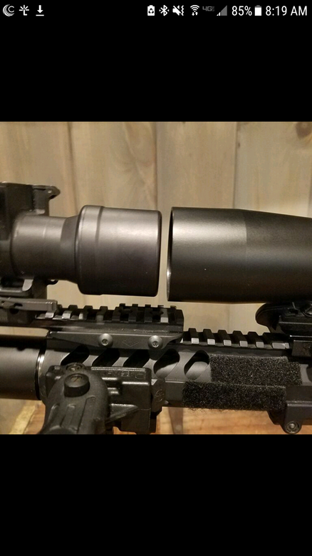

They perform perfectly, no tunneling, down to 4 power. They are designed to run with higher powers. That's what makes them so awesome.

I think you misunderstood my post, the tunneling is BELOW 4x with 1-X optics.
Understood, I would expect tunneling on 1 power. Not sure how well it would even do on 2 or 3 power. Initial question was inquiring about 600 yard shots, so I'm not sure tunneling would be an issue for the guy inquiring about unit. Thanks for clarifying.
