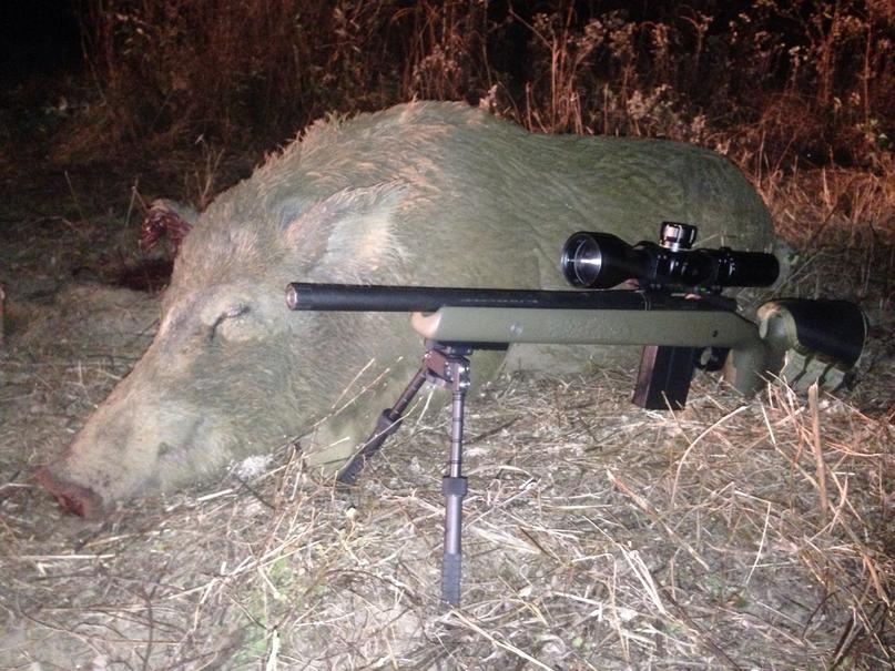

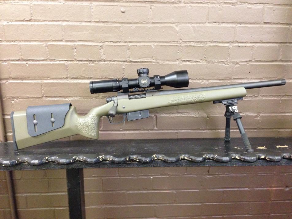

Ill post a couple pics now but I need to get this thing photographed better this week and I will update it.

That's kind if like the gun I hunt with now. Mine is heavier because of the G2DMR but I love it. Wouldn't mind having that scope for a handier rig, it's exactly what I was hoping they would do. I thought about the 3-12 G2 but this looks even better for a hunting gun. Reticle looks great, a lot like the G2 but addresses some issues for low light or up close hunting. The 4-16 sounds good also.
