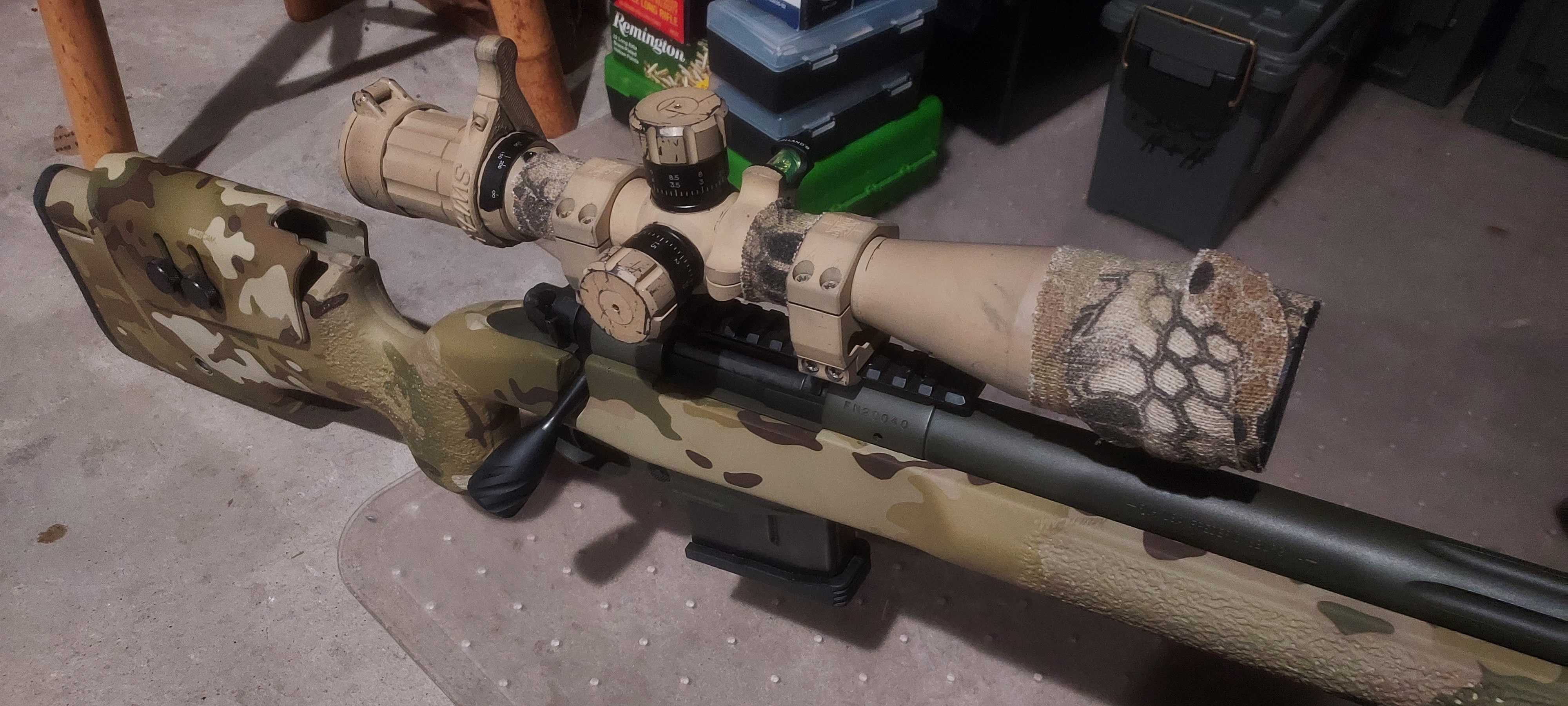

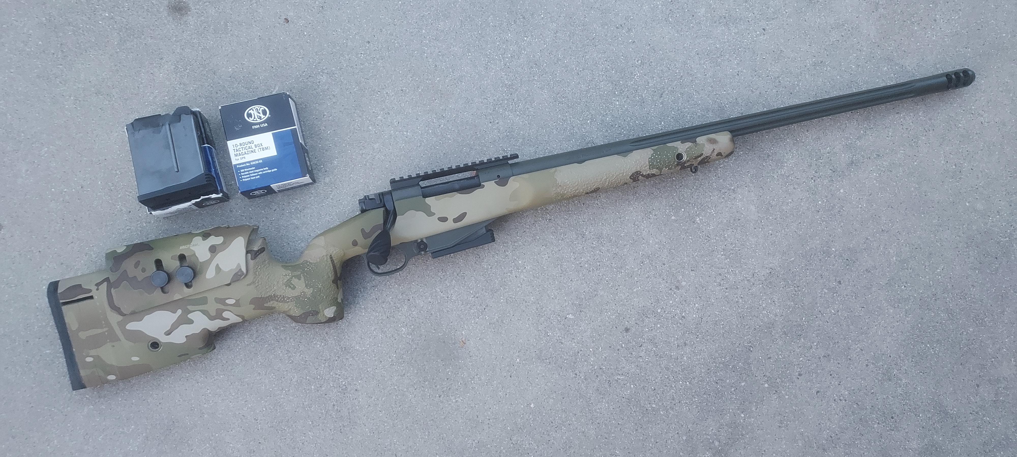

With that in mind I'm using the following hardware:
FN SPR A5M
SWFA SS HD 10x42

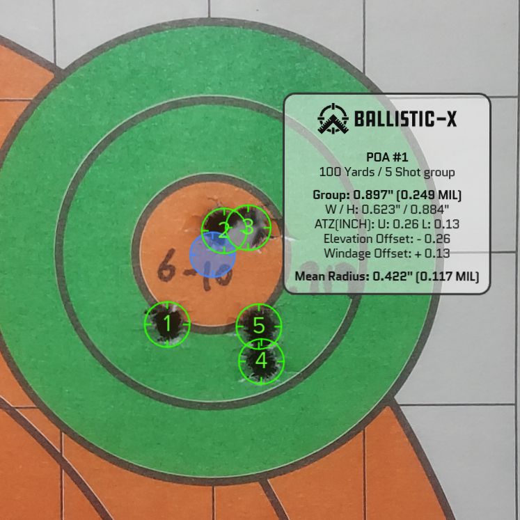

I already spent 10 of my shots getting a zero and confirming it with a 5 shot group (I did go through one box of 168gr GMM getting on paper and centered). Here are those 10 shots at 100 yards.
In hindsight I may have wasted shots 6-10. I really wanted to see what the gun was capable of with this load so I took my time, but I had already sighted in two other rifles and my eyes were having problems really resolving the orange in the middle of the green. Regardless, this is how that group panned out.
What it did provide me with is an OK pool of shots to pull velocity data.

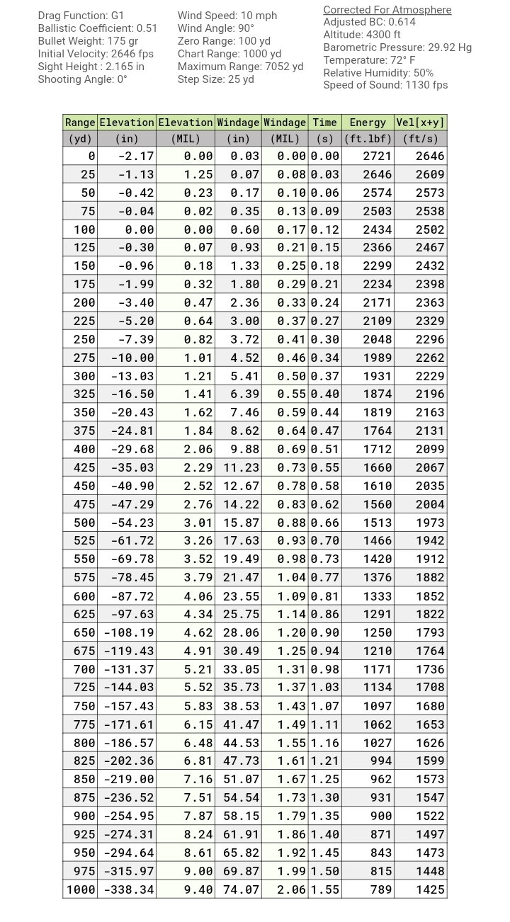

I plugged that in to get a starting point on my trajectory.

Also - we only use g7 today for BC it’s much more accurate for these long pointy bullets.
With all that in mind you can go right to 600-700 yards to true up your ballistic table - keep in mind bc on the box is an estimate and may change slightly at the speed you’re actually going but will get you pretty close.
