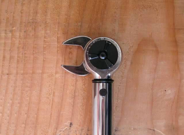

If you keep the wrench handle at 90-degrees to the crows foot opening, the difference in torque values are negligible and you don't have to compensate.
crows-foot-torque-wrench-a-its-an-open-end-wrench-head-with-a-square-ratchet-drive-opening-cro...jpg
Or if you really want to do it straight on (or have to due to some reason) use this equation in the link to calculate the difference. https://www.engineersedge.com/manufacturing_spec/torque_wrench_1.htm
