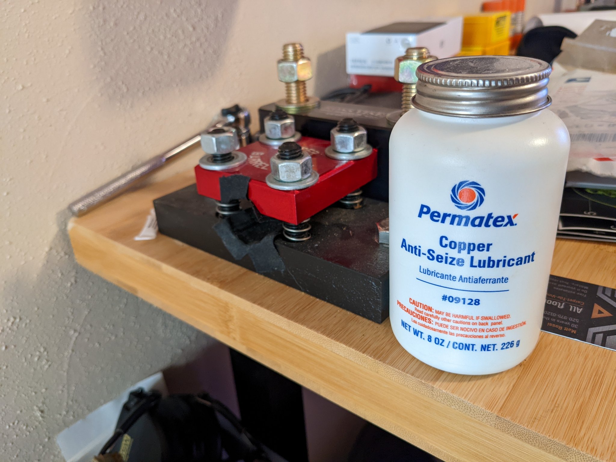

    I've used both nickel and copper antizieze on barrels for my own rifles. I stopped using it on client rifles (and my own) because the tiniest little dab of that stuff in the wrong spot means you need to take apart the entire custom rifle and wash the darn thing off with solvent to clean the errant dab. It's probably what it would be like to give the Tin Man a handy...
    I bought a little thing of the copper antiseize because it looks cool and is all shiny but Ive also used normal auto grease just as much. Ive even put one together dry out of impatience, it worked fine and couldnt feel it grabbing at all but I wouldnt make a habit of it.
    What do you have stuck to the inside of your barrel vise? I've been using small pieces of paper but its a PITA.
    I just use my old business cards, pinch it around the barrel and then slide it in and it seems to stay folded around and slides fine, no longer in that position so I have 500 barrels to swap with old cards :ROFLMAO: Easier than the toilet paper tubes I tried that were all too big until I tore them down and they suddenly became too small.
    Prolly so.
    But to that I say, why use copper- when there are other products available (including nickel) that don't contain it, negating any potential issues?
    There certainly may be better alternatives, I'm not an expert on this and I'm not going to pretend that it's the only/best solution for this application.
    I know its worked for me for years, I haven't had issues and it seems to work for its intended purposes. I know many others use it as well. But there's many options out there, and perhaps nickel anti-seize and other options are in fact better for this specific application.
    I've tagged in others that are much more knowledgeable than myself in this. I see @bohem has already responded, which I appreciate! I'm looking forward to hearing opinions and learning more about this topic. Perhaps I need to switch up what I'm using, or maybe when I empty this bottle I should try something different.
    Reactions: rijndael
    The loads aren't heavy based on installation torque but the dynamic loads generated during firing can be fairly high. It's hard to say from that information what Henkels determines as high load though because there are 1" bolts that will carry >100,000lb loads and there's nothing in a shouldered fired small arm that generates loads like that.
    We use M1-A grease by LubriPlate purchased from Brownells for installing pretty much everything. Brakes, barrels, barrel nuts, scope ring screws, etc. Yes, scope ring screws do need lubrication in certain areas. We use it for ARC, Zermatt, Lone Peak, Impact, Curtis, etc actions. Anywhere stainless steel threads are involved gets a healthy dose of the stuff.
    @bohem what would be the wrong spot that would require it to get cleaned out?
    I use nickel-based anti-seize because barrels and receivers are often stainless steel.
    Copper-based anti-seize can cause issues with stainless.
    From Henkel/Loctite website:
    However, it is important to remember that while many compounds exist for stainless steel, copper anti-seize on stainless steel will create inter-crystalline corrosion which can cause parts to crack or break when under heavy loads.
    Didn't know that ... thanks!
