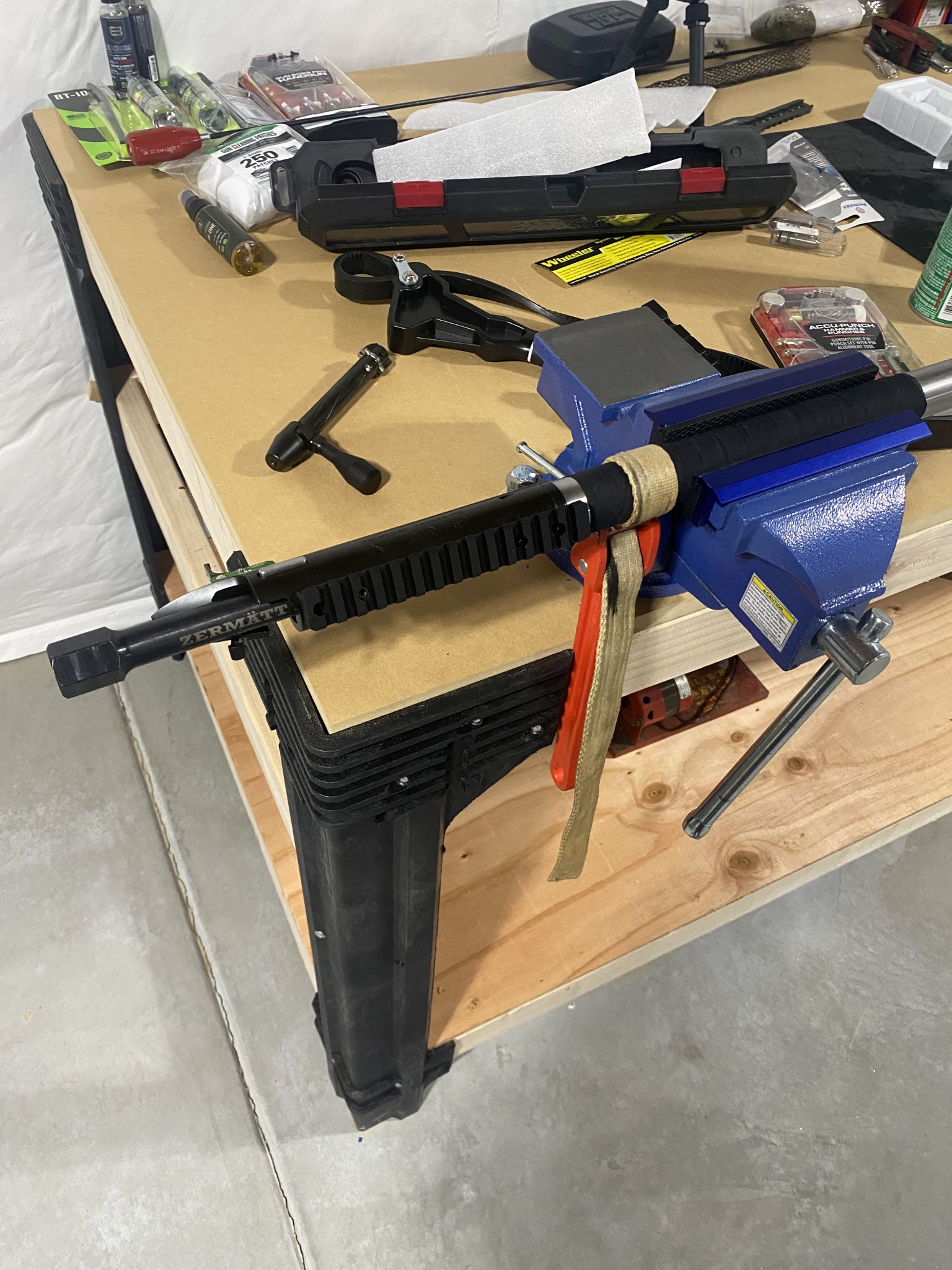

Today was my first time installing a prefit as well. I stopped by Napa and got a .5 oz tube of nickle anti seize for like $4. Of course my barrel vise was delayed so I had to get creative to make it to 75 ft/lbs. picked up some lacrosse grip tape from Walmart and threw it in the soft jaws with a strap wrench for backup.
