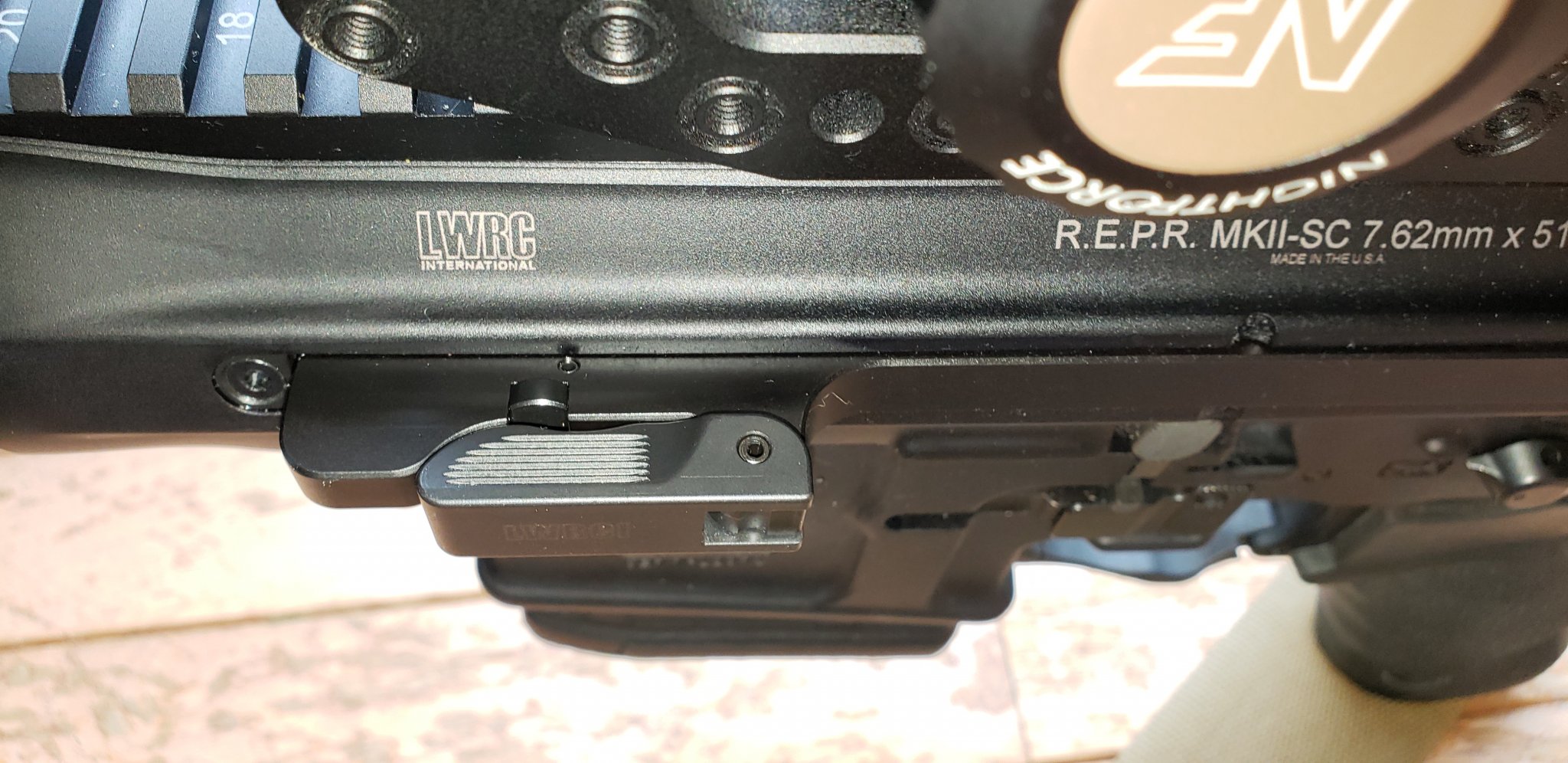

The wrench would need to be custom made plus you have to heat the upper to release the barrel from the thermal fit. I was going to cerakote mine as well , I asked LWRC about getting a folding side charging handle but he said it wouldn't fit the MKI. This seems strange since the bolt carriers are interchangeable between the MKI and MKII.

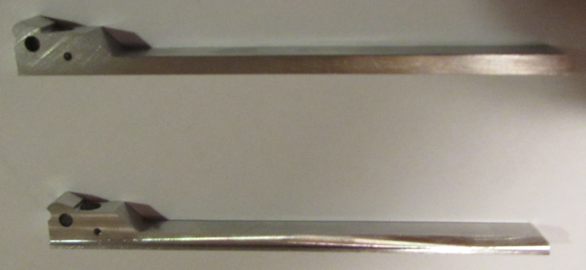

so far only got payment from a Ben Rybla. Cut all the 7075, got them all to length and almost height ( extra material I had to cut that mill said they couldn't get me smaller amt of material) and next to width then drill holes rough then finish profile and then to cut the knobs, make some pivots plungers, and lugs.

forward assist is a big pita to design so that you don't lose that slim FCH design. Have something in my head but that is it. Nothing on paper/digital 3D yet. That MK II will not work too nicely with these L1A1 type FCH as the knob likes to grab the front of the rails, and that fixes the non reciprocating charger. problem is it looks like the MK II has no protruding rails, but the rail is flush with the handguard.

OK guys this is the right time to send in those funds. I have 5 extra handles in this run. Have the slides finished just need to get the knobs cut for the rail and make the lugs. Then park the steel parts and anodize the aluminum and ship. Hope to get all that done by the end of this week.
Reactions: Zelwell
Looks like after this will work on FAL T48 chargers and then will get back to REPR LAW inserts. If I am lucky will get the Mazak running and if I ain"t then will have to make these manually on the meager lathe I now have running. Kinda sad I only have this 1HP lathe
or this 20 HP without the power to it
Top one takes more than an hour each bottom one like 10 mins ( not counting the programming time) max each.
