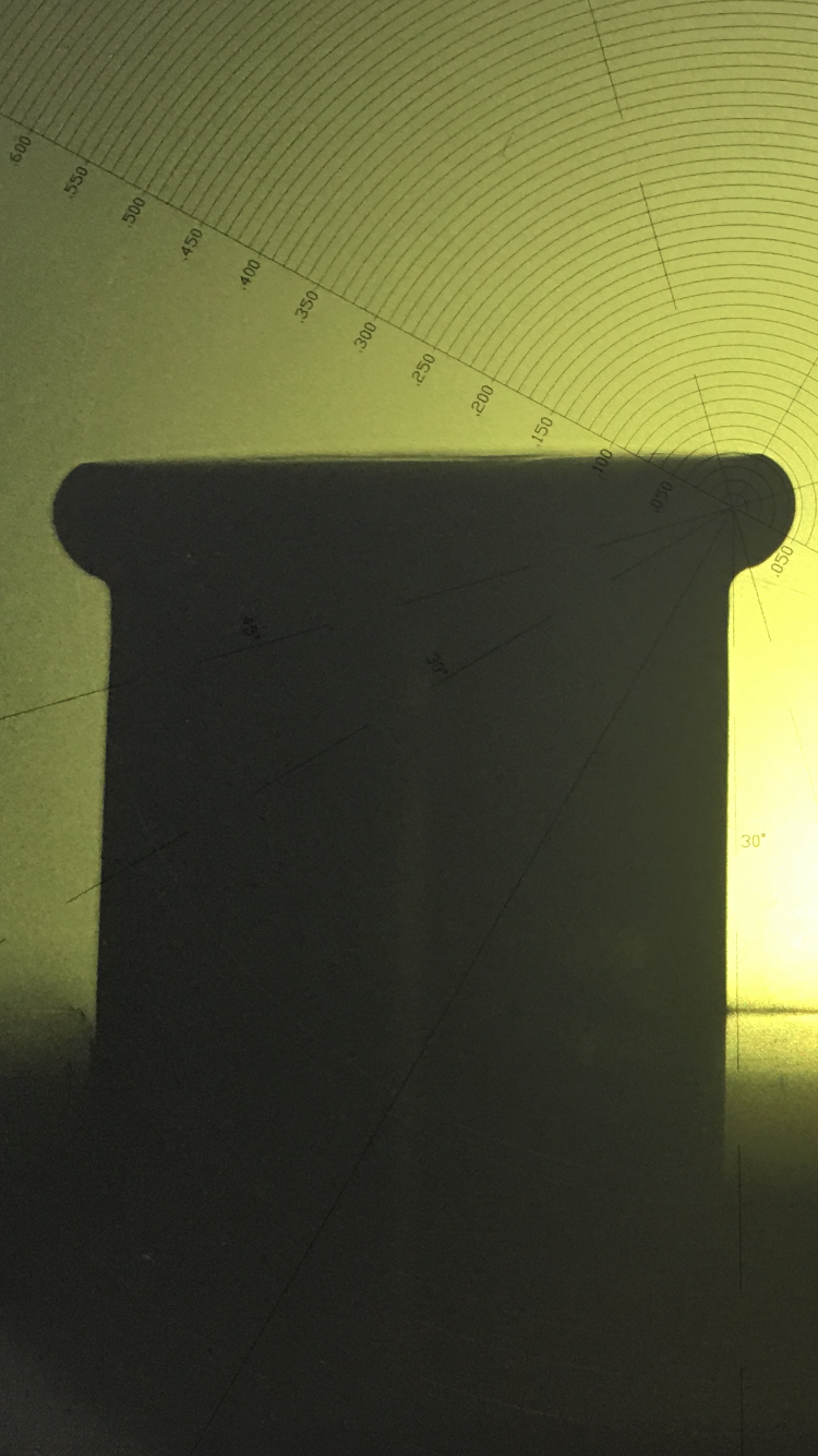

He said he measured the rim at .045 on the Center-X. Funny I get closer to .0414. If he cannot get this measurement right, how can I trust the rest.

The rim thickness on Eley and Lapua are different. There are different methodologies I've read around how much your headspace should be, and if you want it exact to your rim thickness, or if you want to partially 'crush' your rim. I've heard of different things, I don't know.
I think the rim thickness for Center-X is .041 and for Eley it's .039. SAAMi spec is .043. When I used to do my own headspacing with my Tikka T1X, I would change my headspace for when I shot Eley ammo or when I shot Lapua ammo to get the most out of accuracy.
