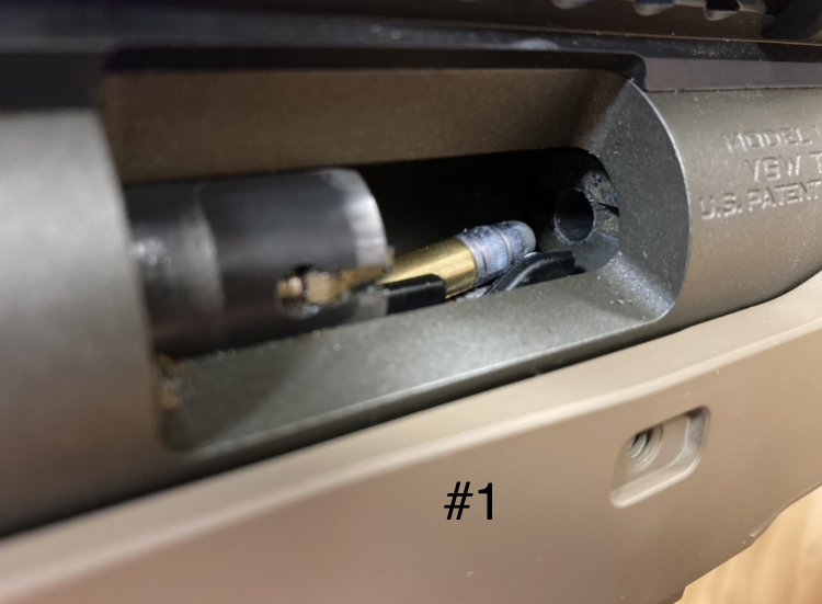

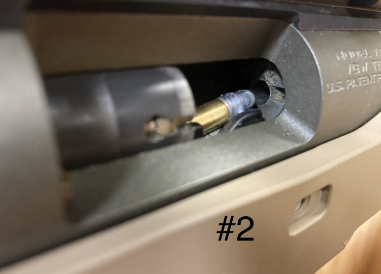

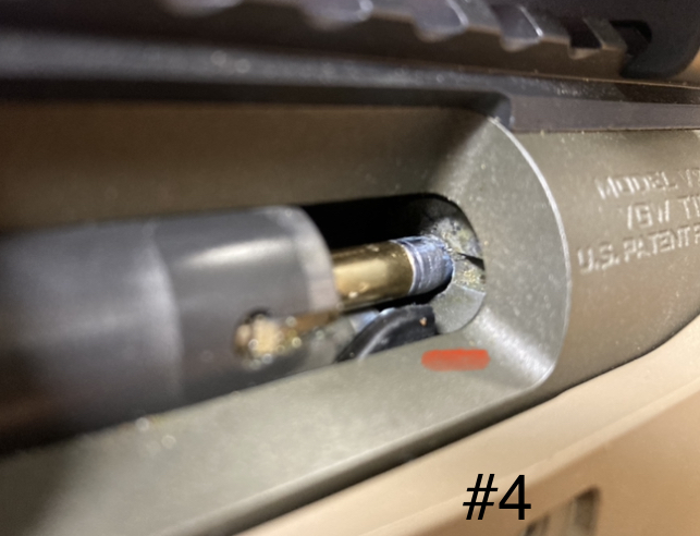

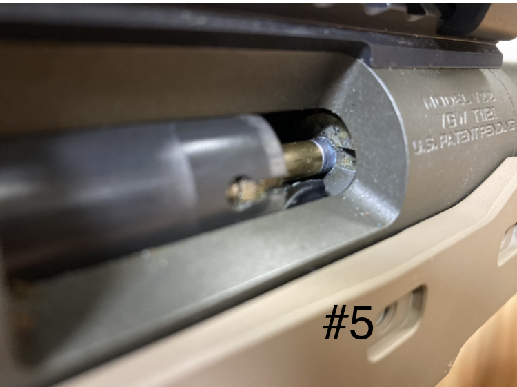

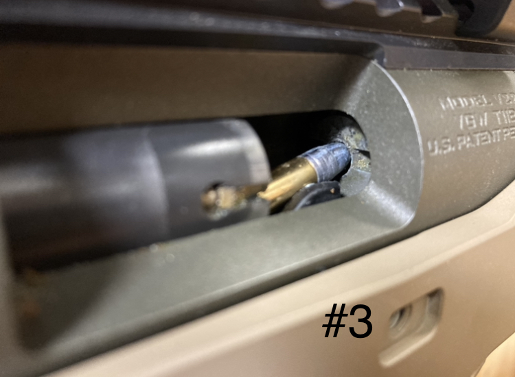

A friend just got a Vudoo barreled action. He had some feeding problems, until talking to Vudoo, and adjusting the mag catch, ok now.
One thing about the videos. he could have just set the barrel back a turn or two, to get the headspace correct.
Yup most feeding issues are mag height issues with chassis. Usually pretty easy fix.
As to the video, I highly doubt Vudoo sent a rifle out that wasn’t headspace properly.
I love my vudoo and I would never tell anyone not to by one..I saw so many issues this weekend at the shoot with Vudoo's I questioned that a little.. I was glad I had a Gen2 and not a 360..Feeding issues galore, I saw one that the bolt catch broke on, and it messed up his receiver..the kicker is he just got back from sending it in to stop it from shaving lead off the bullets when loading a round..I know if I was spending 3k on a gun, I would only trust my money with Vudoo because they stand behind their products 100 Percent, every interaction I have had with MB has been great, awesome dude! but something is going on there..I am sure they will figure it out. I will say none of the gen1's had issues..
There were a bad batch of 360 mag catches and they are getting replaced. Were you at NVGC? Also the early 360 did have an issue with feeding which Vudoo fixed in line during production and none of the new ones have it.
The shaving lead sounds like a mag height issue. Saw one on facebook. I think it was the same guy.
Yes I was!! Do you know how many times Derricks gun was sent back to be fixed? I only mentioned one in my post above to be nice..Jonathon did fix the vudoo enough to get him thru the match but the receiver is still damaged and must be fixed is what I was told. Like I said, I am a Vudoo Fan and I hope they fix the issues..If you buy a complete gun, and wait that long, it should work..If you get a BA and try to put it together I don't see how that can be Vudoo's fault..Derrick's gun was a complete gun from Vudoo.

Here’s the sequence.
