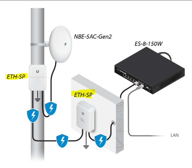

UniFi Air Fiber 60
You would get one of these for the house and one for the shop, pointed at each other. This will wirelessly beam your house network to the shop. You would also need access points in the shop because this just bridges the connectivity to the shop—it isn’t something phones or computers or cameras would connect into directly. These are way more reliable than WiFi across distances longer than 75 feet.

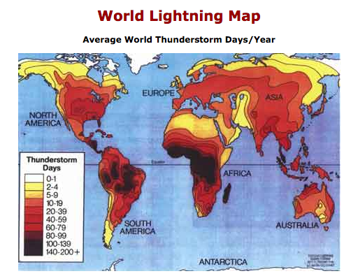

Depending on where you live, if there is substantial Summer lightning, avoid any low-voltage metal cable between buildings (Ethernet).
I live in Florida. Lightning capitol of North America.

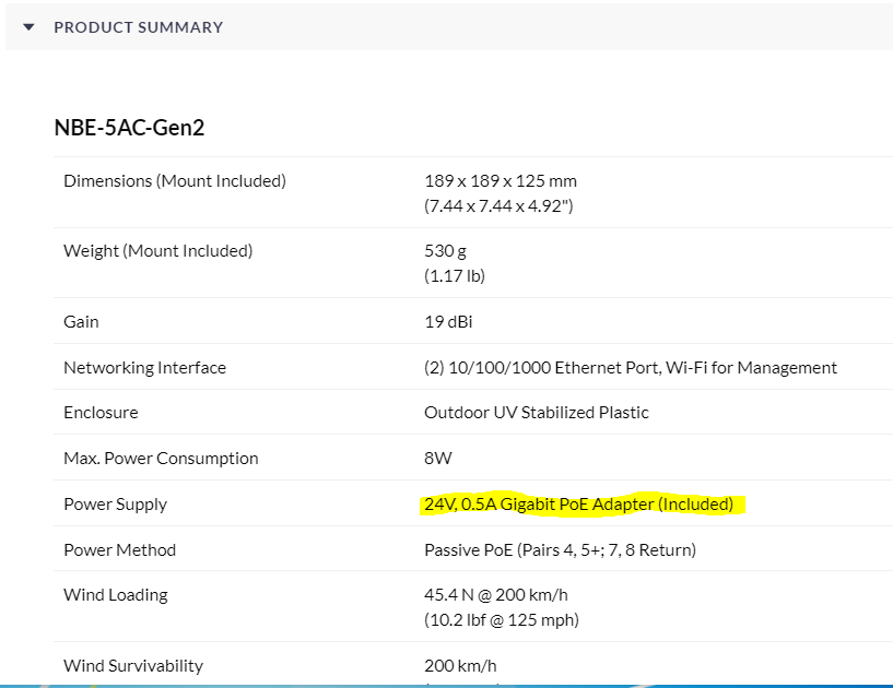

Can someone confirm, in order to get internet with available ports to a barn from the main router at a house, I would need two of these...
And one of these...
And some cat6 cable obviously. I'm not sure I'm reading it right but it seems like the nanobeam has a POE injector included in the specs.
Highly recommend the surge protection if your in an area that gets lightning. I'm in Texas, every device that is outside of a building here gets surge protection.
Yes the nano beams come with POE adapters. Got a pile of them in the shop right now....
