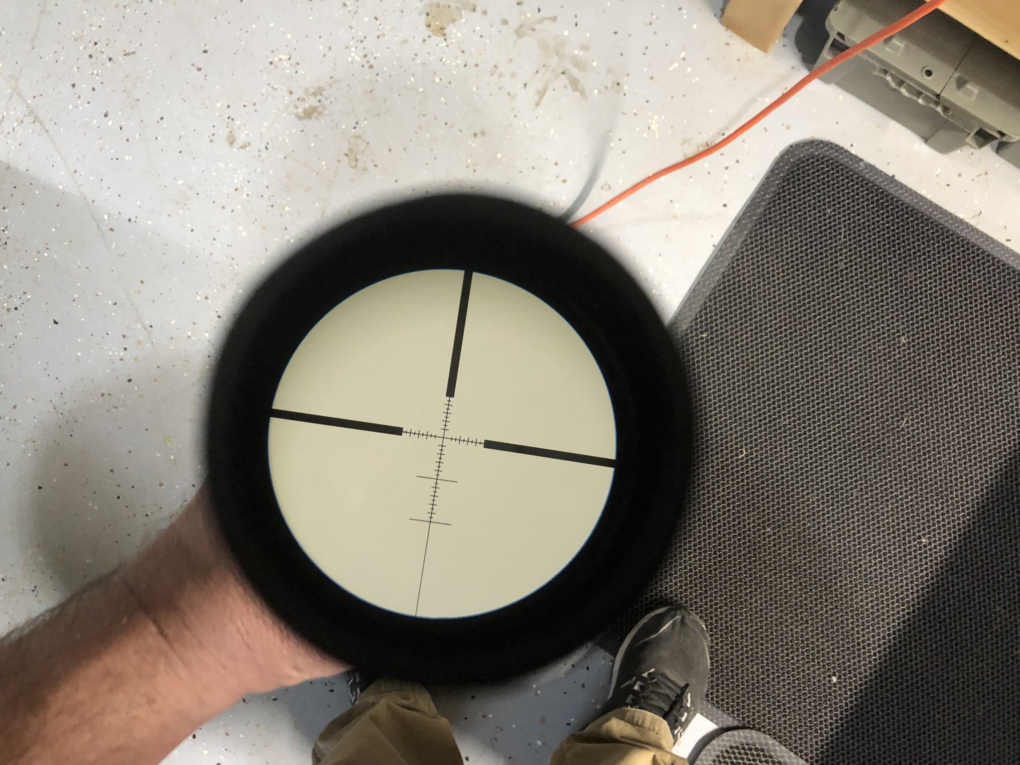

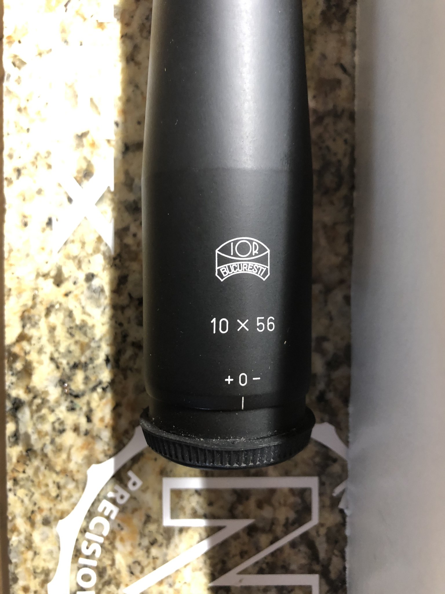

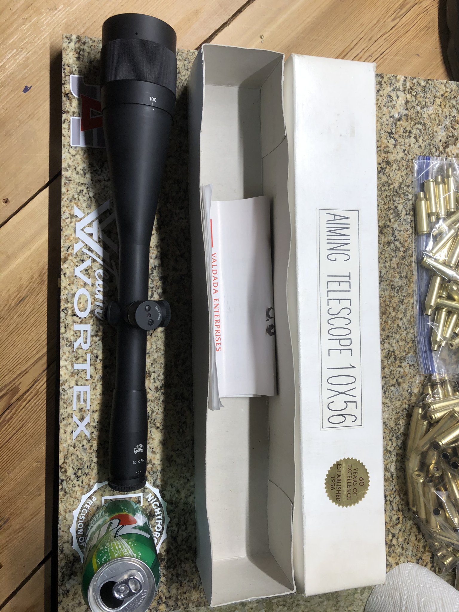

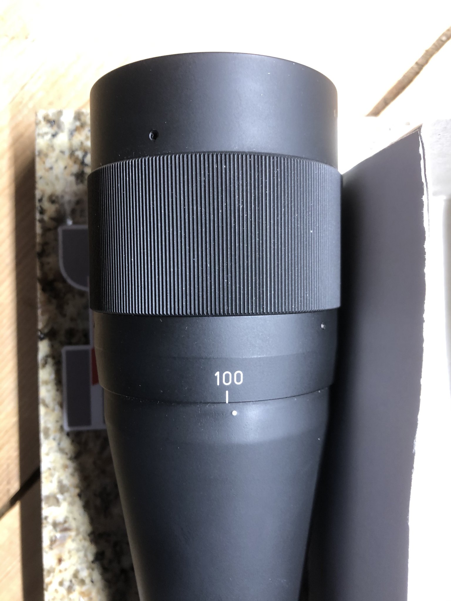

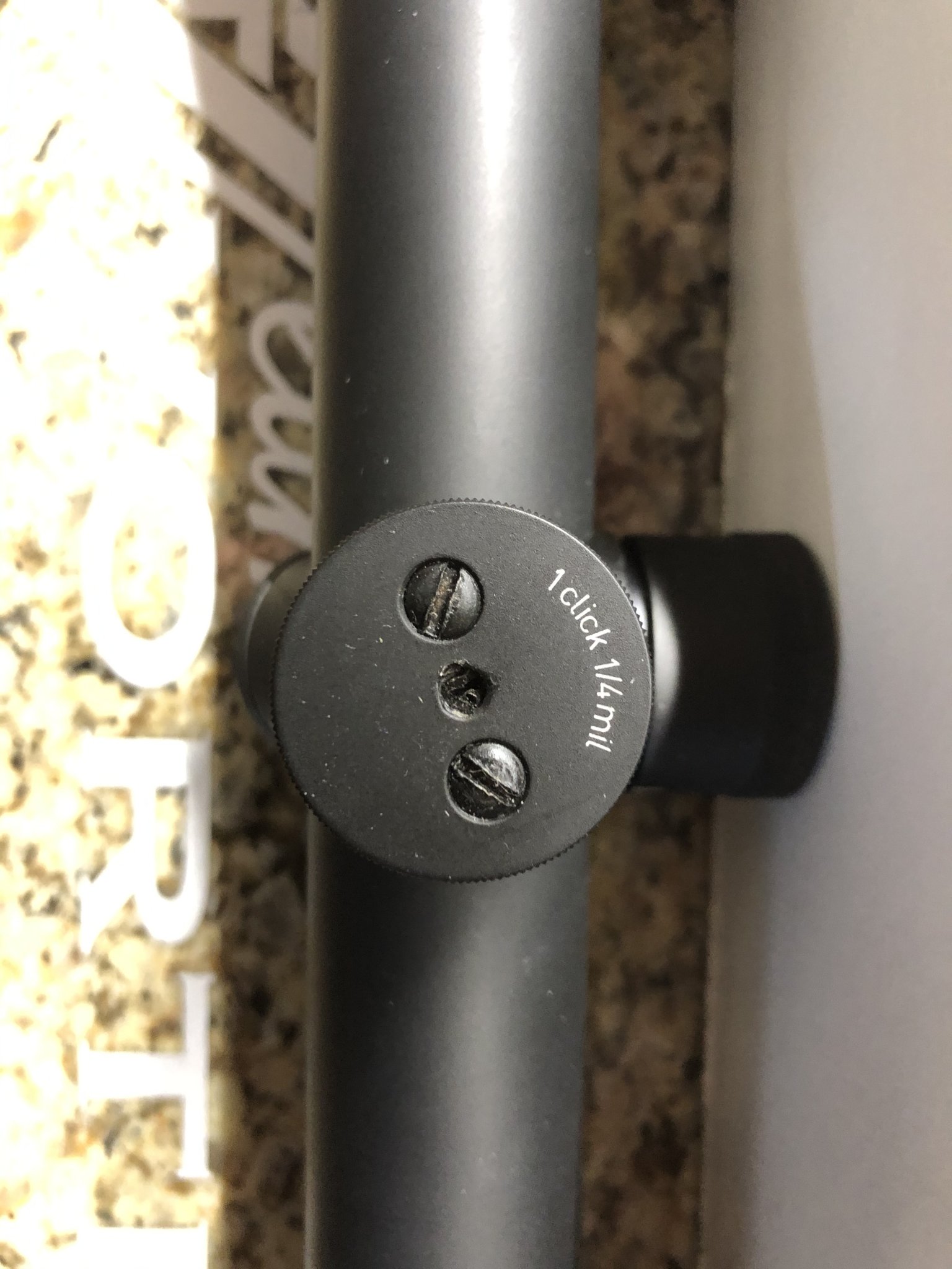

    Hello all, I was hoping someone might be able to give me a little info into the scope that I have pictured below. It is an IOR scope with Bucuresti in the insignia. It is a straight 10x, 30mm scope with 56mm objective. The scope is made of steel, not aluminum. It is in great shape, I’m not even sure if it’s been mounted in a set of rings. I have the box and all the paperwork. If anyone knows anything about these or this particular model I would appreciate the help. I hope this is the right section to post this in. Thanks for the help in advance.

    Those screws looked buggered-up in the Pic. ? . so cant be new scope .
    sounds like a boat anchor being steel tubed and 56mm Obj. . better options out there for a fixed 10X that that .

    The glass in mine was great, and tracking was good, but most of the fit/finish was typical Eastern Europe. Fairly rough machining, soft turret screws.
    The biggest issue is that if something needs fixed, your likely on your own. IOR has no US repair facilities, so you'll have to try and work with the one and only US importer, Valdada Optics to ship it back to Romania for you. I've heard that process is anywhere from no-fun to impossible.
    A tip to save you from a shitty experience in 3 handed mechanical surgery, never take both turret screws out, and don't fuck with the center screw, ever!. To rezero the turrets, loosen both screws about a turn, rezero the turrets, then tighten them back down.
    If you remove both screws at the same time, a washer inside the turrets falls down inside, and the screws will no longer reach the threaded holes. You'll then have to hold the scope upside down, up above your head, reach into the screw hole with a paperclip and fish that washer back into alignment, then start the screws in while in that position.

    If it came without a manual, the following info will be valuable.
    To zero the turrets, loosen the 2 top screws about a turn each. Hold the top part of the turret to prevent it from moving (the top is connected to the erector). Then while securely holding the top cap, turn the lower portion untill it's zeroed. Then, retighten the screws. While turning the lower part, it will click, but as long as the top part is held securely the erector won't move.
