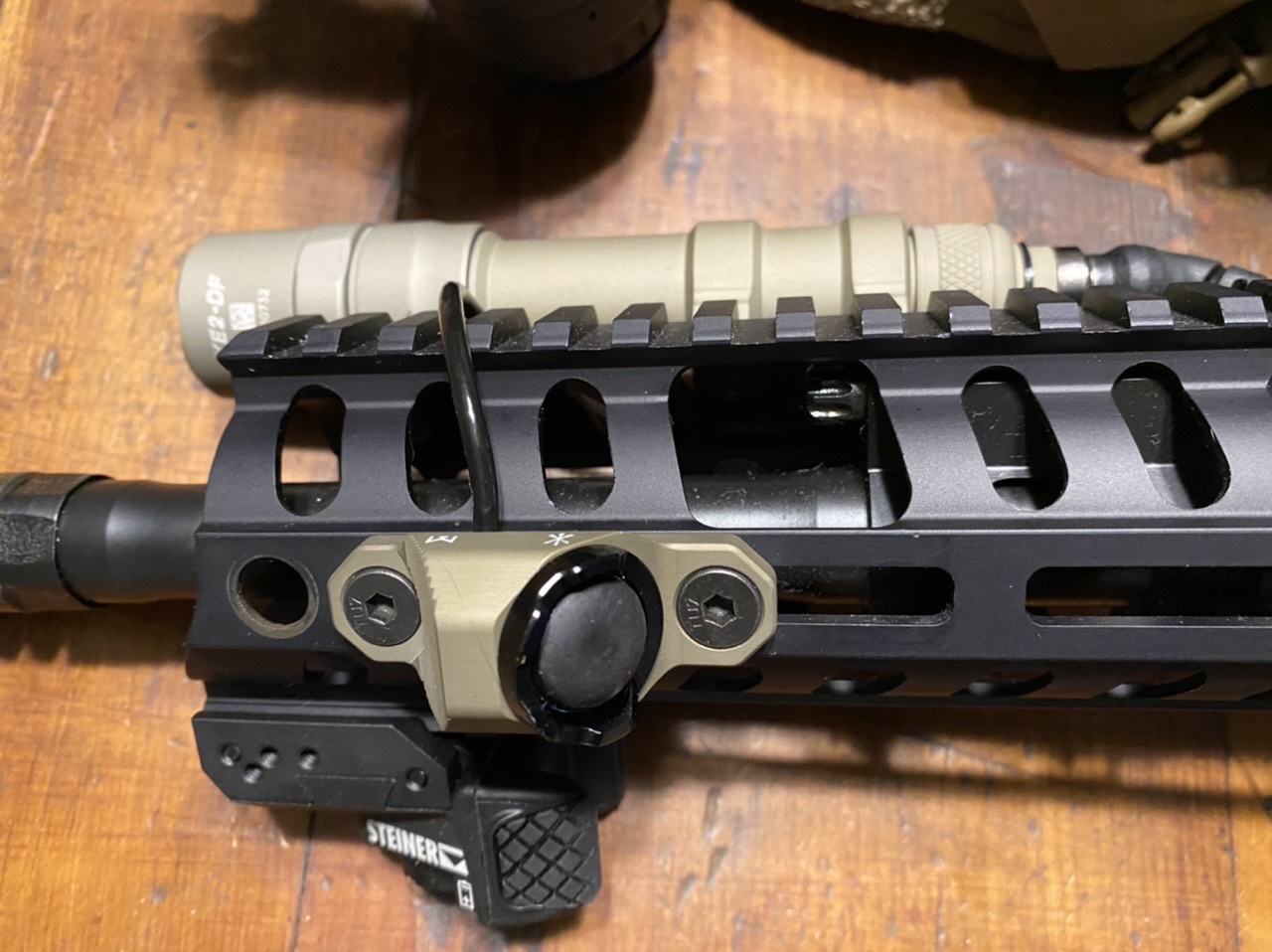

    I use a Steiner CQBL on my all-purpose carbine for aiming, it’s fine for my needs. I couple it with a surefire wL/IR.
    For longer range stuff w/clip-ons, I’d rather have a high performing illuminator (I use a SPIR for illumination) but that’s just me/my use case.

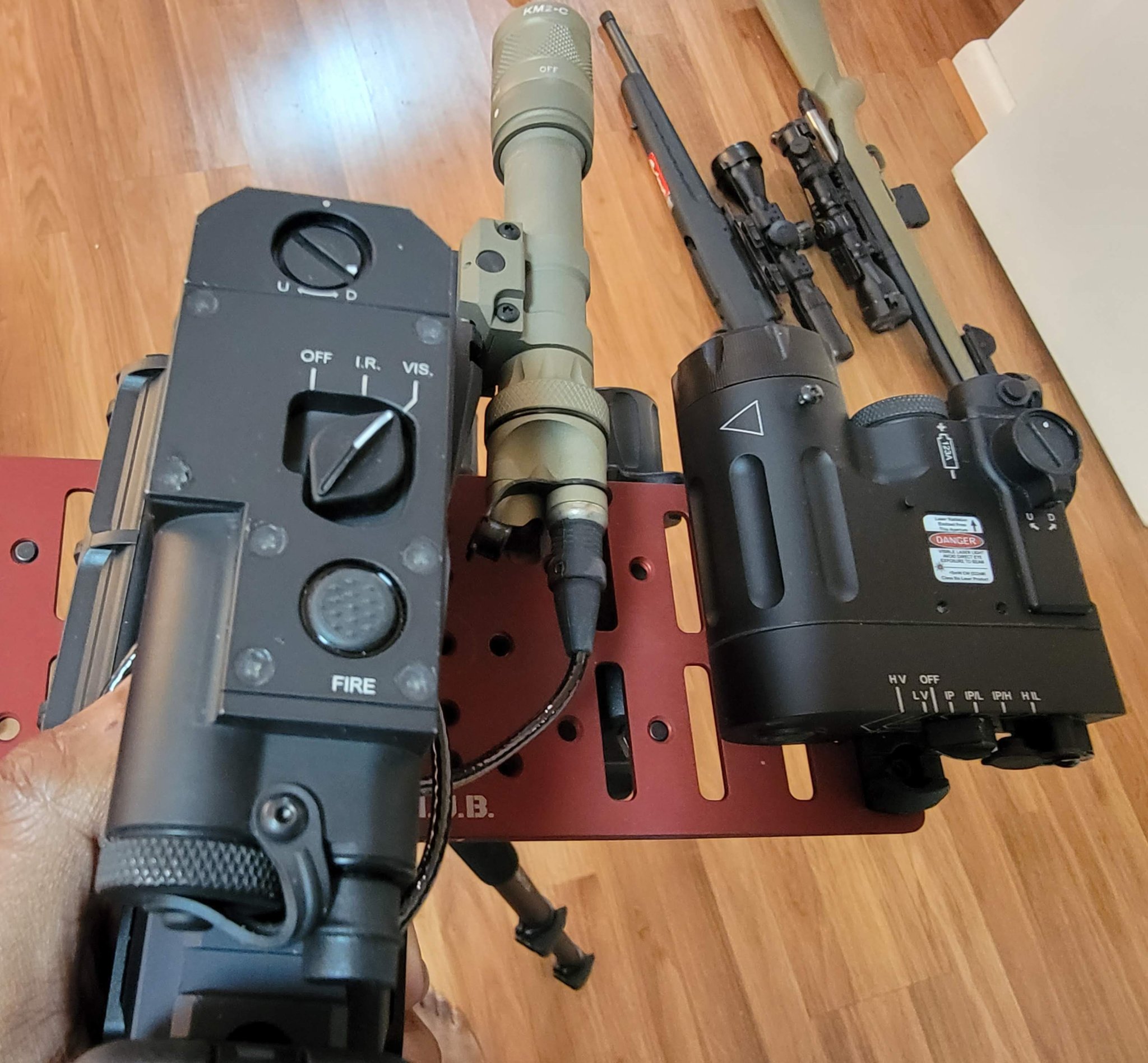

    So I found a dbal i2 that has just the air ladder and a visible laser, no Illuminator for $500.
    Would I be better off getting something like that plus an IR flashlight or getting one with the Illuminator built in for $890
    That d2 just seems absolutely giant. Then again having a laser and a flash light I doubt is any lighter. Thoughts?

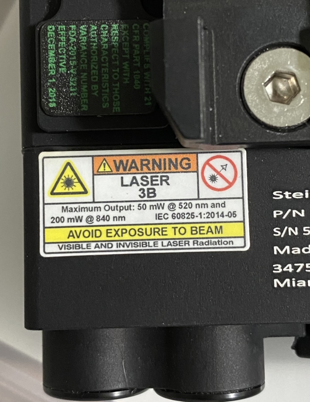

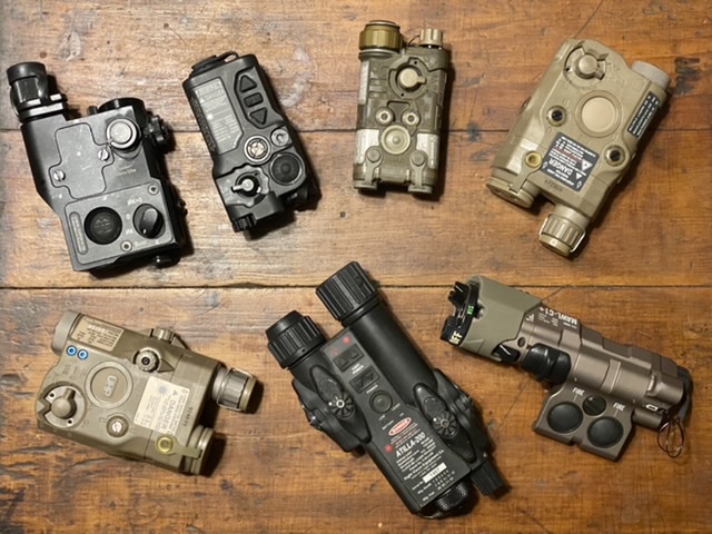

    As someone who's personally used dedicated IR lights, civ lasers and FP lasers...here are my thoughts:
    You can't solely base your tool choices on cost/budget. I did that when I first got my nods. I aimed passively with a Eotech and had a Modlite IR 850 illuminator for when I needed illumination. The problem with standalone illuminators, including the new BE Meyers Kiji is unless it's a rifle you never intend to need white light with...you're going to end up with 2 lights, a laser, optic, and switches. At that point you might as well get a bayonet and swiss army knife attachments too so you can be the next meme. It makes for a bulky setup and just more crap you have to manage especially on short railed guns like SBR's.
    My next purchase was a DBAL A3. The DBAL was improvement based on the fact I had visible and IR laser, and IR illuminator without needing two flashlights on my rifle. On really dark nights, the A3 actually does a decent job especially if there's no moon and you're illuminating into a shadow. I've seen it light up targets at 200 yards in those conditions. However, those conditions are rare and the much more common performance is sub 100 yards and basically useless in a full moon trying to illuminate into a shadow. Ya know, like a tree line?
    FP DBAL A2: this is where I am at now and where I should've started. It doesn't have to be an A2, but the FP performance is a game changer. I bang steel at 200 yards with my SBR under nods all the time. These dudes claiming 100 and in is just bullshit. Their equipment is either never used and or they just post cool boi pics on social media for likes and follows. The only civ lasers you can get to engage steel at 100+ yards regardless of conditions would either be a DBAL D2 or your high-dollar MAWLs and the like.
