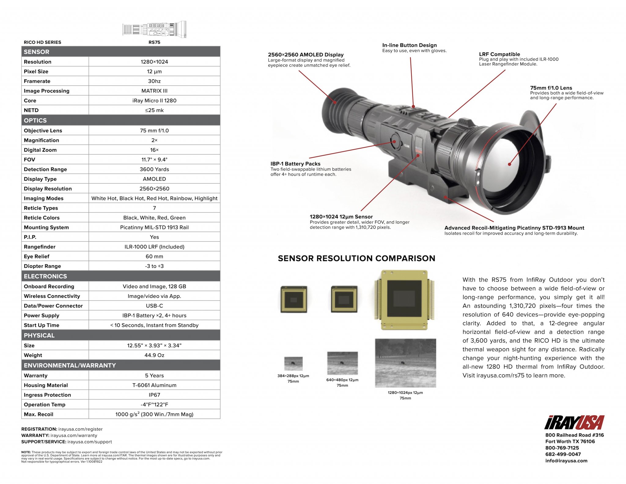

2560x2560 display is sweet. The size of the scope from pics I’ve seen makes me think a legit clip on wouldn’t be out of the question.
An 8-9 deg FOV unit would be insane with this core. Very good FOV and should support 18-20x mag.
Or a slightly scaled up RH25 that is 15-18 deg FOV and handle 12-15x.
Or NVision could beat them to it :)
Looks like $18k MAP with the LRF - http://irayusa.com/rs75
Yeah little confused on the power demands. From the picture it looks like only one of their IBP-1 batteries will slide in the side at a time, but it lists 2x of them for 4hr on the spec sheet. So not sure if that's 2x that come in the box and you only use one at a time, and then whether 4hr is for each battery or both back-to-back. Hungry girl either way - can't imagine what it would have been at 60hz
30Hz
Super power hungry
45-ounces
$18K
Chinesium
Dedicated scope only. NO clipon capability.
Will never be more expensive than it is today.
Kinda crappy timing. Far fewer people willing to dump $18K on a Chinese thermal today than 1-2 years ago.
Yeah I’m fine with no clip on ability. Gotta leave the door open for them to release a clip on for $8k!
@jwramp nice of them to include an LRF, will see how that works…
ETA: NETD at <25mk is sweet. 11.7 deg FOV is about perfect and should have similar long range performance as 6 deg FOV 640 units. I’d love this FOV as a do all clip on. HD screen is a nice feature too. 12um pixel is good to ensure it’s executed as well as it can. Future 10um or even 8um sensor would be very helpful in the sizing of the unit.
30hz is interesting but I’m sure future units will bump it up. Power usage could be a real issue in cold climates. It’s also a thicc unit
It's 4 hours optic runtime each/per battery.
(That's a super-conservative number: runtime is around 5 to 6 hours per when the batts are new). Only one battery fits into the optic at a time. I suppose if you had the optic plugged into an external pack you could hot swap them. Not a big deal to take one out and put a fresh one in and quickly turn it on again. The batteries are around $169 separately: that optic comes with two of them.
Reactions: jwramp

Will it be a challenge? I'm not an optical engineer but I would've thought FOV depends more on your lens/es than it does on your chip. Kinda like how the sensor on a dSLR can see wide, narrow, short, far, etc depending on what lens you put in front of it. If that's true you could make a super telephoto germanium lens and have a 2 deg FOV 1280 clip-on and see through the hogs.
And people are buying up the Theons so clearly the high-end civilian market is OK with "high performance but at the cost of weight" units like this.
Correct. You'd just need a larger lens: longer focal length and larger diameter to maintain a good F/#.
It’s both the “chip” and the lens. Smaller “chips” need smaller lenses with less glass to accomplish the same FOV as a larger chip with larger glass. This is why compact cameras can have bonkers zoom ranges with tiny lenses, because the sensor is so small. You trade-off a myriad of other benefits, but gain convenience and significant cost reductions. This is why a 600/f4 lens is $12,000 and looks like a Javelin missle where a subcompact camera with a tiny sensor can have a 600/f4 lense that fits in your hand. It only needs to project an image circle the size of a pea.
So, a 12um sensor with 1280x1024 pixels is quadruple the size/area of a 12um sensor with 640x512 pixels. To have the same FOV while maintaining the same aperture requires a MUCH larger lens.
This is a very non-technical, but generally accurate description of how sensor size and pixel pitch interact with optics.
The deeper dive includes Circle of Confusion, DoF, MTF, etc.
