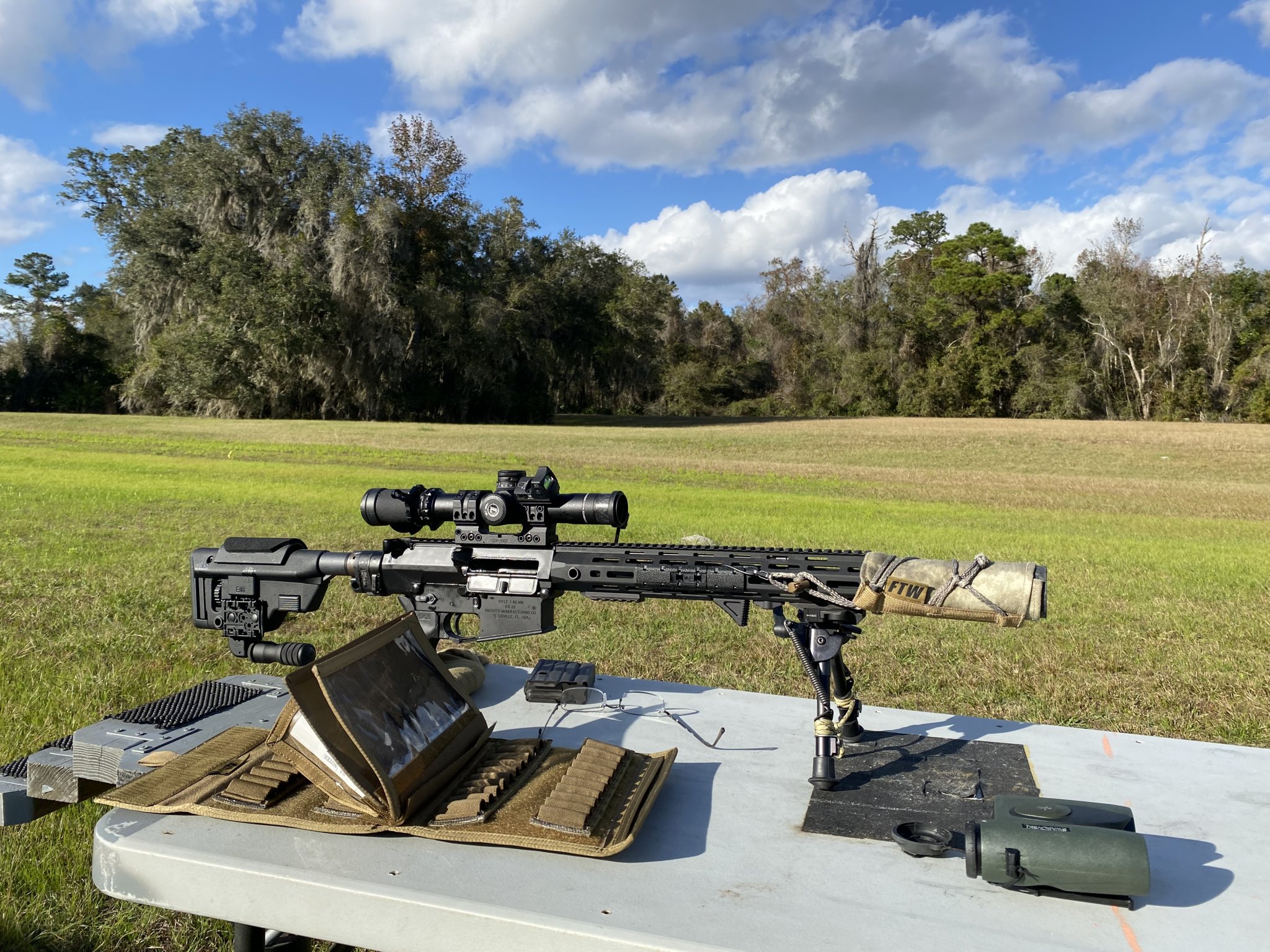

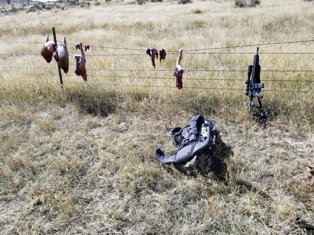

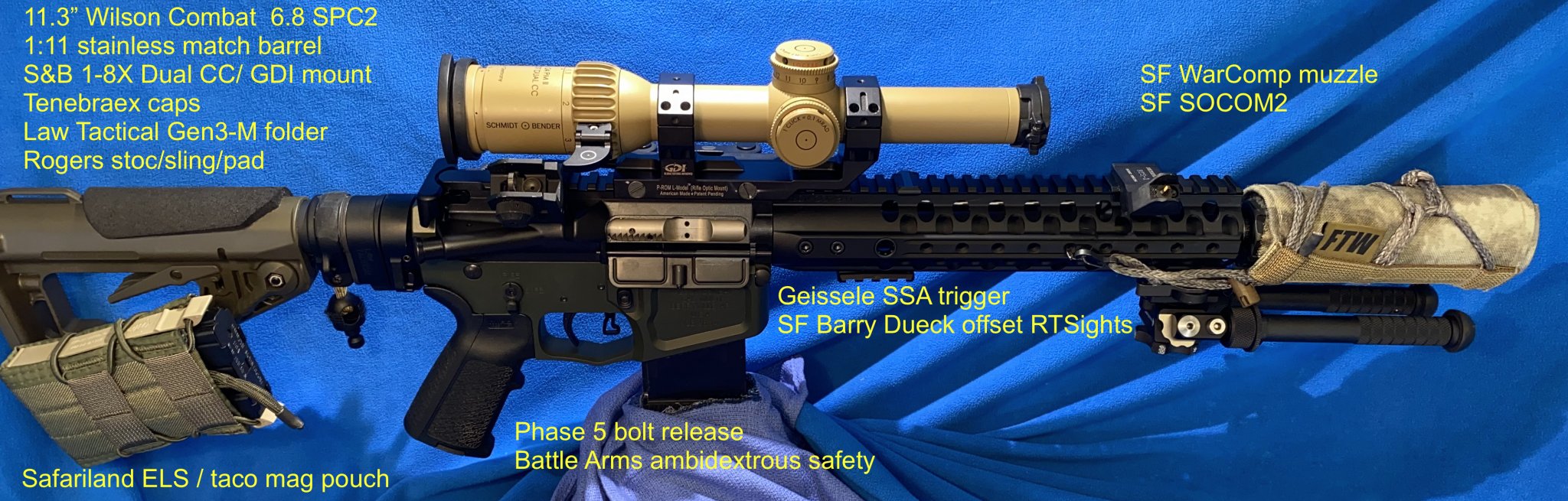

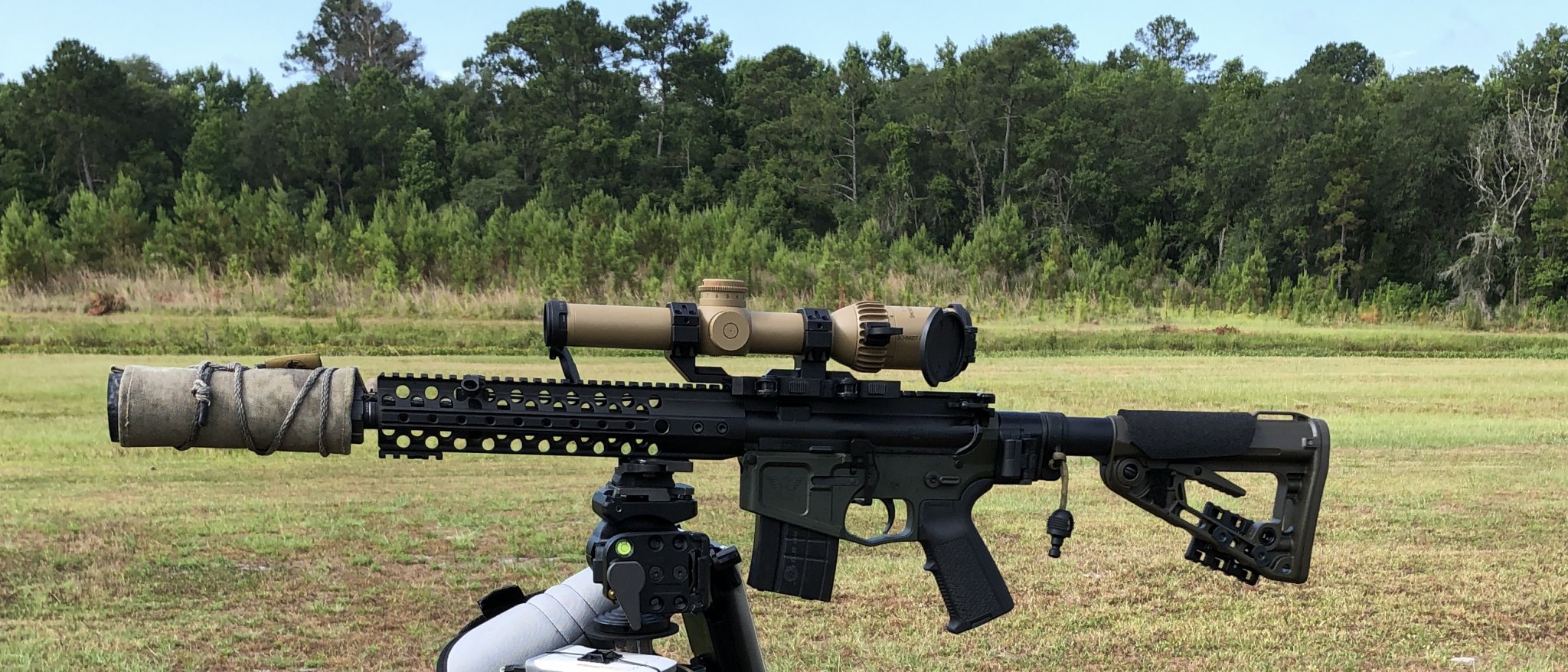

For the OP, the 14.5" 5.56 is the tool you have to work with. I would prefer a larger caliber SBR . As stated above, DMR is not defined by the "R"ifle placed in the hands of a DM. From my inventory I would choose the a short 6.8 SPC II or KAC SR-25 14.5" ACC; anything outside their effective range, get on the radio and call in air support. Some suggestions just for fun that I would select over 5.56 all day long.
View attachment 7834820View attachment 7834821View attachment 7834822View attachment 7834823
