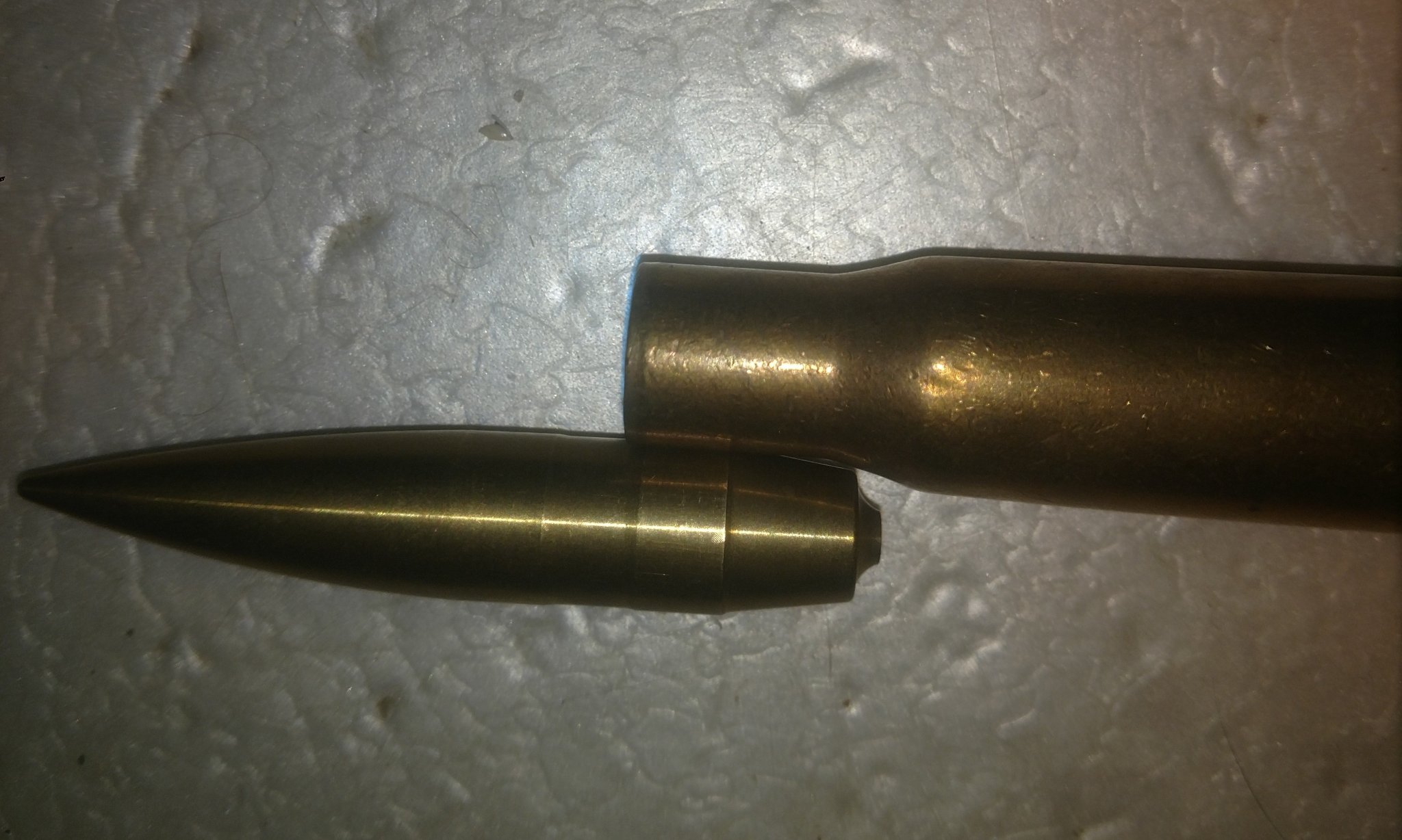

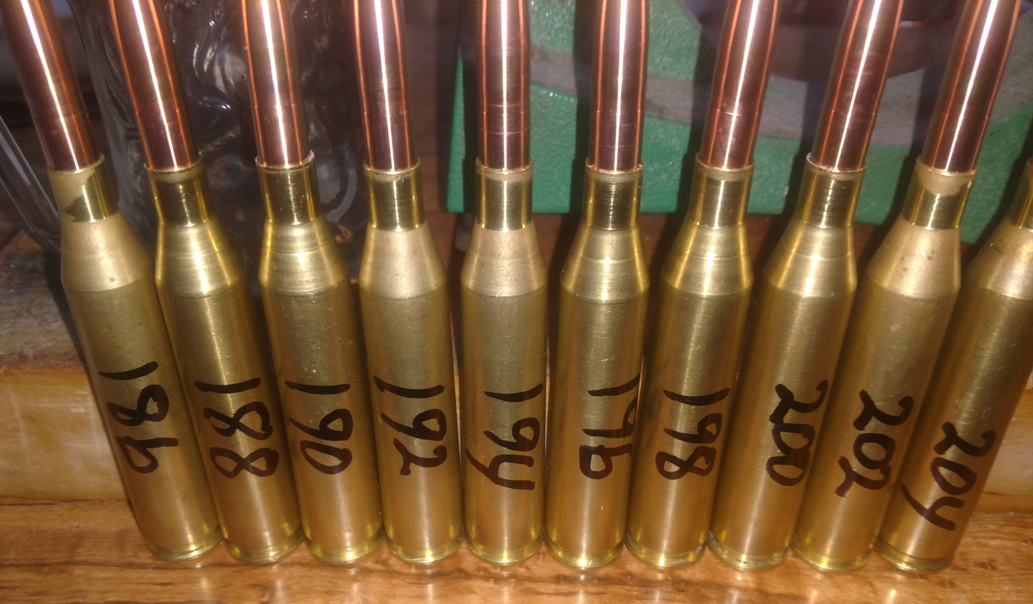

    Here is a 50 showing the driving band at the top of the neck with a 750 grain Lapua.
    The borerider section that sits on top of the lands is 0.510 the wasteband section is 0.505 and lastly the drive and section is 0.512 gets engraved.
    And yes it reduces the drag while sealing hopefully.

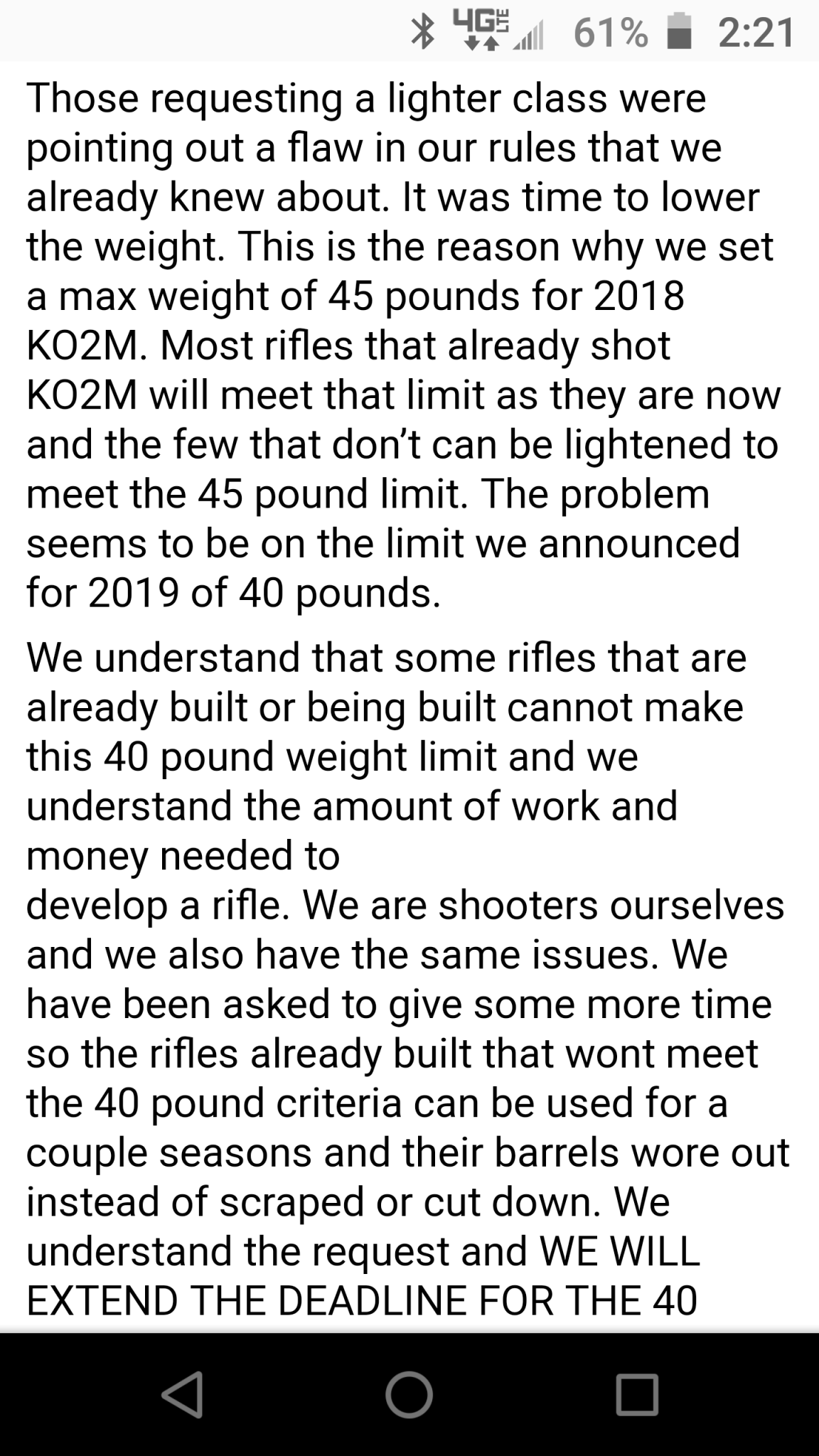

    Isn't Hunter Class the only FCSA competition shot prone from a bipod?
    I ask because in reading my rulebook it says 50 pounds.
    I then went on the Facebook site for ko2m and it says the 45 pound limit has been extended to 2020 because of all the existing rifles not making the 40 pound rule and allowing those shooters to "scrape out" which I imagine is scrap out there existing barrels?
    It appears the only legal FCSA rifles would be a Benchrest lightgun if you add a bipod?
    Sandow
    The fact that hunter allows for a 50 pound gun doesn't mean everyone has one. I can't think of many I've seen on the line that are actually that heavy. I've shot hunter with a gun under 35 pounds for 15 years. There are pretty much no common platforms that are that heavy. This is part of why bitching about 40 pounds being too light of a gun gets ignored. That is still a heavy damn gun by any standard.
    Only 14% of guns shot last year will be too heavy next year and we are aware of 2 people that had to rebuild guns over 50 pounds for last year. 2 years is plenty of time to swap out some parts and get under the limit.
    Where are you seeing 45 pounds out to 2020? Might be a typo. The limit will drop to 40 next year but that will be the last time we shift it down. If nobody puts for extra incentive to shoot guns in the 25 pound range like David Tubb has then we will probably come up with a way to do it ourselves (not a light class though, that isn't going to happen).
    The other thing I'd point out is that while some shooters may bitch about the weight limit, it has helped encourage development of progressively lighter stocks from McMillian, Manners and others. It has also made barrel lightening tactics like Tacomhq's an attractive line of development. Restriction can drive development. Unless it is nascar, then it just drives perpetuating shitty old tech and boring ass racing...
    -Alex

    Edit please note that 2 out of the top 3 in 2017 can't use there gear anymore.
    And Walt Wilkinson how did he do with his factory gun?
    How many from 2018 are affected by the weight limits? I completely understand you are against the weight limits.

    Getting ready to shoot the flatlines after seating. Going to start at 186 grains of RE50 and go up to 204 if I don't see any pressure.
    Case capacity is way too large. I am at 80%
    Going to try 872 next to get the fill % up.
