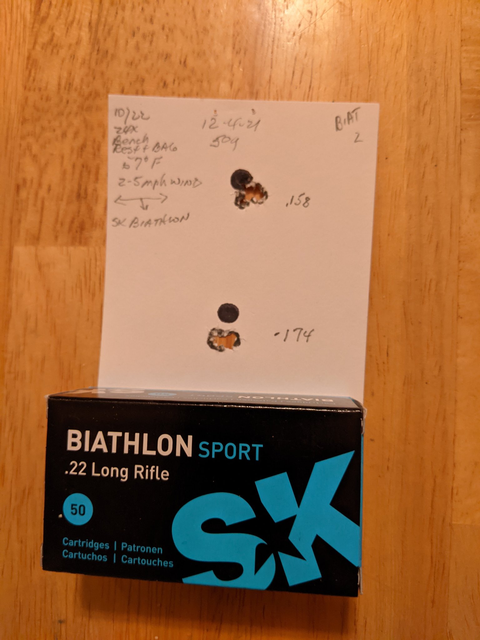

I don't shoot 5 to 10 groups on one target. Where I shoot conditions are very bad normally and one is lucky to get steady reads for a couple of groups at one sitting. You can believe what I posted or not, I know what my rifle is capable of and so do those that shoot against me.
I knew that reply would elicit this type of response. Believe it or not. Here is a pic of 2 consecutive 5 shot groups at 50 yds.
Over and out.
