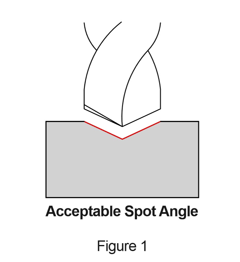

Is a 5/32 drill bit okay for 10-32 x 3/16 knurled set screws?
I have an Slr jig that can’t fit anything bigger than a 5/32 drill bit is this okay for the BCM gas block that uses 10-32 x 3/16 knurled set screws?
Might be good to watch the video on slr site.
Far as I can tell it is a dimpling jig. Shallow. As in just the pointy part of the drill. End result should look like this. No actual hole. No verticle sides to the dimple.
