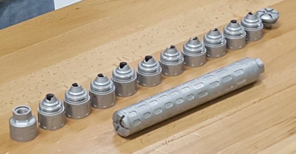

way outside the box here. do you think given the level of precision from machines these days somone could build a barrel in sections that screw together?
kind of like the modular 22 suppressors.

is it even possible to build a barrel that goes together like a modular 22 suppressor?

I hear you, I guess the photo of of the silencer in a bag full of 2" pieces got stuck in my head!
