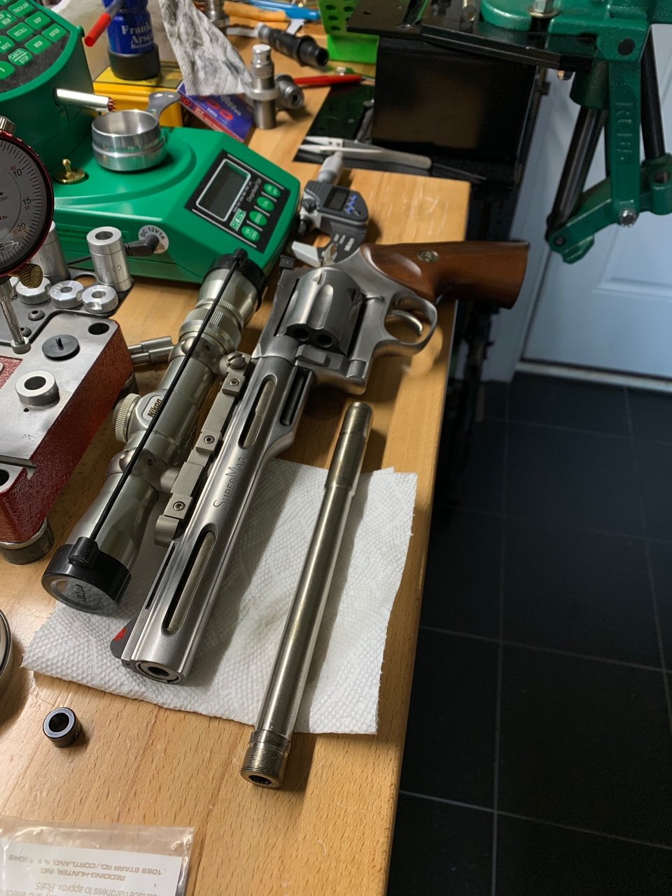

Remember the Dan Wesson modular/interchangeable barrel pistol kits? That was pretty forward thinking at the time & it made a lot of sense especially for the SuperMags. I still have the new replacement barrel that shipped with mine.

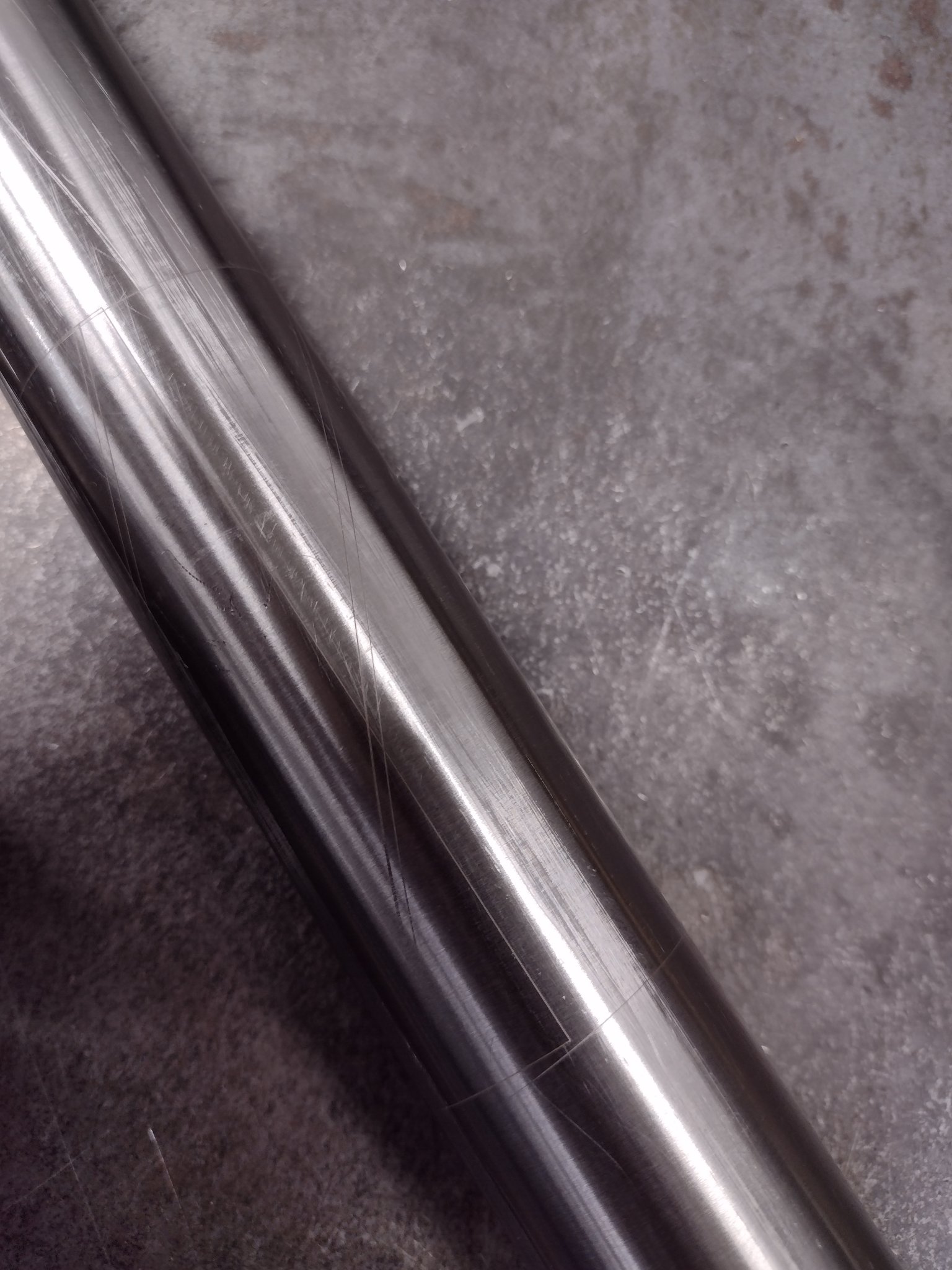

Lasered the twist rate on the outside of the barrel, chopped and threaded both ends then timed it so the helix lined back up.
Poi shifts obviously, and you get 18fps per inch velocity boost. As long as everything is tight it acts just like a normal barrel.
To do it in individual interchangeable sections would require a bit more work, and may still run into issues with bore/groove dimensions... Possible but this was a science experiment, not really anything practical IMO.
ETA: Best bet would be to gun drill the pieces, cut the threads, screw them together, key them to lock index, then ream, rifle & lap the sections. Section lengths have to be a multiple of the twist rate divided by the number of grooves, and you'd have to come up with some sort of universal method for indexing it all...
