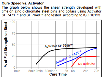

1) If you wax both ID and OD, then the substrate is wax and wax. Are people only doing a release wax on the ID? How then do you get the 620 off the barrel, or is the barrel now a throw away item?
2) 620 is expensive, has a short shelf life, and most won't use much of the tiny bottle.
3) The use of an activator is mostly for speeding up a "set" time, but it impacts strength of the 620 final cure. I have email somewhere from Henkel stating the activators in general reduce max strength of the anaerobics. The anaerobics work best with active substrates. This graph is similar to wax-wax substrate setup, be lucky to get 50% of what the 620 has to offer, which however may still be enough, maybe that's why it knocks out so easily?
Not concerned about 620s gluing strength.
It's hard enough to remove as is. It takes an oak dowel and hammer hard on a concrete floor to remove.
The research & tech data is fine, but we don't need the parts glued permanently together....

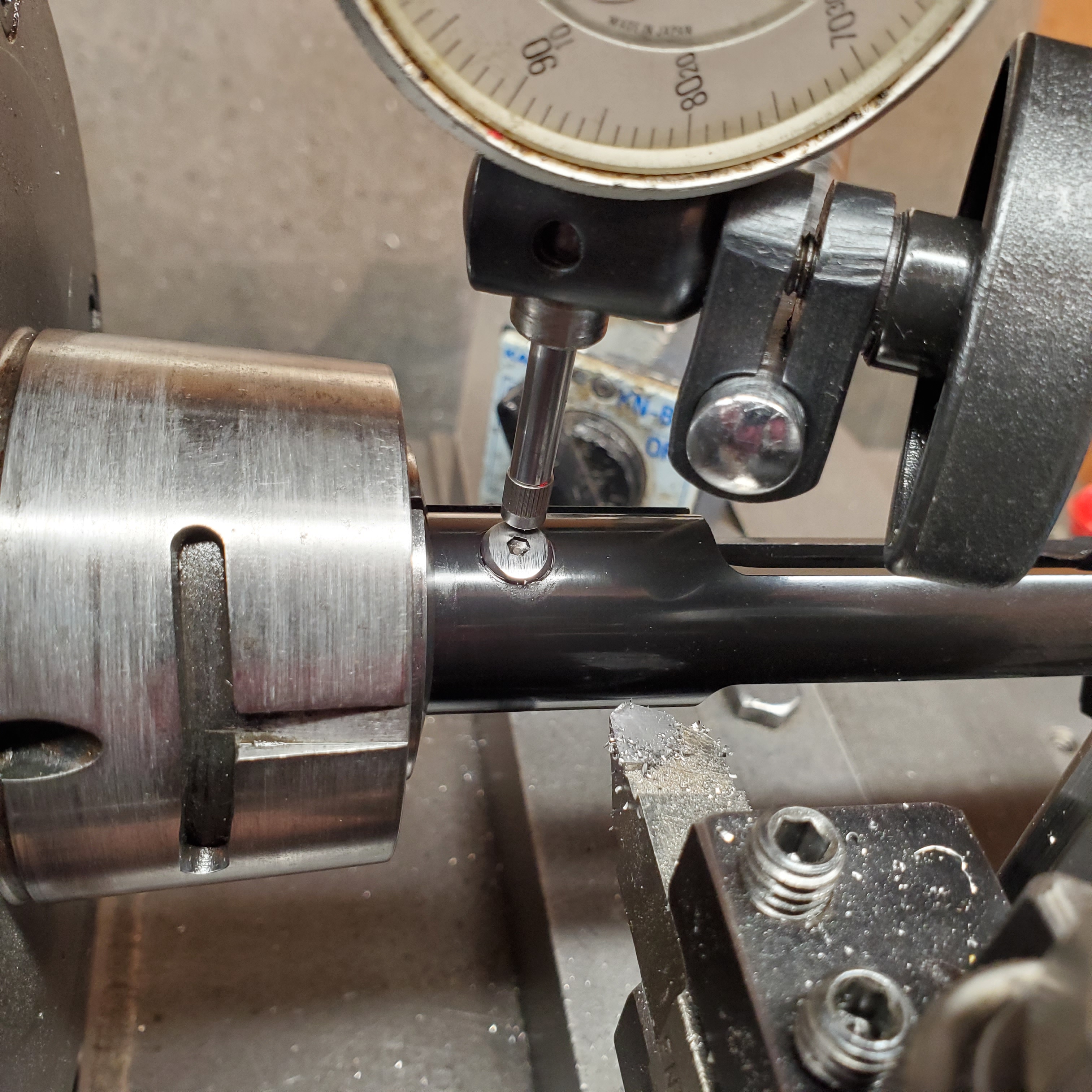

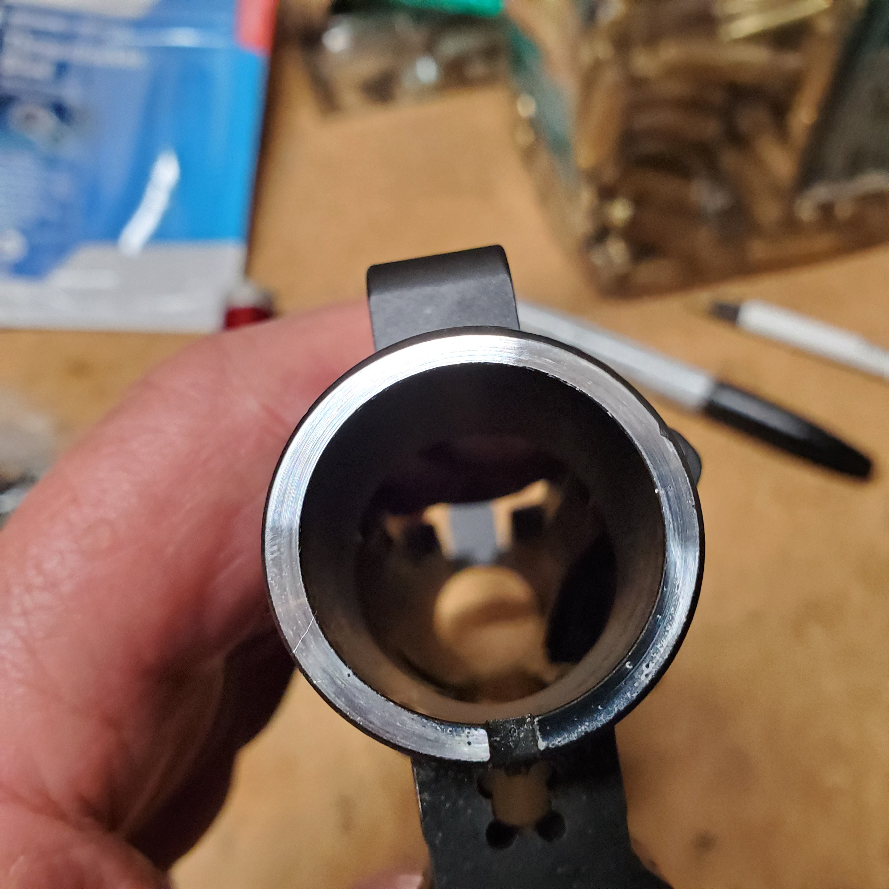

This is an 8.6 Blackout and the infamous 3 twist headed for the scrap yard.
I just had to try the 3 twist for my self.
Notice, the oak dowel is swaged up to get this barrel out. The dowel will be trimmed back for the next AR 10 barrel...and that's with the wax on the reciever only...which I tried to measure with a tenths indicator and got zero reading.
Plus there is only usually .0002" to .0005" maximum depth around the steel barrel extension to take up the tolerance and slight out of roundness between the 2 parts.
Why do some have good luck without doing the glue-ins because usually there is not that much extra space around the reciever and barrel extension ...but a few will "wobble" a bit.
And it makes improvements for me as one of the accuracy enhancements to the AR platform.
I actually measured the 620 thickness...here its about .0004" or 4 ten thousandths of an inch thick all the way across...but there are slightly thicker and thinner .0002" to .001" on one side as it drops into the groove...
So most of 620 sticks to the steel without activators, and expands to take up unneeded space to make a solid barrel to reciever fit.
The wax surface is non measurable.
We are not trying to glue them permanently together...just make a solid or nonmovable fit between the barrel and receiver.
It seems to work as most ARs assembled with 620 plus other accuracy enhancements will shoot quite few 1/2" groups with various powders and bullets.

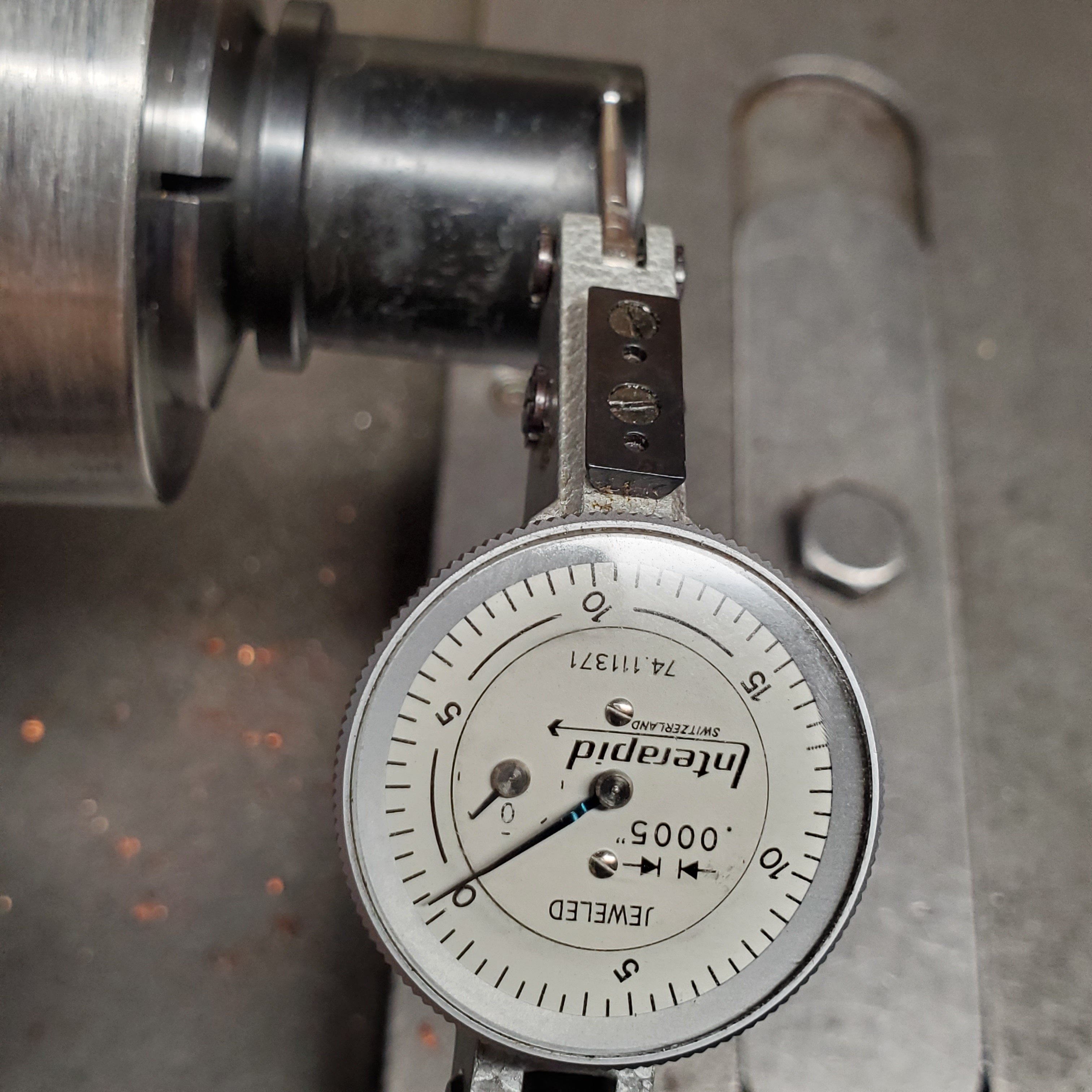

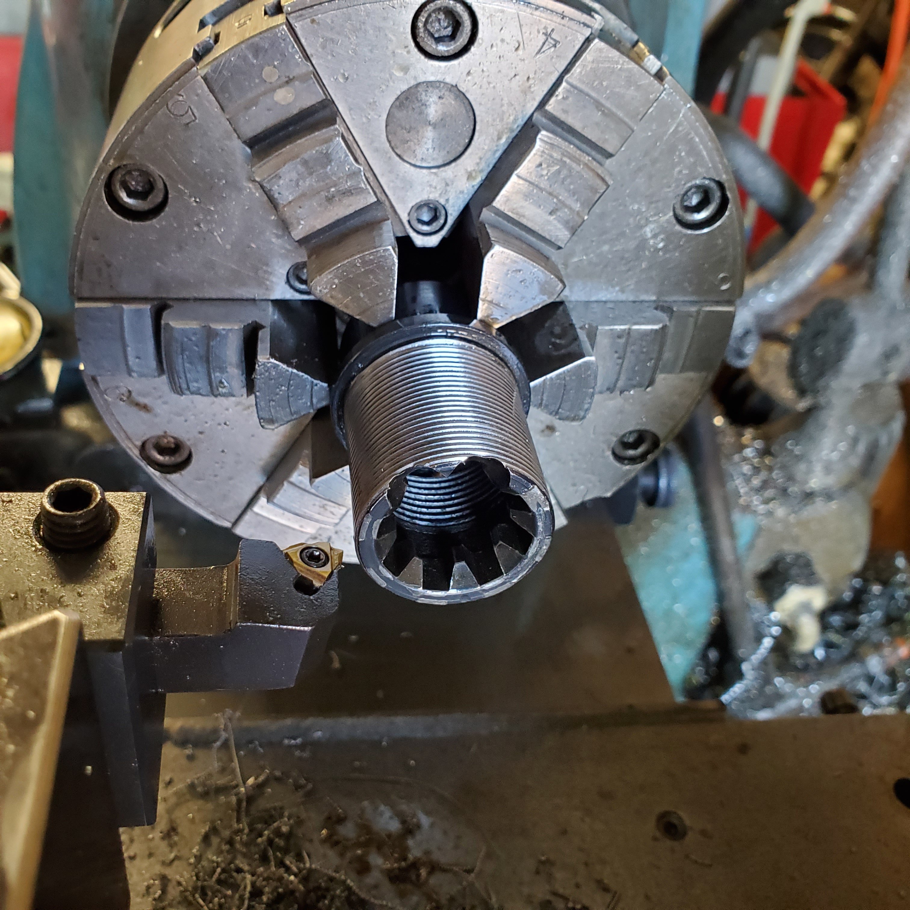

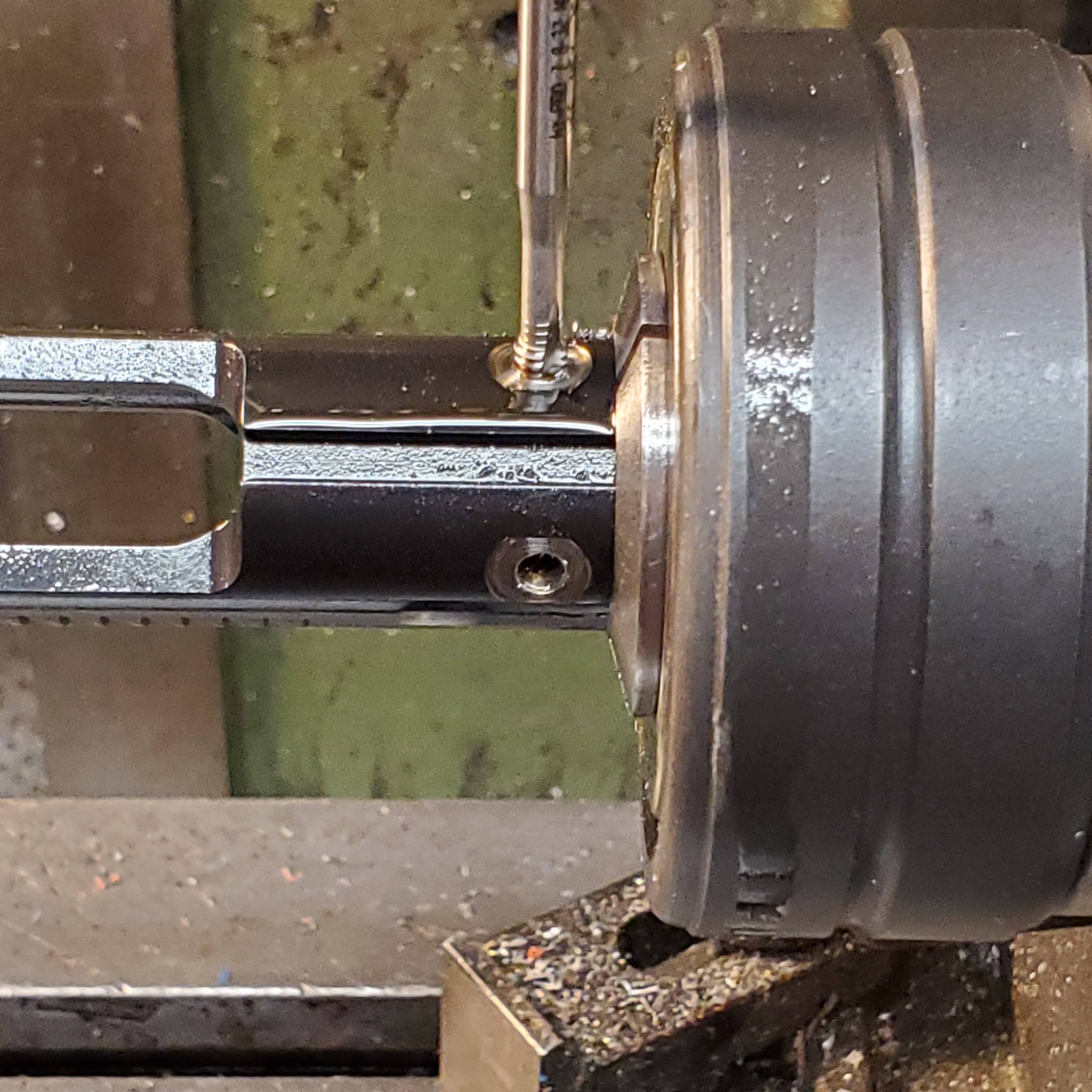

You can buy oversized ground barrel extensions...but then ya have to torque them on an existing barrel, and the gas port probably won't line up.
Barrel extension metal is pretty hard.
Carbide will cut it at low speed.
I just threaded this old 8.6 Blkout barrel extension, 20 tpi, so one can thread the barrel into the reciever if he is a machinist, or handy with a lathe.
I'd start with Areo enhanced reciever with the heavy wall.
It has internal threads for the barrel nut.
That may have a potential to work out.
Or turn down the enhanced reciever and thread it. Then have a bushing with the internal and external threads to fit the reciever and the newly threaded barrel.
Thread the barrel in, check headspace. Or use a barrel nut like Savage to ease in barrel assembly and headspacing, feed ramps etc...last thing after everything fits is drill the gas port to line up...may have to mill a slot for the gas tube.
One can start from a barrel blank and do all the maching ...but this way it would be as solid as a bolt action that threads into the barrel.
And even mix AR 10 recievers and AR 15 recievers and barrels. Need a 2.8" COAL 223? Probably not...
Not very practical for the average guy.
But it might do it if I feel the need...
For now, I'll just probably do the same old 620 procedure for the most part, cause it works for me...

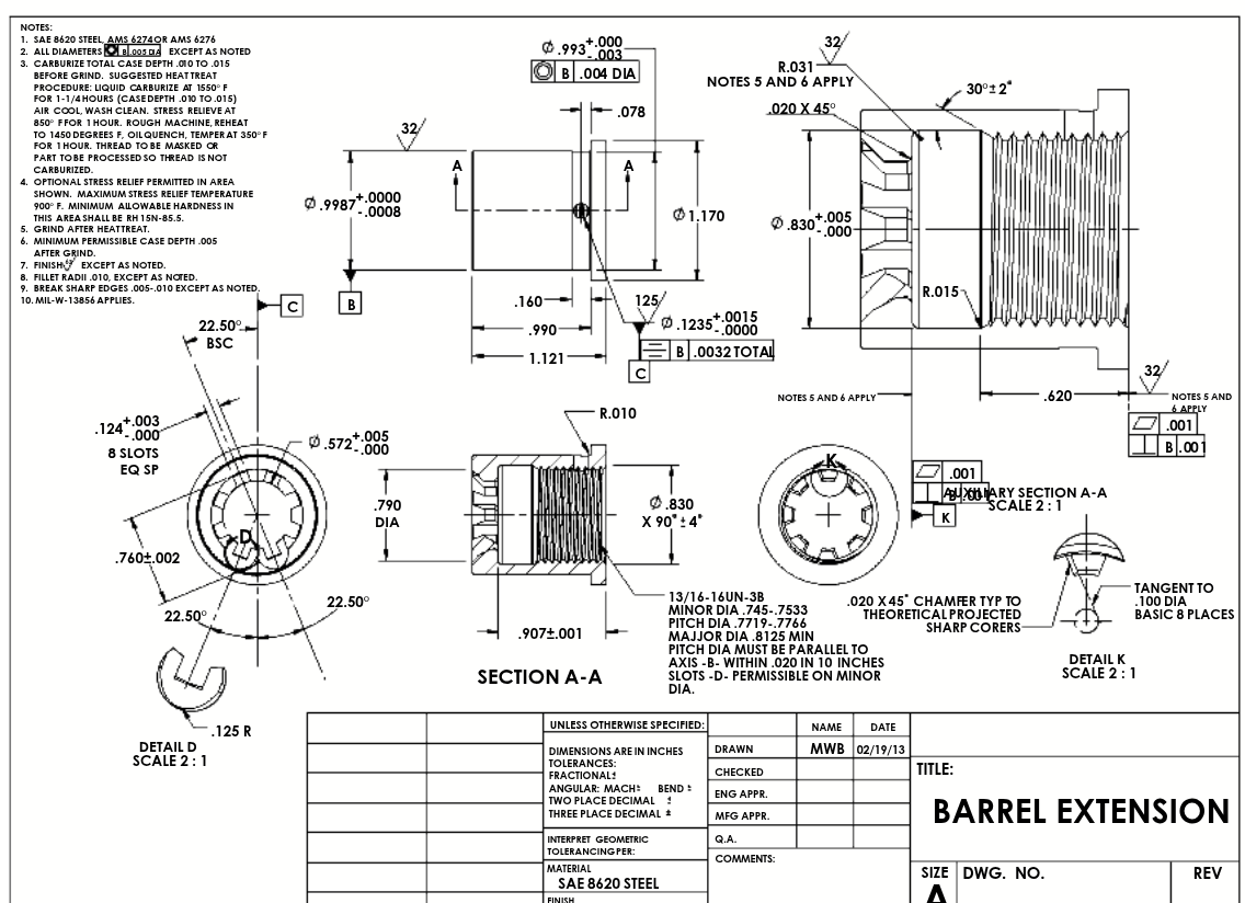

The metal is case hardned or should be to a certain depth I believe about .010 to .015"... but its like barrel steel once ya get under the case.
Yeah i know you are right. But i had to troll a little and say i expected a little more specificity than “pretty hard”.
I expected you to say something like RH 15N-85.5

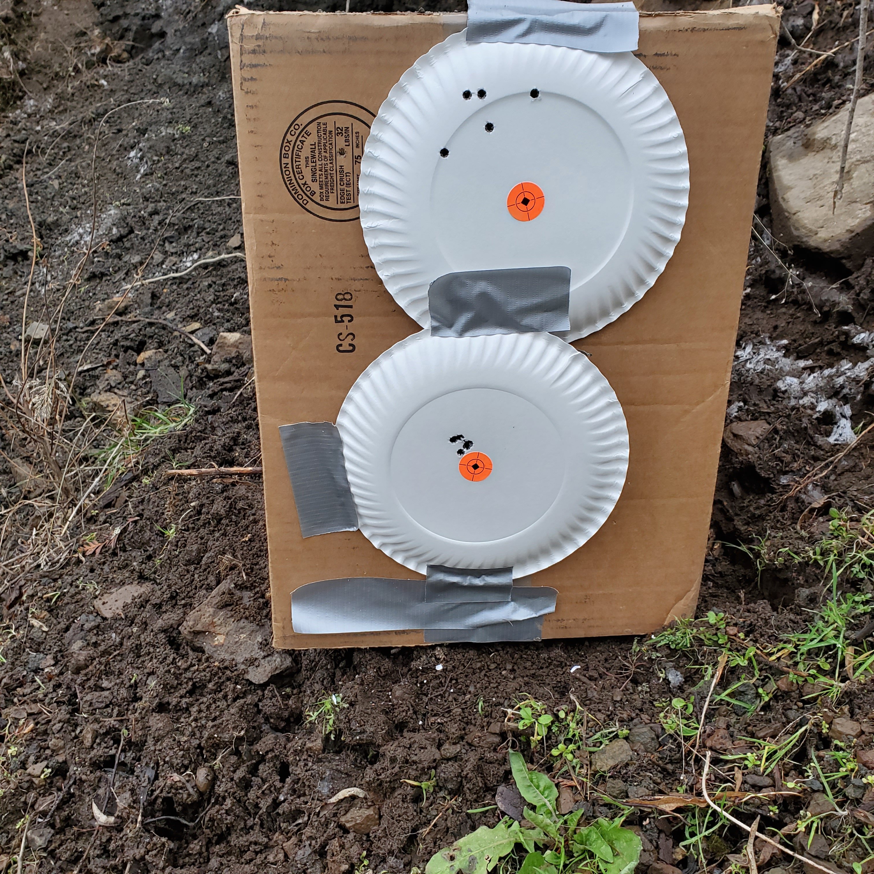

I can tell you from personal experience that bedding a barrel extension on a loose fitting upper does make a difference.
I took a Criterion hybrid with a BCM blemished upper that was kind of loose and shooting around 1.5 MOA with 77 FGM-SMKs and turned it into a 0.8MOA with the use of shims and 620 goop.
I learned the process in a gun smithing class and not on the interwebz.

Brownells is a little off base, IMO...except for the interference fit is a good start.
You must shoot and test to see if what you do has any improvement and how much...and that varies from gun to gun and even to calibers to some extent.
But these accuracy enhancements make a difference...example: same day, same match ammo, factory upper vs the accuracy enhanced upper both 6mm ARC.
Brownells says, ya don't need to true the reciever face...ya actually should check it, cause as you can see, this one did not clean up with a light cut.

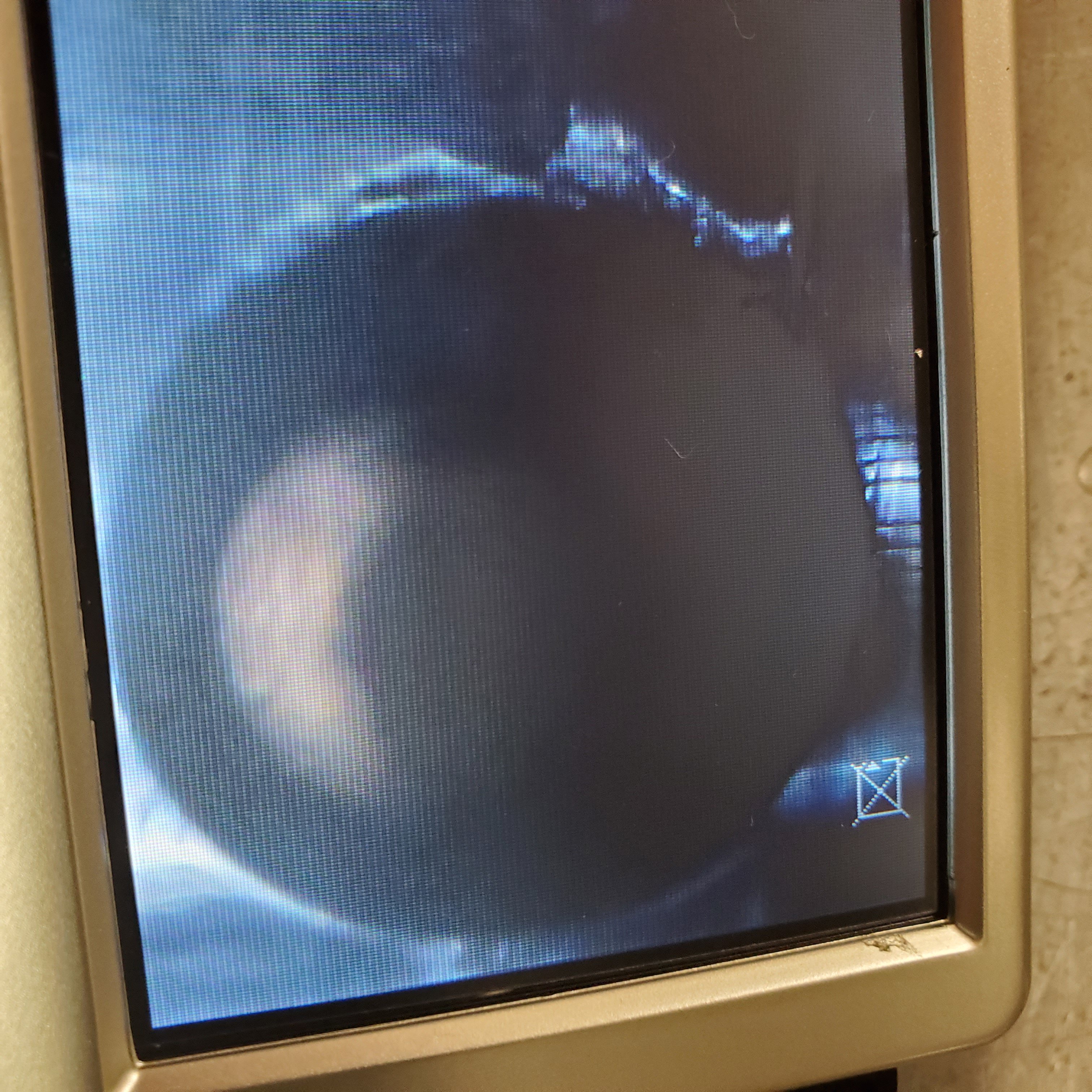

Check out the internal burrs on this gas port, here's a bad one. But ya dont know if ya don't check.
Truing and centering things up helps in accuracy.
The "old guy in the yellow shirt" video, actually has more valid points to add to the conversation than Brownells.
An actual test of different barrels and extensions, 10 - 3 shot groups before and after bedding the barrel extension with 620 over 5 rifles assembled showed an average of 18% increase in accuracy, better than metal shims alone. Then selecting an extension with slight interference fit that's hard to pull out and still adding 620 loctite gave the best result of 35% reduction in group size in this small study.
A total of two guys state that if you use BAT barrel extensions and torque on another BAT barrel extension that they are do precisely made that the gas port will index up close enough to use...I have not verified that, and do not plan to do so.
Whether or not you subscribe to any of these practices is up to you, and what your accuracy needs are.
For me, they work, so I'll continue to use them, until better accuracy proceedures emerge.

In terms of the best product from Loctite for retention of cylindrical parts - 620 is good, but is 660 better? It is significantly higher viscosity, and has about twice the gap filling ability as well. For those of you who have a really loose fit, it is actually designed for retaining shims too.
660 is a paste and has lower operating temp (300F vs 450F). 620 is ok in the bedding application. 660 is a urethane, 620 is an ester. Their cured strength are identical. As long as the chosen goop remains between ID and OD during fitment, then it's viscosity is good.
I can say it again, 620, JB epoxy, JB Red silicone, are all valid choices. There's pros & cons to each, use the right one, pun intended.
