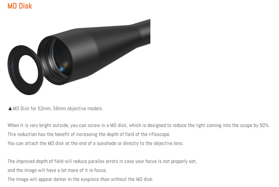

I have a question for some of you optics gurus out there...
March scopes and other companies offer these Mirage Disks that reduce the effective objective lens diameter to increase the depth of field to make mirage more easily readable.
So I'm wondering if this trend toward ever larger objective lenses is resulting in a reduction in the depth of the field ?
Would a scope of a given magnification with a 40 mm objective lens by some mathematic optical fact perhaps have a greater depth of field than a scope of the same magnification with a 56mm objective lens?
Or is depth of field affected by other factors in the way the lenses are organized within the scope.
I like to see the mirage to assess the conditions and a scope with a shallow depth of field does not appeal to me.
