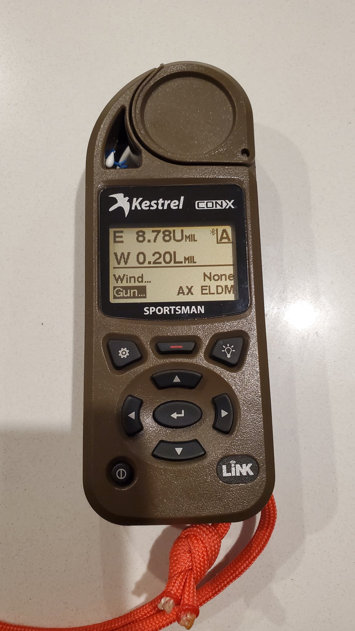

    I just bought a Kestrel with Applied Ballistics. It was telling to dial up to roughly 8.8 mils to get to 1K with zero wind. This seemed jokingly wrong...based on my experience. And, when I went to verify...sure enough...I ignored and dialed 8.1 and I was on the square at 1K.
    Before I go waste any more rounds at any other distances going of what Kestrel says, I am curious if anyone has any first-hand wonkiness with the Kestrel 140 ELD-M. Is their drag model bunk...do I need to tweak something...anything?

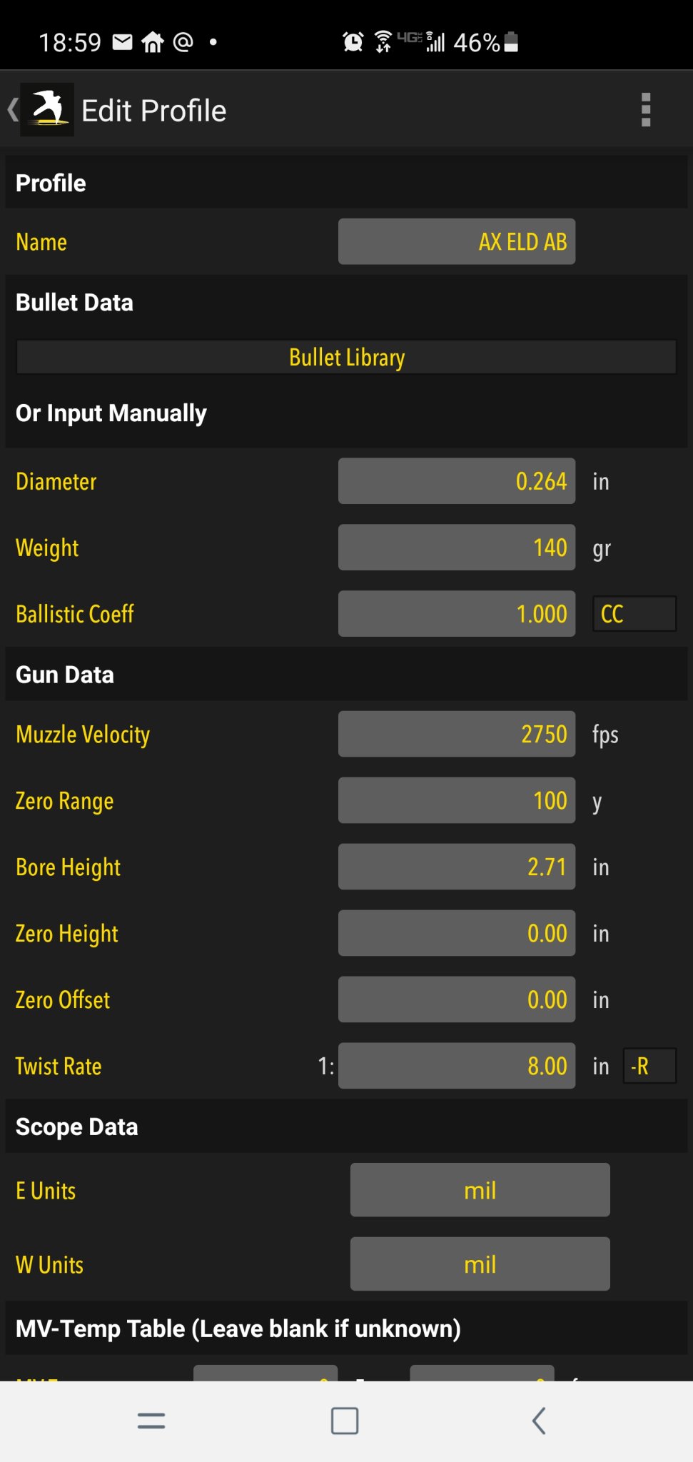

    I've played with BC...but I could not reasonably adjust up the BC higher to get the Kestrel to tell me 8.1 at 1K
    I've attached pictures of my guns profile to show what Im talking about

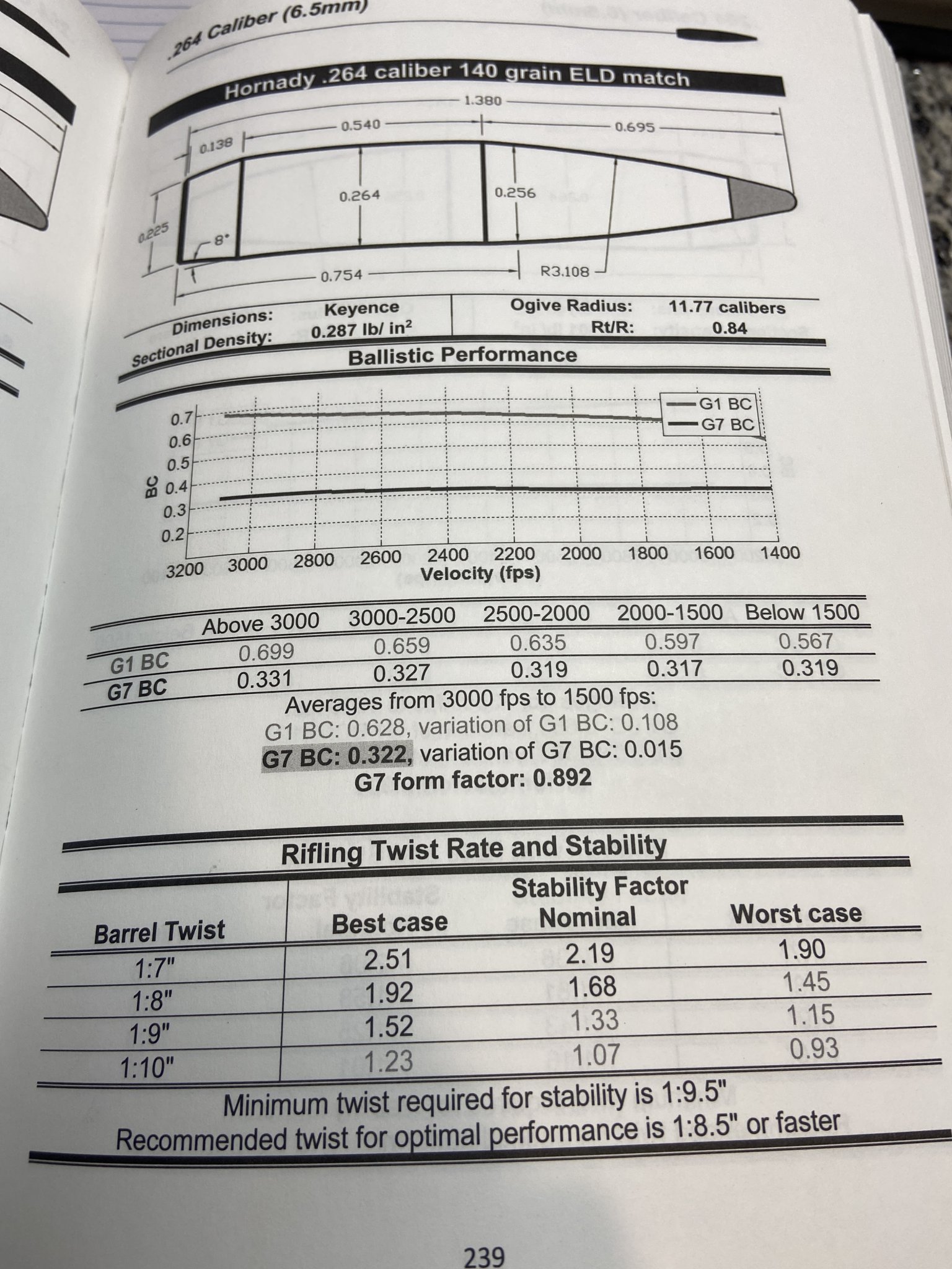

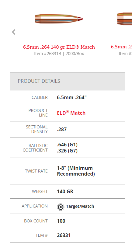

    Wow, so this is kind of embarrassing. I saw this morning than Hornady lists a G7 BC of .326 on its site for the 140gr ELDM whereas @Kestrel Ballistics / Applied Ballistics had .291.
    Not sure if this means Kestrel has verified lower and does not agree with Hornady's claim...but when I manually changed the BC in Kestrel to .326 it lined up perfectly ~8.1mils with what I verified in person.
    I did not have this issue with Berger, Kestrel was pretty darn close, but I'm wondering now if there are other bullets / brands Kestrel is just way off on.
