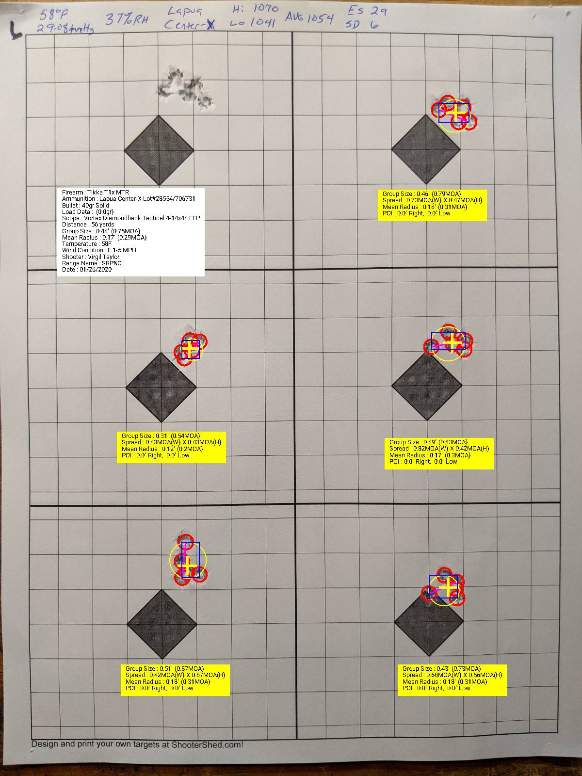

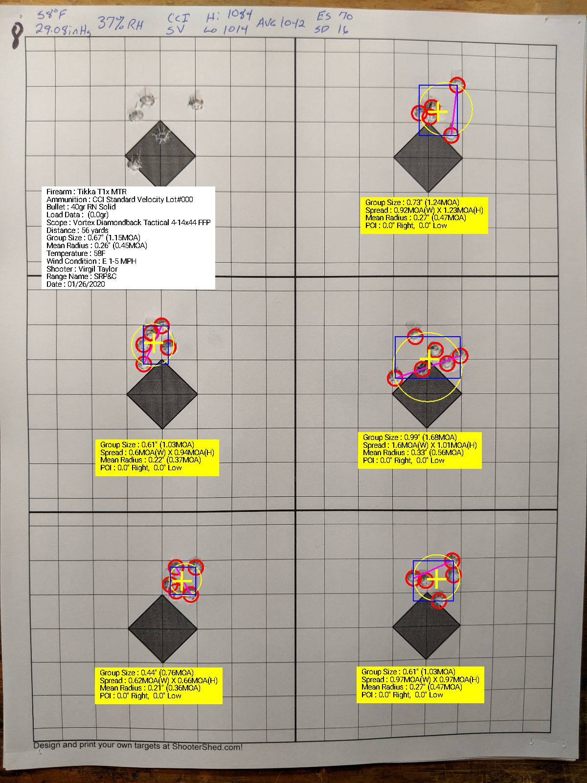

I've had similar results with CCI SV. Two or three shots will group pretty good and then the remaining might form another group or just end up scattered around. ES and SD numbers tend to run high for CCI and you can visibly see deformation of the bullets on many rounds.
CCI SV is better than other CCI varieties, but still pretty inconsistent. The higher quality (and higher priced) stuff is much more consistent.
Check out chrony numbers written across the tops of the targets. Center-X is way more consistent. SV has about 2.5X the ES and SD (scatter) of Center-X. Usually, better ammo = better groups.
(The upper-left groups on these targets are the first 5 shots after switching ammo so I count those as "foulers" and don't include them in group averages)

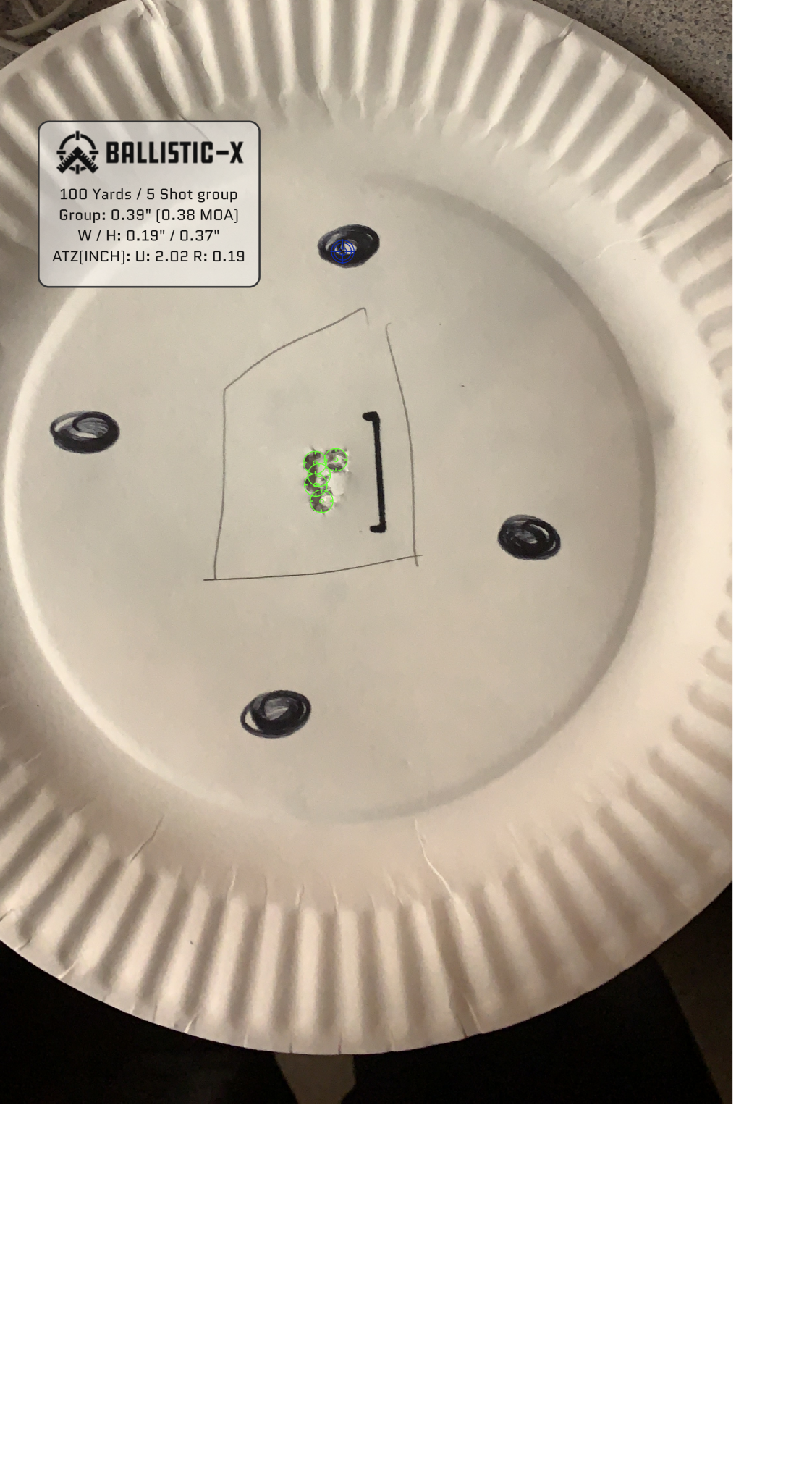

So after a few months of frustration I finally got that gun to shoot a decent group!!
Stopped by my LGS on my way home from work today and picked up a box each of the two match ammos they had..
Tried the Federal hv match. Shot the better part of the box, unable to get an inch group at 50yds..
then tried Gemtech 42g match subsonic. Was getting dark so only got to shoot two 5 round groups. (No fouling groups) First shot was low.. second shot was overlapping first, same with third and so on.. I’m attaching a pic of this one, since it’s the first 5 shots with this ammo and the best group I’ve ever had with this gun.
second group was almost as good.
The overlay in pic says 100yds, I can’t change that so the MOA is half what it really is.. measurements are on though.
Anyway, thanks for all the great advice!! Still looking at the Tikka ?, but couldn’t be happier to finally figure out what’s been going on.
