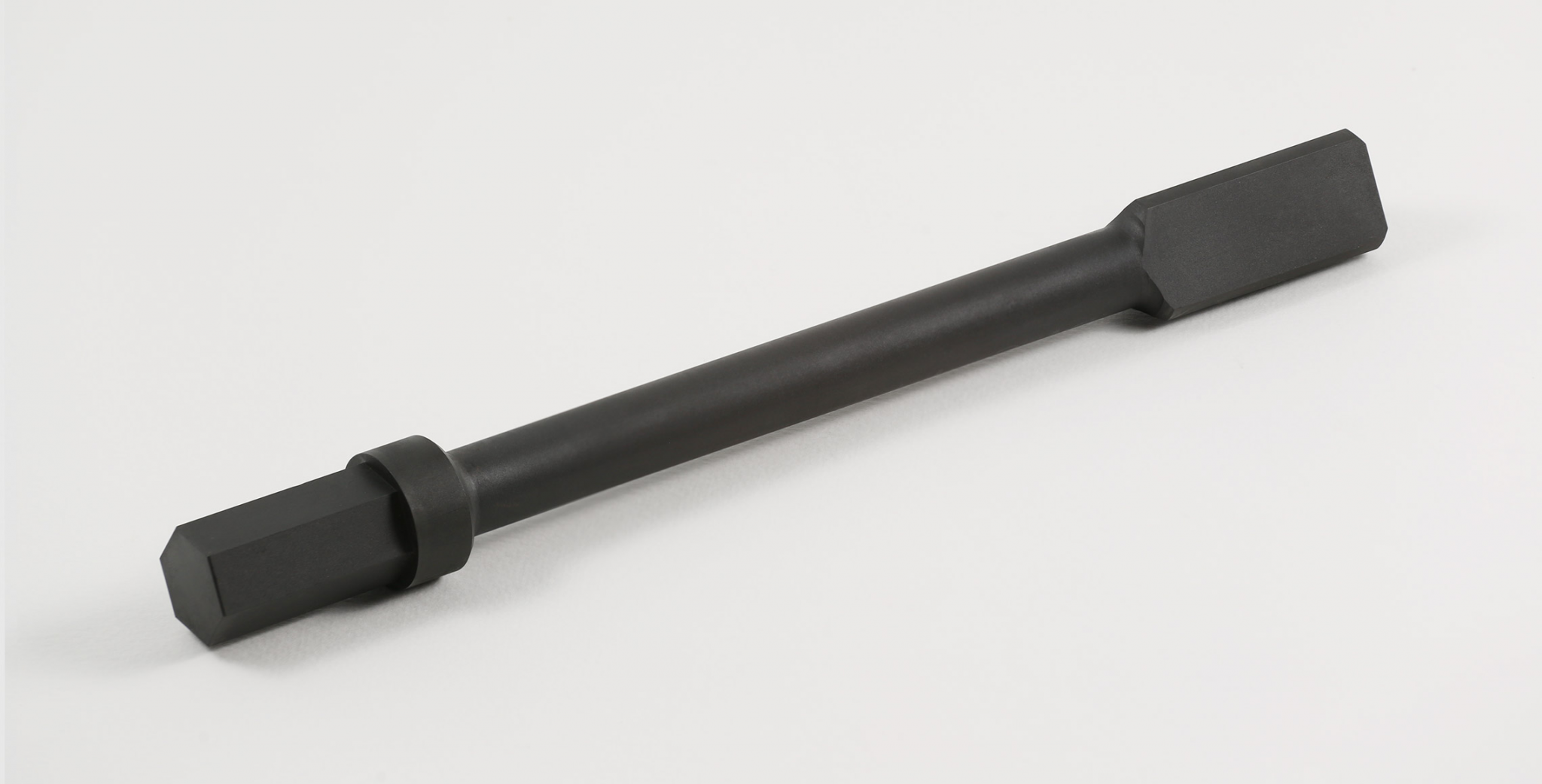

Which Brownells external action wrench did you use? They have a bunch of them but none seem to be specific to TRG. Did you use the "universal" model?
Universal fm memory. As per Wade it must be external. I did try Wade’s method but I mustn’t have been holding my tongue right as I couldn’t crack it. Thus the heat to soften/ thin the goo and gentle pressure on the cheater. Clearly YMMV.
Reactions: lash and wade2big
"The TRG Action Wrench facilitates barrel removal for the Sako TRG-22/42 rifles. Now you can turn your TRG into a 'Switch-barrel' rifle with this wrench and a barrel vise. Gunsmiths can use this for barrel replacements and to avoid fabricating their own wrench. This is the first and only action wrench available for TRG rifles. It is intended to be used by those qualified to remove and install rifle barrels.
"The TRG Action Wrench is a solid piece of Stress-proof steel, cut into the same triangular shape as the TRG bolt. Our wrench acts on the raceways of the action to minimize any torsional stress induced during barrel removal. Cut into one end of the wrench is an interface for a six sided ¾” or 19mm socket wrench.
"NOTE: TRG barrels are screwed on extremely tight. A barrel vise with more clamping surface/force than the common Wheeler vise may be necessary for initial barrel removal along with heat applied the joint. After initial removal, simply dial down the torque a bit when installing the new barrel if you desire a switch barrel configuration.
"USE: Remove optic, bolt, and cheekpiece from rifle. Insert action wrench in same manner as inserting bolt. Clamp barrel and use ¾” or 19mm socket to turn action.
"Material/Finish: Stress-proof steel with Mil-spec Manganese Phosphate finish
"Made by KRG.
"USD 139.99"

Wrt the KRG internal wrench, which I have and use... The Sako/ Tikka barrels are on real tight fm factory. I’m not going to chance gouging up the bolt raceways and buggering my rifle breaking free that F’n tight factory barrel. Factory barrels gets the external wrench treatment so if I burr up the outside it’s not a tragedy.
Everything after can be torqued with the KRG wrench = TRG/ Sotic 3 lug actions. Maybe I’m being overly cautious… But that simply works for me…
